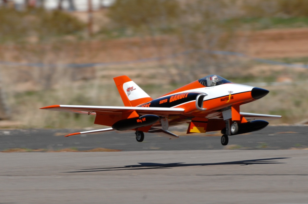

Couple of short final landing sequence stills of my classic bandit....seems pretty level on short final.....and fairly nose up in the flair until touchdown. Speedbrake is non operational due to smoked servo and I was to lazy to fix it. Speedbrake does make Bandit easier to land in my opinion. I do not use any crow on mine. Lots of ''Bandit'' experience in this thread...Diaz, Avilla,Raf,Redman....Ditto to what those guys are saying. Good Luck. Dan I hope you are going to be at Tucson with your Bandit and your T-28!!!!
Nice sequence of photos. Wish all my approaches were that good. I now have a few thing to try from the pros..
Roger
