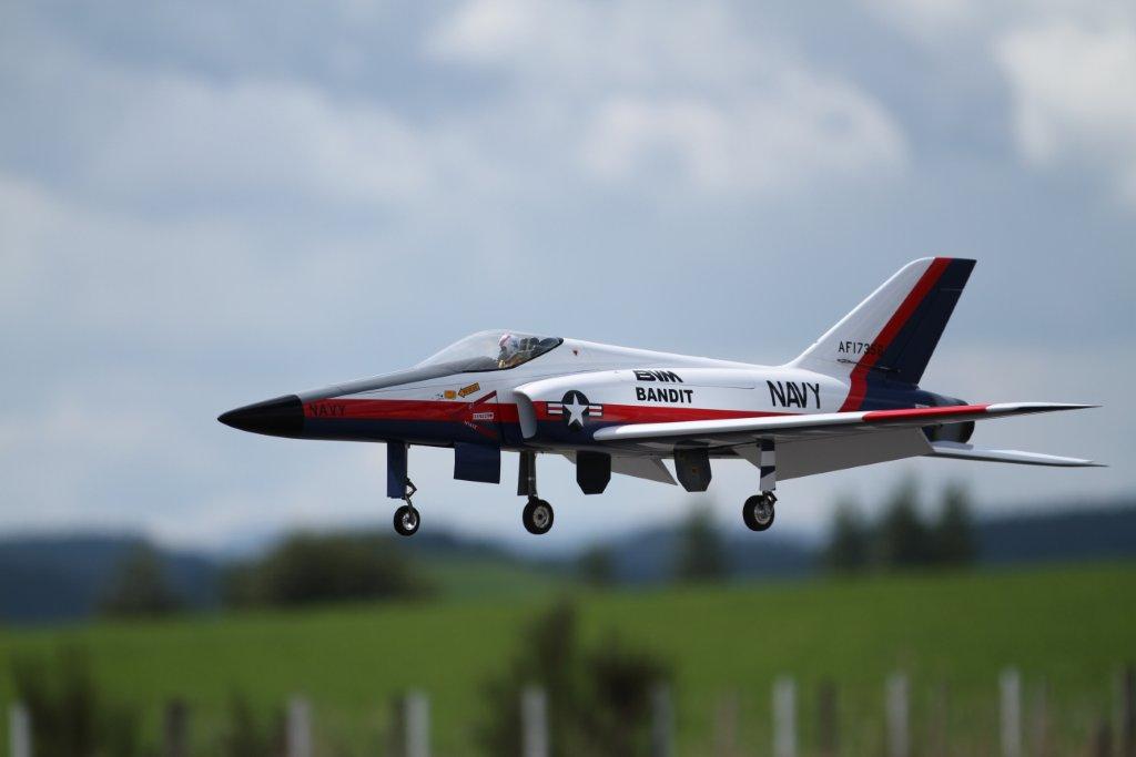

The Bandit does have very big flaps which when extended, to me at least, it does give it a slight "nose down" attitude when on finals. Weather that is real or imagined I am not sure. I'll try to take more notice next time, and use your tip at looking at the under surface of the wing..
Edit
I just found a pic of my Classic on finals. (It is much easier to land and I don't have have the same ballooning issues with this model. It is of course much lighter).. This photo is on finals at about 15' altitude and it seems to be sitting pretty much level.
