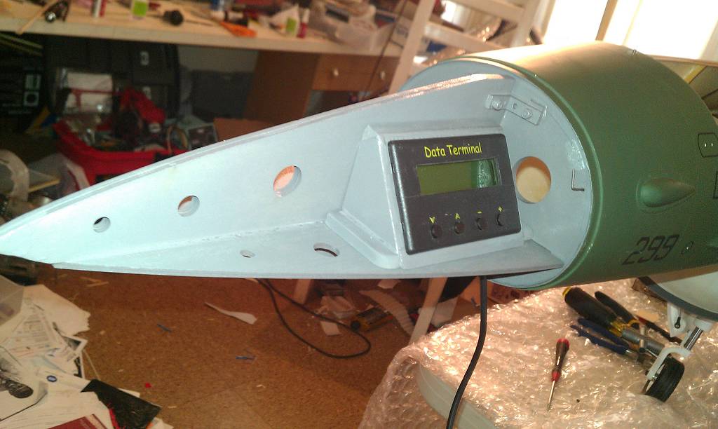

I was informed by a good source that on board Turbine data terminals can cause radio issues.
I'm looking for more information on this.
My data terminal is in the nose of my F16 and the RX is under the aft part of the canopy.
Anyone have experience with this??

Old 03-09-2012 | 08:37 AM
Flynstuff's Avatar
My Feedback: (29)
Joined: Oct 2010
Posts: 496
From: USA
Default RE: On board Data Terminal
Pic
Old 03-09-2012 | 08:46 AM
rhklenke's Avatar
My Feedback: (24)
Joined: Jun 2002
Posts: 6,005
Received 34 Likes on 21 Posts
From: Richmond, VA
I would not be too concerned about interference problems with that, but I do wonder if having the data terminal connected like that can cause problems with the ECU should the connection get "flaky" or if the data terminal software crashed.
The system we developed was for a Jetcat ECU and we designed it so that it just sent a single message to request turbine run data, so there was no way that it could accidentally send messages that are used to "control" the turbine over the throttle signal its getting from the RX (as the normal Jetcat data terminal can do). That's a low probability scenario, but I'm not familiar enough with the Jet Central ECU/data terminal setup to say...

Old 03-09-2012 | 09:08 PM
Joined: Mar 2006
Posts: 1,228
From: Littleton, CO
They reduce range. Simple test: Plug it in, and perform a range check. Measure your distance. Then unplug it and do a range check. Measure your distance. Almost double the range when it is NOT plugged in. Hazard. Don't do it Jeff!
Shaz
I will probly just remove it at this point. Dont want to take any chances.
Thanks for all the info guys.

Old 03-10-2012 | 07:57 AM
Joined: Mar 2006
Posts: 1,228
From: Littleton, CO
ORIGINAL: rhklenke
ORIGINAL: sskianpour
Shaz
Really, even with 2.4? Is that with Spektrum or Futaba? I'm wondering if its noise somehow being coupled into the satellite RX connections?
Bob
Bob I swear it's true. Range checking my F22 last year I couldn't figure out why she kept losing signal after only 20-25 paces. Chatting with a rep same day as I was adjusting turbine deceleration settings to compensate for our higher altitude. I mentioned it off-hand that it didnt matter since my range check wasn't looking good. He asked if my HDT (identical to Jeff's unit - the Xicoy ones) was on board. I said yes, he said "unplug it". I did, it gave me 90 paces on the range check immediately. My radio at the time was a JR 12X. I now fly Futaba 12Z. Only reason I had left HDT plugged in was to see what readout it would say as soon as turbine flamed out when i went out of range. Anyways, interesting experiment, never to happen again. Enough reasons somethingcan go wrong let lone have a user-induced lock-out on board...
Shaz
