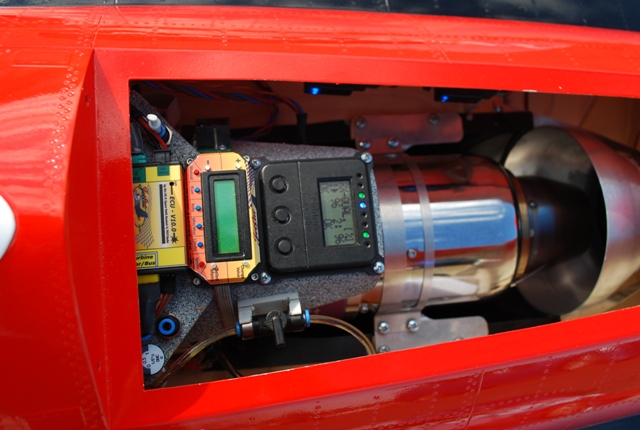

Soon Iwill be posting a build sequence for a new Skymaster F9F
in the GMGRU-1 scheme (Guided Missile Group one)
This is a build for a customer and will include the following components:
Wren 160 Kpro turbine
Futaba brushless servos and radio
Duralite Powerbox champion w 2, 5200MAH Rx batteries
Jet-Tronics air valves and sequencer
Modifications currently planned are:
1. Functioning Blowdown doors (there are 2 sets in the turtledeck that open during takeoff )
2. Functioning Air Brakes (under Fuselage.. Ibelieve these aided in carrier landings!)
3. Lighting system to duplicate what they had in 1958
4. Addition of 3 HVARrockets under each wing
5. Smoke System of my own design.
Should be a HOOT

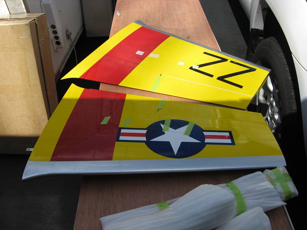

OK boxes here finally
Thanks Dustin for ther great packing job!!!

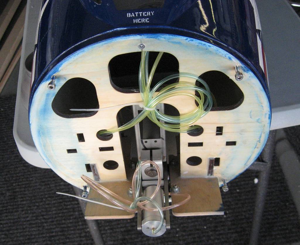

One feature Ireally like is the removeable nose
This allows for easy running gear install and achieving
CG without the requirement to add lead!!
Iwill do everything possible to avoid adding dead weight to a plane!

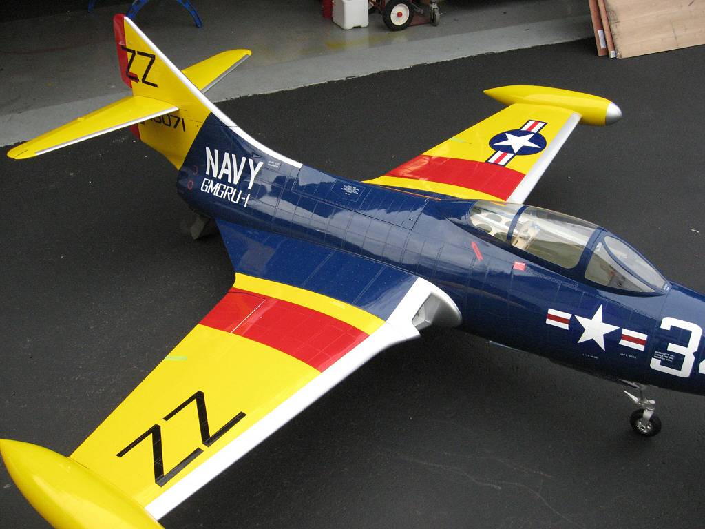

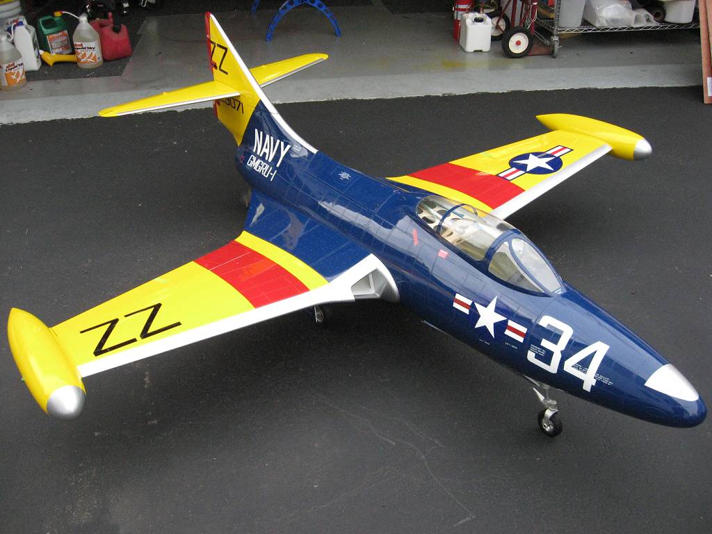

OK Itemporarily assembled the beast and set it outside WOW
this is going to look BEYONDAWSOMEin the air...
Great Job Skymaster/BVM!!!

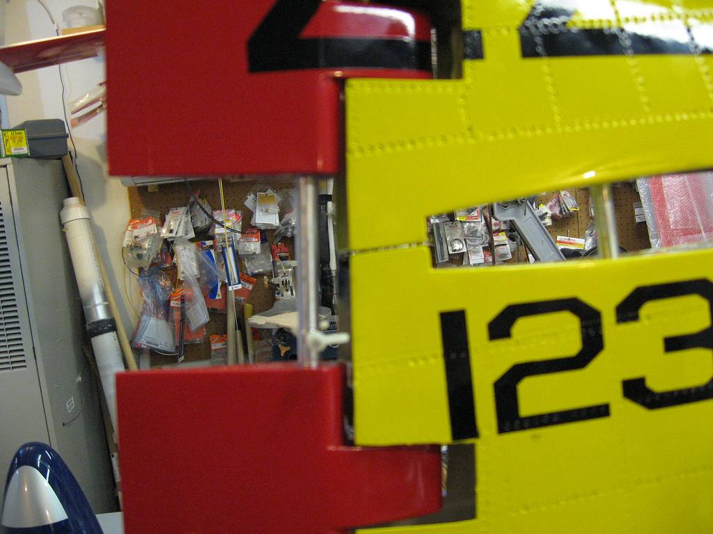

OK I'm starting with servo install
Idecided to start with the tail feathers
but Ifound that there is slop in the bores
of the phenolic rudder posts (3). The dimensions are
as follows: Supplied music wire = 1.7mm bores in the rudder
and on the fuse = 2.35mm. SO I am mulling over various ways to
control this as Idon't like slop in any hinge since under some circumstances
that can lead to flutter!
see pics
( the fit of the supplied wire in the rudder itself is perfect, no slop at all!!!)

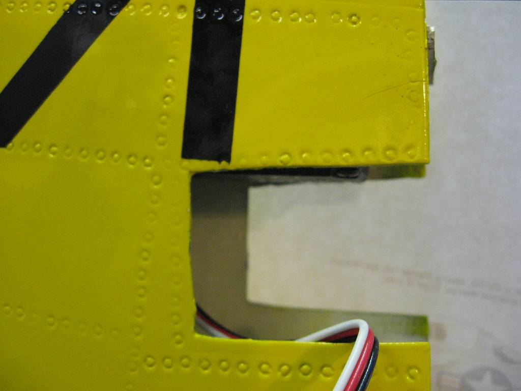

Iwill try 1 of 2 methods:
1. Try and find some sort of bushing that can be inserted in the existing bores
2. Mold new bores by coating the supplied hinge wire with light grease or silicone
then carefully inserting the wire in the bores and building up small puddles of Aeropoxy/Vpoxy
with milled glass in it to form new bores. When the epoxy cures, then Ican twist the wire and remove it
leaving perfect and quite tight bores!
more later

OK Iopted for the build up of epoxy method
when this cures Iwill rotate the wire and it will pull out!
Then trim the ends with a dremel so it will properly fit into
the milled grooves in the rudder

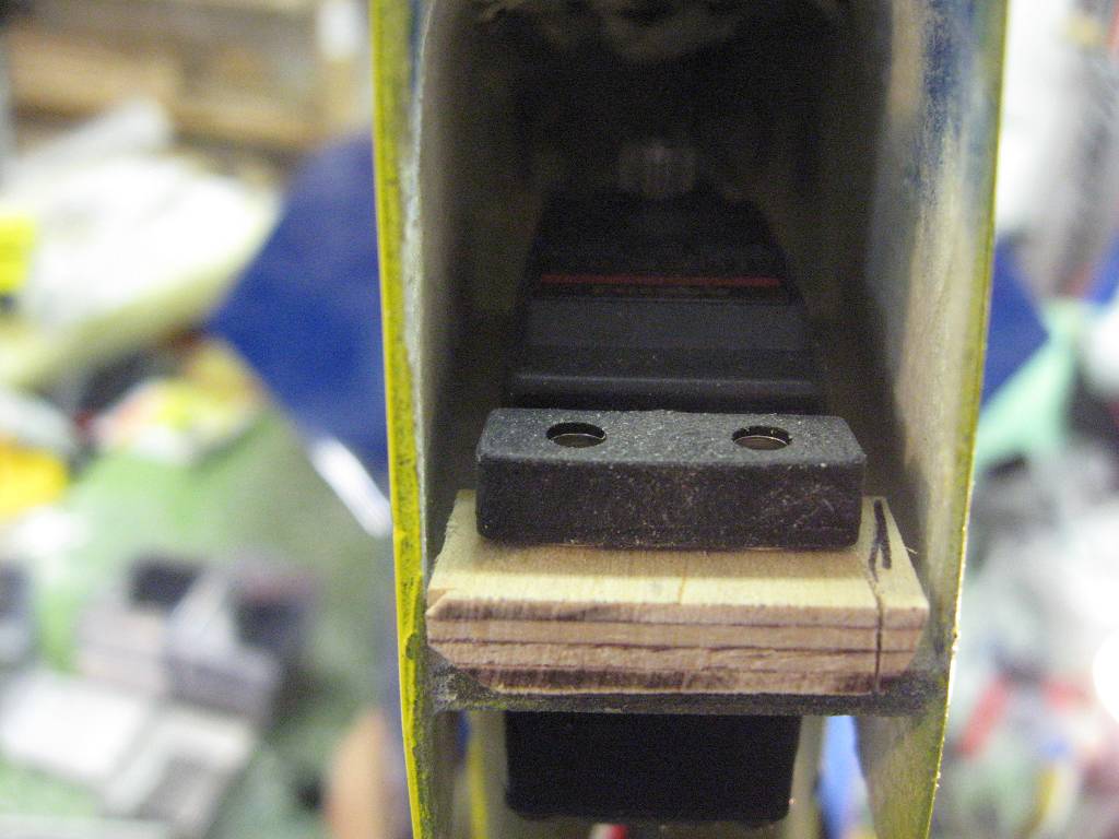

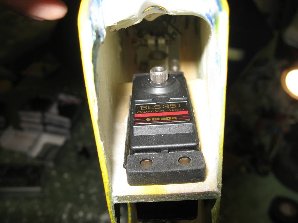

The tail structure for the Panther must besomewhat dirfferent than the Cougar!
Ihave no difficulty getting the servo in... all Ihad to dowas grind a small relief
so the servo post could slide past the upper section. However ther is a small problem
in that Iwill have to shim the servo up so the bottom of the servo will clear
the scale counterweight.. no biggie
ID:	1747742   Click image for larger version
ID:	1747743   Click image for larger version
Old 04-07-2012 | 09:50 AM
geh3's Avatar
My Feedback: (84)
Joined: Oct 2003
Posts: 1,374
From: wilmington, DE
Default RE: SKYMASTER F9F Build Thread
OKwith some shims in, the bottom of the servo will
clear the scale counterweight... nothing is ever simple!

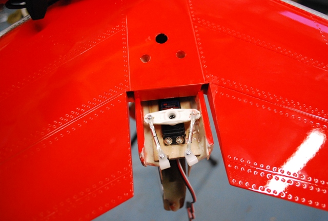

With this arrangement I am able to get <u>+</u> 40 mm of very smooth movement
and the manual calls for <u>+</u> 20mm so I am in good shape here!
