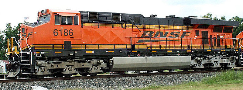

No problem Bob...
I learned to hate sanding at a young age, my first job out of High School was painting these bad boys
After a couple of years of doing that I decided to go to college for my BS degree
