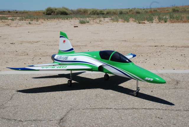

I used tinted spray on my Ultra Flash and the results were good. Dave Wilshire also did a nice job with his UF canopy using spray.

Here's how the UF came out with the paint.

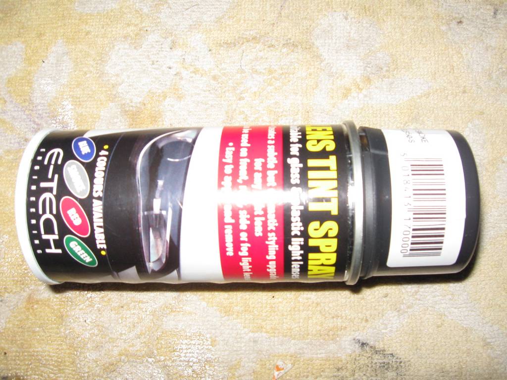

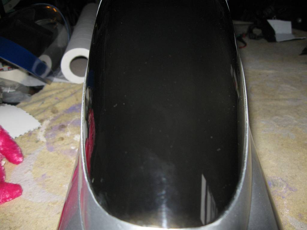

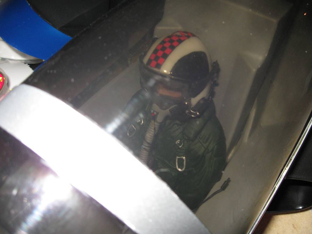

No Problems tinting a UF canopy, I used a can of smoke car lens tinting spray (other colours also available). Just follow some basic rules as with all painting, make sure the inside of the canopy is degreased and clean, anyone who has experienced blotchy finishes and tint not taking have not ensured this point.
Warm the canopy and spray can, (I suspend the canopy over an old oil filled electric radiator and lie the can on it, rotating and shaking frequently); be careful not to overheat, particularly the can so use a countdown timer on your person just in case you get distracted while waiting.
When both are nice and warm and can is well shook, (need to hear balls rattling for a good minute or so), spray away, preferably in another similarly warm area where the overspray is not going to affect you or anyone/thing else. Follow instructions on can for re-coating if a darker tint is needed but be careful as its easy to get too dark. I used a couple of coats and would not want to go any darker.
Works a charm.
Rob.

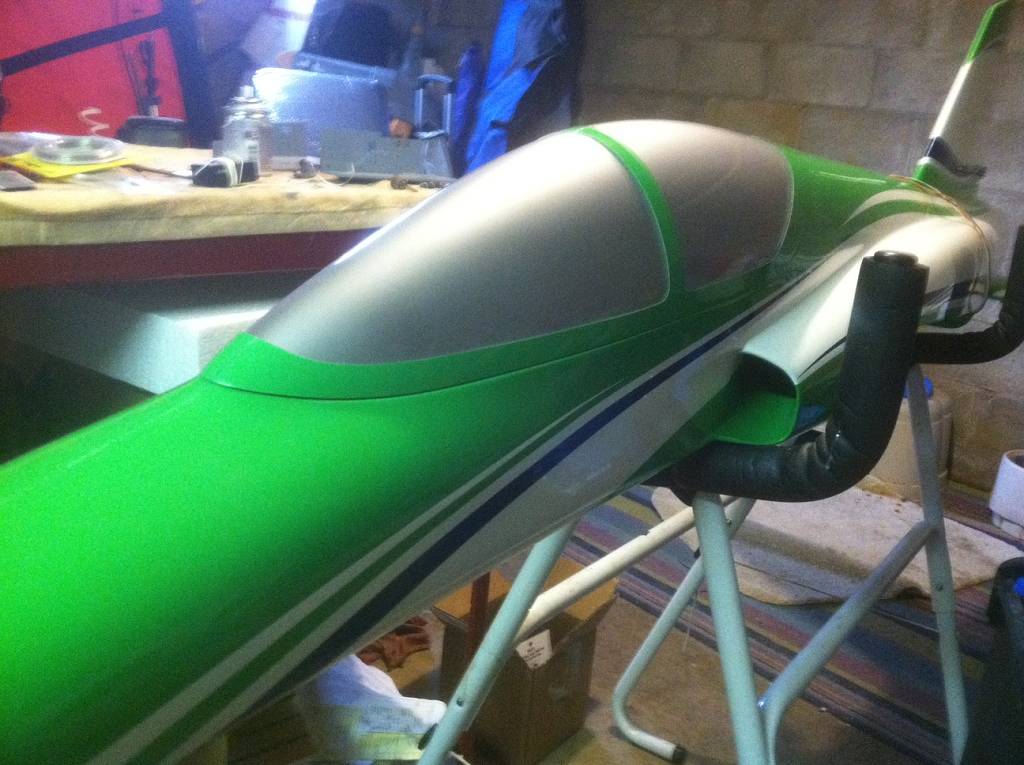

Here are two that I recently did using polycarbonate (lexan body spray). I used to scotchbrite but I don't even bother anymore - the trick is to clean thoroughly with alcohol and start by dusting a coat than follow with several more lite coats. Good luck.
Scott

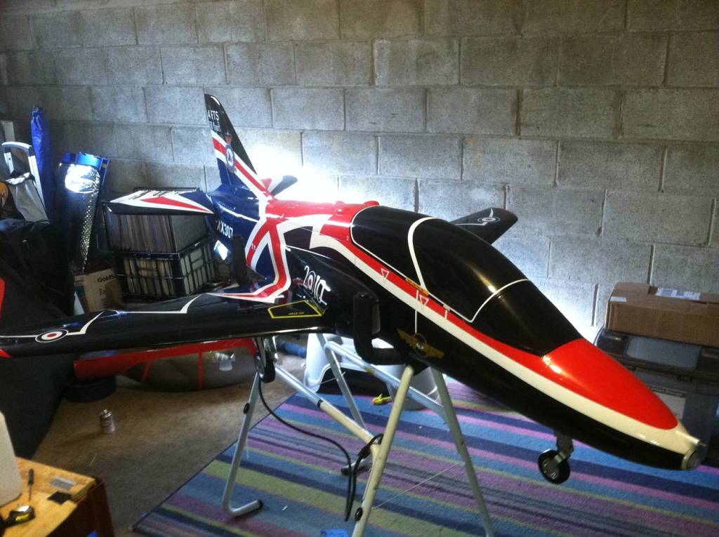

Ha ha biach. I wouldn't do it anyway. I already took care of the custom color scheme so I can skip the smeared canopy look..
Was the hawk canopy supposed to be a tint???? Looks black to me.

ORIGINAL: AFTERBURNER1
Its limo tint. Lol
