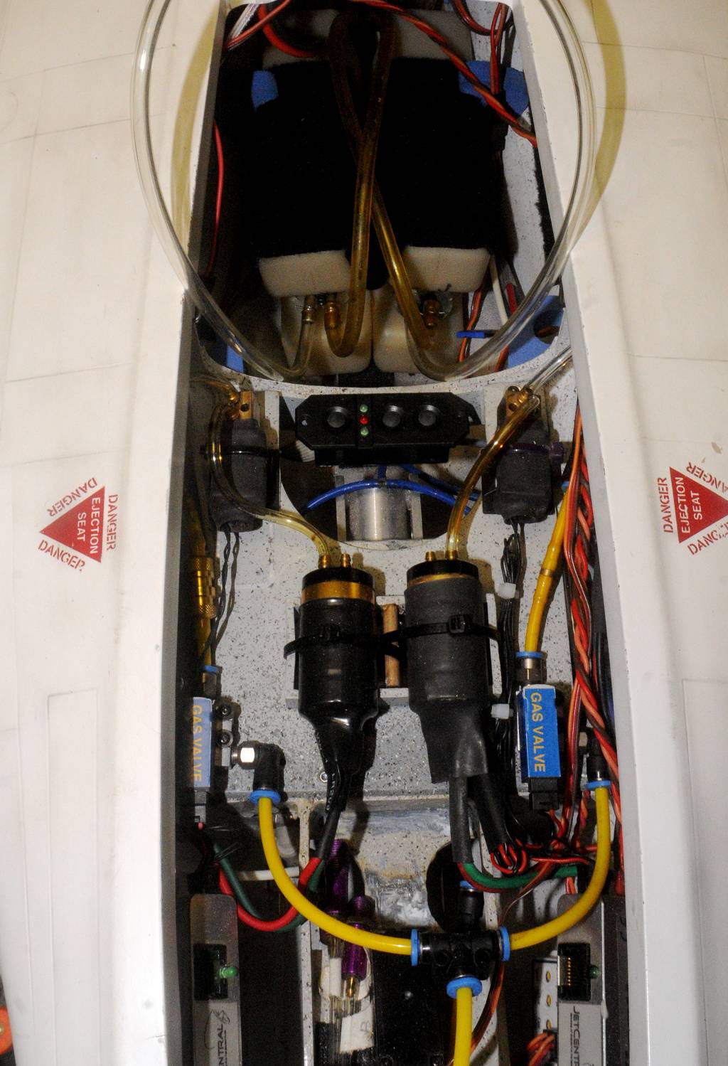

What are the keys to success for using a multi tank fuel system that does not include a UAT?
I have a new installation in an older pre-UAT jet that really doesn't have space for the UAT without replacing current fuel tank and therefore reducing total capacity.
I know there are lots of guys out there that don't use one so a little help, Please!
David S
David S

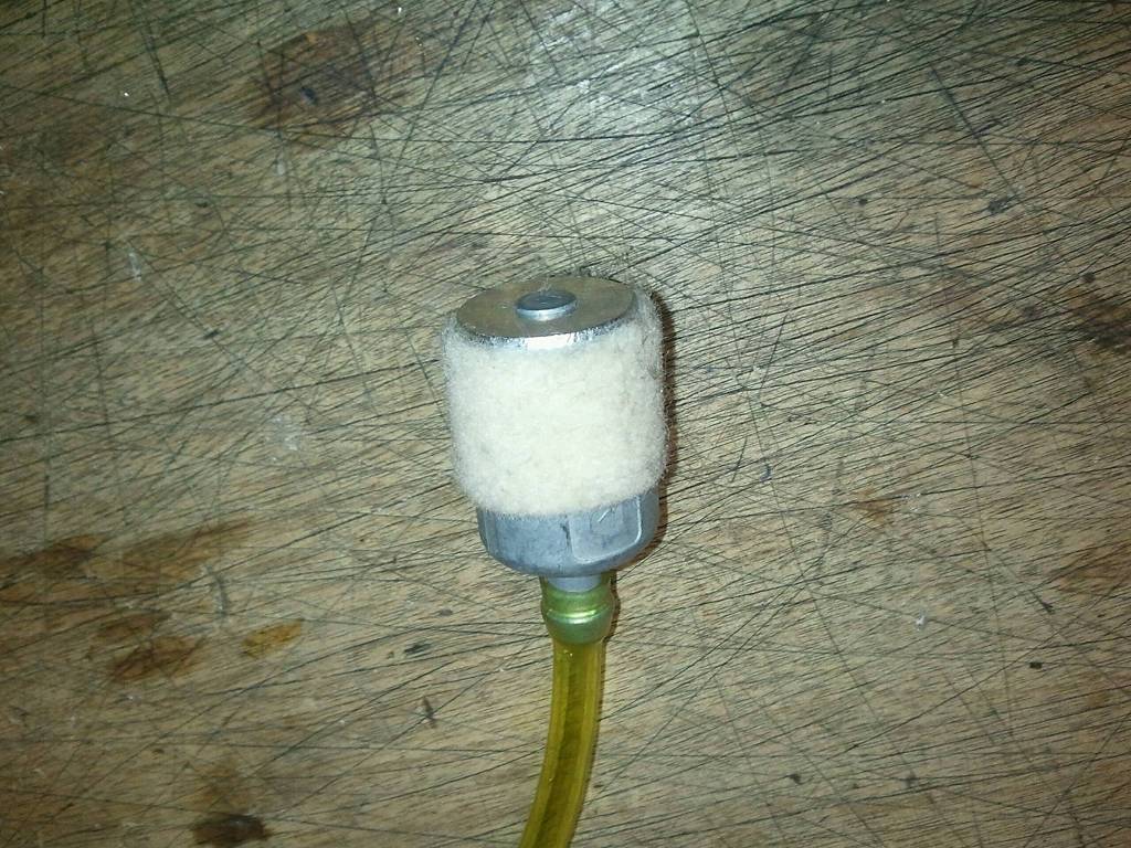

On my last 2 models I haven't used a UAT (or similar).
One uses a felt clunk in a one litre tank (Wren 44) & the other BVM Sabre
(P-60) uses a small fuel tank (2 oz I think) with the pick up tube fixed in the middle
of the tank, after the normal kevlar tank.
You could probably squeeze a similar small tank crossways in front of your 4 existing. - John.

Looking at that pic you could easily fit a small UAT such as a MAP small one in that installation. I know a few people dont use a UAT but for $45 I think the added security and peace of mind is well worth it.

David, not sure on the turbines you are using but for reference the CAT-M (which Todd stocks your side of the pond) measures 46mm in diameter by 83mm long (101mm to barb tops) and is cylindrical in shape and can be used vertical.
Looking at your picture it seems there might be room in-front of the tanks for this unit(s) to sit stood up.
marcs

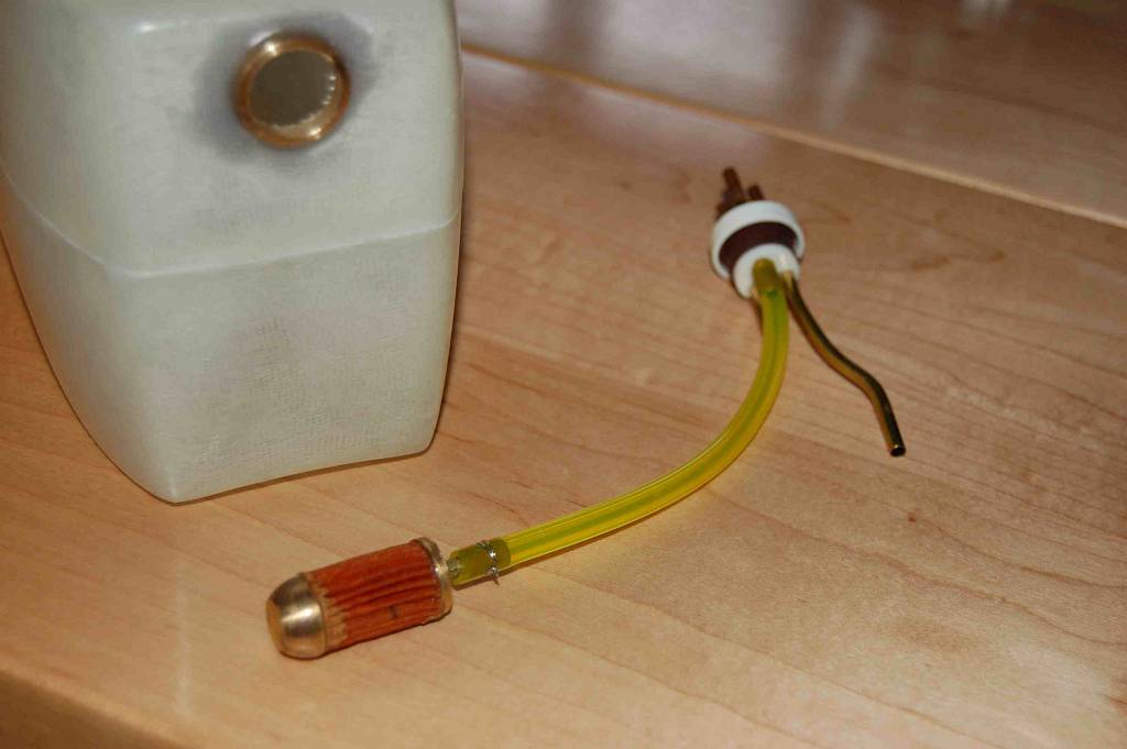

Very simple you should use a pleated paper filter pickup and make sure that it will swing from side to side without getting hung up. Locate the pump as near to the tank as you can and preferably use one or 2 tanks. The more tanks you use the better the chances of an air leak. The yellow Tygon supplied with Chinese models can very hard, don't use it. 'Proper' Tygon can be very flexible and cause problems with the heavy clunk being hung up at the front. I now use a short length of brass pipe and 2 lengths of Tygon inside the tank so this does not happen. I fit the tanks so they are propped up at the front slightly so when taxiing and flying at low speed for landing the clunk sits in the fuel. If you have more than one tank you can get away with just having a pleated paper filter in the tank the pump draws from, but I usually put pleated filters in all tanks.
In my experience header tanks are completely unnecessary and just add weight and more junctions that can leak. I tried one before going to the filter in the large tank.

I just looked out some photos of a small FEJ Rafale I fitted out originally for a Jetcat P60
As you can see it has a pleated paper filter in the tank, no UAT and a very simple installation. This was done in March 08. The engine was changed to a K80 and has flown for about 100 flights. I cannot recall there being a flameout with it.
Hope this helps
John

UAT is absolutely not neccesary. A felt clunk or similar in a centre tank or twin tanks is OK. Less flow restriction, less complexity, fewer leaks, no purge. In fact UAT's induce probably more problems than what they solve.
Andre

Thanks for all the responses! I knew I could count on you guys for good info!
This is a twin turbine installation using JetCentral Super Eagle turbines in a BVM Rafale. The two silicone tanks shown are the header tanks in front of two additional tanks per turbine. Those header tanks are Dubro 16 oz center pickup, and I have currently installed the large Walbro felt clunks for pickup. I've used a UAT on every other jet I've ever had, so, I just want to be sure that I'm on the right track for this install, if I decide to go with no UAT.
Unless I plan on doing extended negative G maneuvers, wouldn't a higher or top mounted pickup tank work just as well? Felt or pleated paper, same effectiveness? i checked Dreamworks site didn't find pleated paper pickups.
David S
