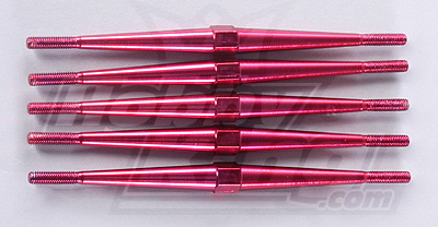

Has anyone used the adjustable control rods (sometimes called turnbuckle) on jets?
I have seen them advertised with either 4-40 or M3 threads and made of Al alloy or titanium
If so, how do you use them?
I suppose they have a left hand thread on one end, so can you get fittings for a left hand thread?

yep! thats one of the strongest setups !
I do like to run a drop of thin CA in the ball link and brake free the ball by moving it when it cures for a totally slop free move.

I strongly suspect that these are not true turnbuckles? That they have right hand thread on both ends?
If they are turnbuckles then the question remains: where to get left-hand clevices or ball links?

Thanks guys, but my question is still out there.
Do these things have a left hand thread on one end?
From out Athenian friend's post I suspect that, if they do, we must use a plastic linkage in which it will cut its own thread?
On the other end I suppose we could use a normal metal clevis (or another plastic ball-link).

It depends on the manufacturer. The hangar 9 pro links are left and right hand threads, you can also get left and right hand threaded ball links from dreamworks.
If you are asking specifically about the ones from hobby king, then you probably should send them an email asking as i dont think many, if any here use hardware from there

That's the answer I was looking for. I had no idea you could get left hand thread ball links.

As you are not tensioning anything (proper use of a turnbuckle) then two right hand threads suit our purpose better and much easier to obtain clevis/ball links etc. Should also be locked with a nut.

The advantage of the turnbuckle is that you can adjust its length without removing it from the servo arm or control horn. Easier to fine tune. Then when you get the desired length you tighten a nut on one end (usually the std thread end). If you use a rod with the same direction thread you have to remove one end at least for mechanical adjustment.
Also, if you want ultra precision your accuracy on a rod with the same thread on each end is only that you can practicaly adjust in 180 degree increments of your clevice. The rod with opposite threaded ends allows near infinite adjustment.

Alasdair, ball links are widely available with left hand threads, in plastic and various metals, but in industrial sizes rather than model size even at M3 size, however that does give you lots of strength for larger faster models. The trick is to know that they are not called ball links, but rod ends. Google for M3 rod end

Nylon ball links will thread onto the left handed thread end of these turnbuckles no problem...New threads are cut by the turnbuckle when you thread it on.

Yes, if you use the plastic ball ends like the Heli flyers do, the plastic starts out without threads, and the threads are forced into the ends when threading onto the threaded rods left or right.
