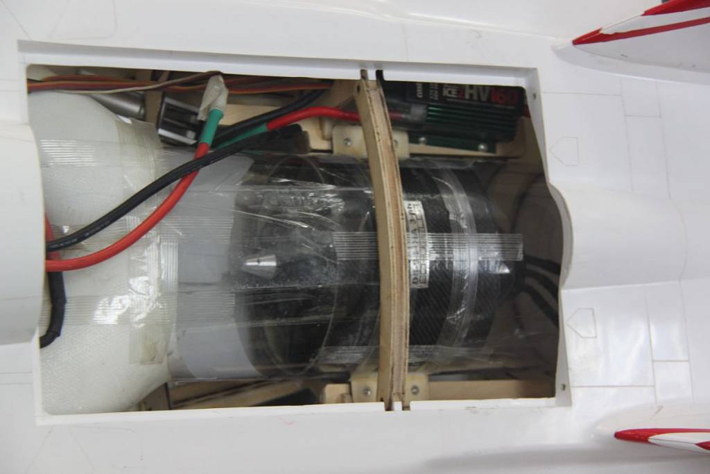

just weigh the F-18f EDF ( 6.8kg / 15lbs), included 12S 5000mah batts, this F-18f is elevons version with rudders, and without the Flaps and Ailerons, I will test fly this f-18f soon ..

Flaps and Ailerons will be an option though correct? As well as having the ability to run dual 90mm fans?

Looking at that last photo It may be tight running a twin setup. But I'm sure someone will make it happen....... Carl?

Nice job on the air frames but it looks likeSkymaster still hasn't learned how to make proper, area ruled intake ducting.
Anton, BVM is the US distributor for Skymaster, right? You should contact them to learn how to do proper intake ducting. The ducting in the photos above are very ineffecient, waste energy, and will cause reduced flight times. EDFs fly better and longer with proper intake ducting.

yes, Thank you for suggested, do not worry, i played the DF Jets over 15years from 1985" i had more experanced for the DF jets,
this not correct inlet, my workers did the simple inlet for test fly only, these worker never to know how important for intake ducting before EDF section, i had test the thrust , it is over 5kg thrust , no problem for maiden fly, and i will redesign the big diameter of inlet for fit the Danymax fan,
after test fly by EDF then we will conversion to turbine power and test fly again soon,
before deliver the F-18f to customers will change the new inlet correctly, TKS

Glad to hear you will do a proper intake for these jets. Although the F-18 flies good in the video, proper intakes will increase the flight time.

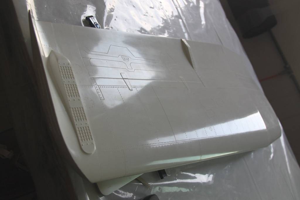

A-10s first product of wing with stab and fin are finished. only wait the fuse will finish next week, we will assemble the A-10s as soon,
