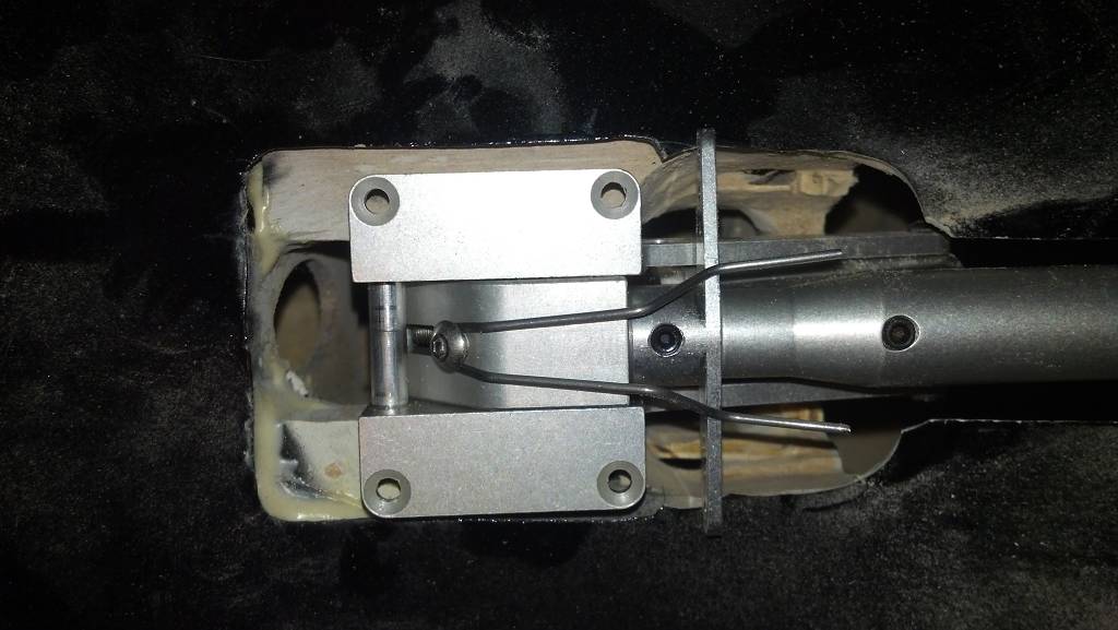

Does anybody have pictures of their nose gear installation? I have cut away most of my mounting blocks and think that I need to do a total redo.
ID:	1821924   Click image for larger version
Old 11-19-2012 | 06:13 PM
lov2flyrc's Avatar
My Feedback: (24)
Posts: 6,102
From: Daytona Beach
Default RE: Need Modellbau V3 Tornado Input
PHall
Call me tomorrow, you have the wrong tiller assembly for the nose strut. This set should have our offset tiller to clear the rail.
Todd
