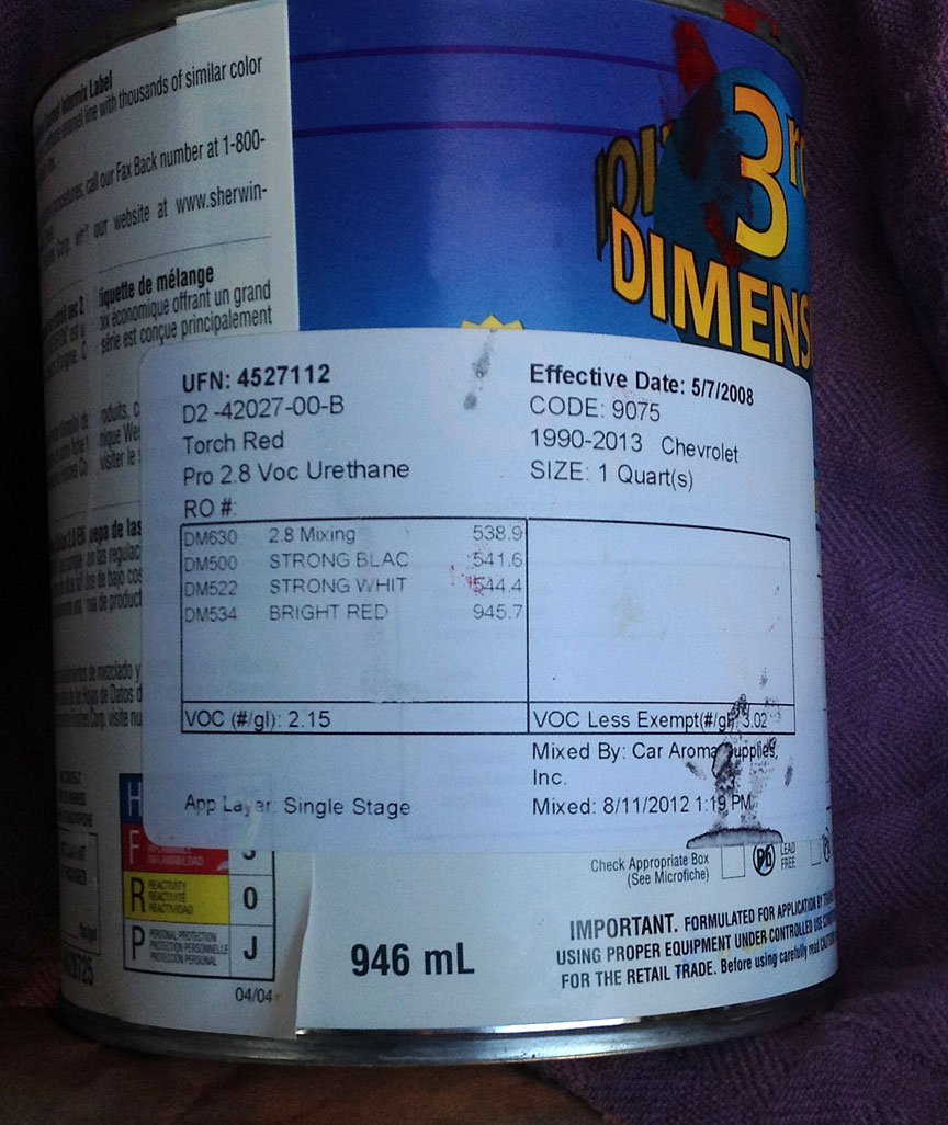

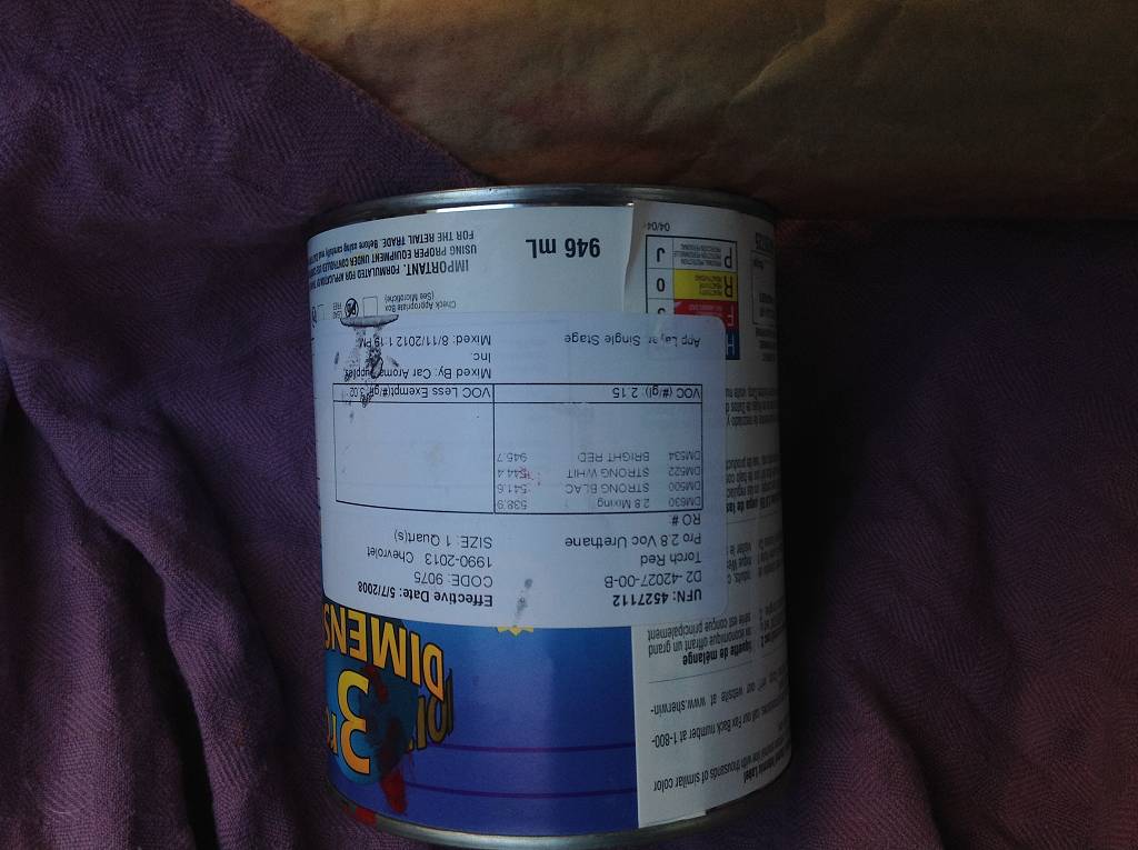

Here is the match code for the red. Dont have the white as it was a scan gun match andthey did not write the code.Scotty

Fantastic. I really appreciate you sharing that. I will finally be able to finish repainting the tail of my Flash.
