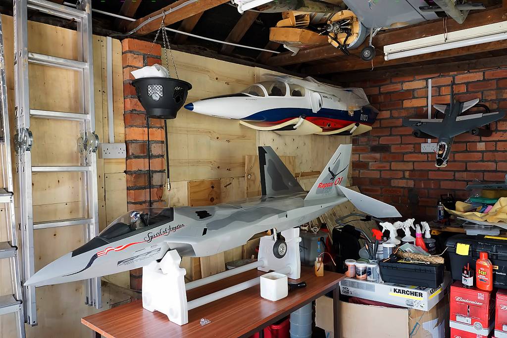

I'm starting to run out of space for storing my jets and I was wondering if there is a system available that would allow you to safely hang up your fully assembled jets from the ceiling.
My idea is to keep all of my jets assembled (or at least most of them..... ) and in that way don't loose any time in assembly/disassembly processes. I don't want to put another shelf in my container and I was thinking that hanging from the ceiling would be a good alternative..... at least for my smaller and lighter jets. Anybody doing this ?
In the picture, you can see my actual setup. It needs some more order in order to fit a large hawk, a viperjet, a A-10, another Tucano, a marchetti, a large tutor and a comp arf corsair. I'm in the process of getting rid of all the small planes in order to have some more space available.

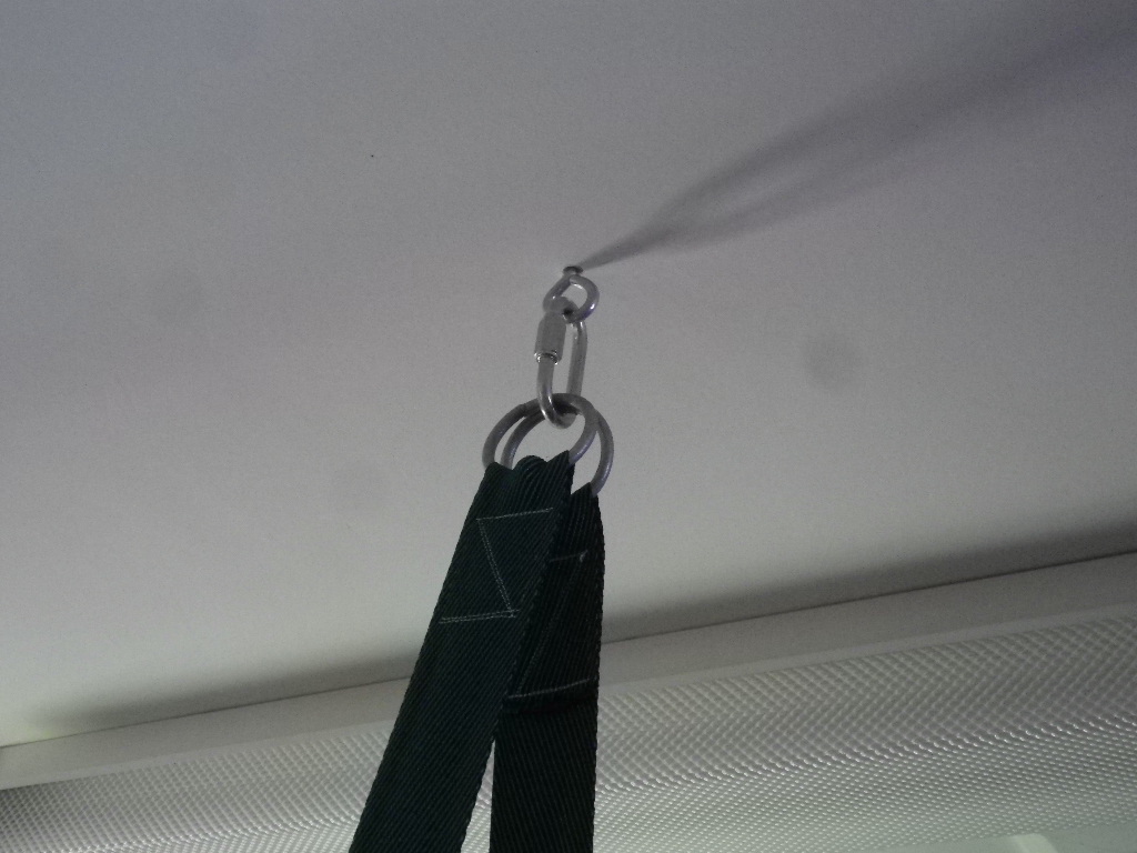

I make straps and then hang the jet from the ceiling using those climbing clips which allow you to flip open the shackle.
It does involve two people to do the job and with some ropes and simple pulley's it could be rigged to be done by one. You can get pulley's and all the bits from most good hardware stores.

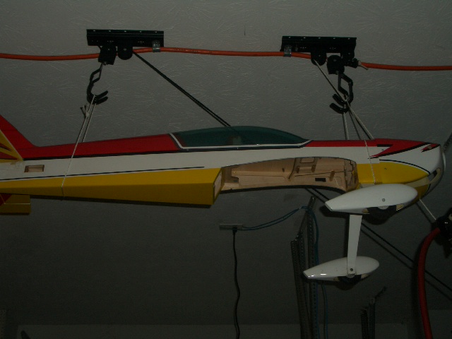

I use Romex wrapped around the fuse/wings and hooks. The reasoning behind using Romex is it does the job very cost effectively and it is stiff. The stiffness allows you to guide the wires onto the hooks while you alone support the fuse with both hands. Sheathing cut back at hook location, or on some just 1 wire around fuse/wing.
All hang inverted, (dust accumulates only on bottom) gear retracted.
Takes a bit of practice, but not that big a challenge.
Oh, and doesn't look as pretty as straps. But I have around 12 models hanging off the ceiling. Do the math first, not after.

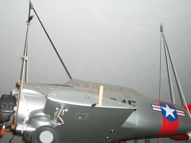

I just went to home depot and bought pulleys and rope. I wanted to be able to do it without a ladder. Kind of precarious to pull it up with two different ropes for front and back. I tried to do it other ways, balance just didn't work out. I want a bigger garage!

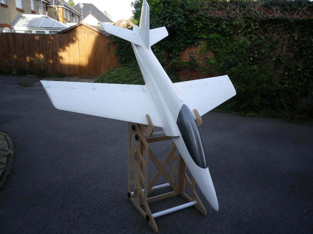

I have recently made some display stands which are for Jetpower to hold jets I am showing, the position is adjustable from nose down to almost level - in nose down they take up about half the space of a jet on its wheels...... maybe thats an option?
You could add wheels too so it cold be moved around in a workspace easily too

Let me know if you have plans of selling them.
The only problem for me could be the cost of freight.... but definitely I would prefer this type of solution.

Everything is for sale
The panels as you can see are lightened, things like threaded rod and knobs could easily be sourced at your end, as could the white plumbing pipe which acts to hide the threaded rods and provides the correct spacing so it would be just the MDF, ply or whatever other material you would choose.
Shipping to Chile could be a problem, not sure of the weight of one unit (just wood) but you would need a box 1100mm long x 600mm wide by say 150mm deep to fit three stands........

I use the bicycle hangers from Harbor Freight. Work nicely and are priced right! http://www.harborfreight.com/bicycle-lift-95803.html
You can also just use regular pulleys and rope; just make sure you buy quality pulleys so they roll smoothly. I will upload some pictures when RCU will cooperate
