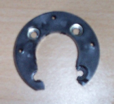

And does anyone know what this is for?????? I bought my RK-740 2nd hand, and without many of the bits it needs (now on order)
Where does the thing below go???????

is it an engine mount you screw onto the backplate of the engine or something ?

Dave, That part you asked about is the rear engine support ring. I also have an RK-740 and the instructions. If you don't have the instructions I would be happy to scan them in for you.
Just went and looked over my parts, it looks to actually be the Tank Tube Mount Ring, but is seems to have been cut out at the botton. My ring is a full circle.

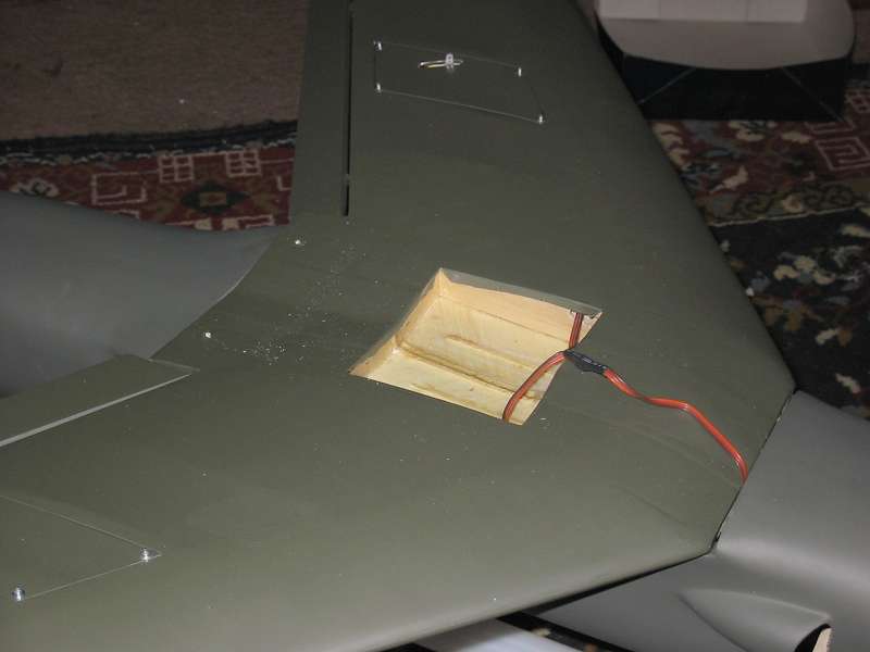

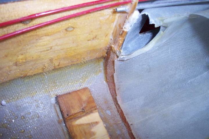

Hi all, Not getting much time to devote to my A7 at the moment.
However, have decided it's more trouble than it's worth to cut throught the wing to let the fuel tank through, so it'll will go as far back as it can and be left hanging out in the cockpit.
However, my next problem has arrisen. The outlet duct in the A7 is 3.75" and my Kress fan is 4" and i can't get one to fit in the other.
Can anyone suggest anything?

If the fan area is 4" across then shoe horn that puppy in thru the wing saddle area, with the numbers you gave your outlet to FSA is around 87.9%. That's close enough to the 90% mark your looking for, just make sure that your intake is not smaller than the FSA. Plus I would put the tank in the wing to help maintain the CG point, on such small models the CG is very sensitive, espiecally since the fuel we're putting in can weigh 25% of the models weight.

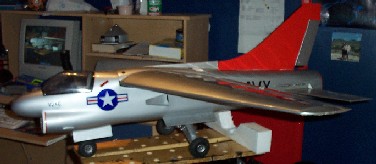

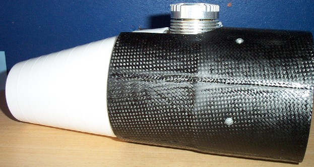

Can't move the fuel tank! no room!
I did drop all the parts into the A7 that will be in there when it's completed and in their rightful places, and the plane still balances in it's original CG location! wooooooo hooooooo!
Did buy a ducting cone. Moves 100m down to 62mm. I'll cut it so that it will be 100m down to 95mm!!!!!
Thanks for you input, much appreciated.

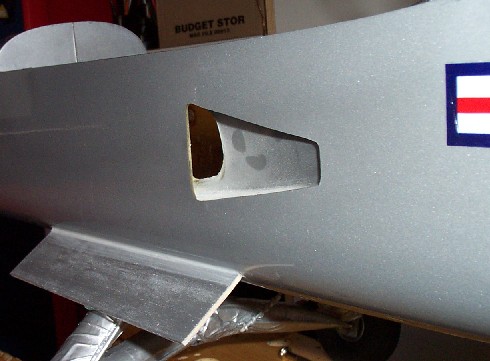

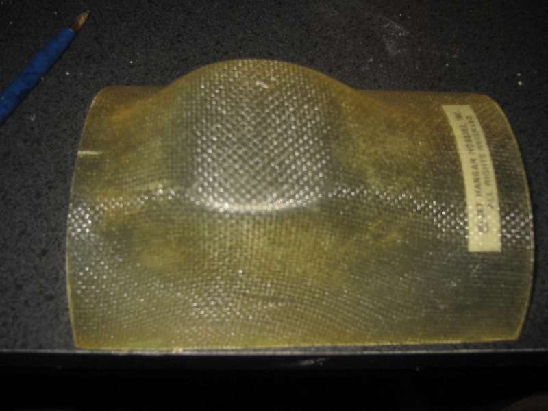

The A7 has cheater inlets on the sides of the fuz. These are restricting movement inside the plane and making things difficult.
Can any of you forsee any problem if I remove these inlets, and just have the one nose intake?
remember there is going to be no little toki fan in there but the more powerful kress rk-740!
Dave

Every little bit helps but in your case those little holes are not going to show much difference. The kress is pitched much more aggresssively than the toki and it's going to draw the air in no matter what. You'll know if you have a small inlet if the motor over-revs from the vacuum created, or worse, your engine over-heats. Just don't implode the plane, HA HA![:-] I put some pic's of my kyosho f-86 and you can see the mods to the wing to hold the tank there and I put two hs-85mg in the wing. I decided to recover the plane in olive drab with a military tan camo scheme. So the whole thing is apart for the painting process but she'll be back together in a few days. I'm still toying with the idea of mini retracts but I have to figure out where to put the servo. I'm also thinking about a kress-709 with the mvvs 15 engine. or I could diesel the O.S. 15 and use 2/3 the fuel, big weight savings.

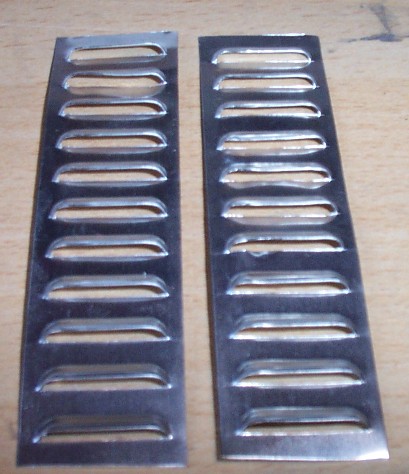

That's another problem I have. The top of the picco 45 is not in the airflow. It's half sticking up through the wing. So I've bought vents, so that when the plane's moving, air will be forced down over the engine. I can't think what else to do?

You could use the louvers or put a engine cover on the fan unit like the one I have for my turbax unit, it forces the air to go thru the cylinder head and not around it. Like I stated in other posts on baffles, air is stupid, you have to show it where to go and get it out just as fast. Here's a pic of the head shroud.

In that case you'll have to use a scoop or a louver like you have, that way the vacuum created by the exaust tube will draw air over the cylinder head, it should work fine and not present any issuses if the opening is suffecent and the duct work is right.[:-] " YOU CAN DO ANYTHING YOU WANT, IT JUST DEPENDS ON HOW MUCH OF AN ANIMAL YOU ARE! "
