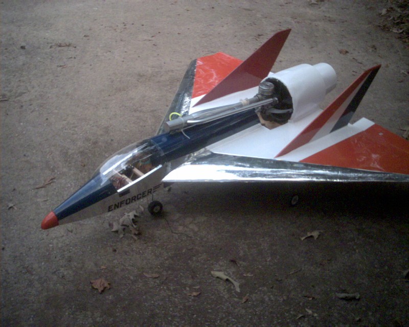

Well here is the Enforcer ready for its fist flight. If the weather holds out then this weekend I will bet ready to go.[8D]

Really looks good! Keep us posted, maybe a video too.

Nice Enforcer.
I have had three so far so I can tell you they fly great.I have a Behotec Jetstream 66 in mine and it goes verticle from lift off.
Make the C of G 20 inches forward from the trailing edge of the elevons.

Good luck with the first flight, and enjoy. Fly all sort of models, get my greatest thrill from my enforcer.

Outstanding!!
You will absolutely love it but pay attention to the CG as mentioned. If it appears overly pitch-sensitive you'll know it might need the CG moved forward; OTOH, if it tucks its nose down in a turn then it's likely nose heavy. I have a set of Enforcer foam cores I whacked out and I'm thinking real serious about building another one with a little WREN in it over the winter (which looks like it will start for us this weekend in the high country).

Looks good. You'll really like your Enforcer. I like to take mine off in less than 100 feet of runway and climb out at a 45 degree angle. Makes the other DF fliers in the club stand there with their mouths open.
