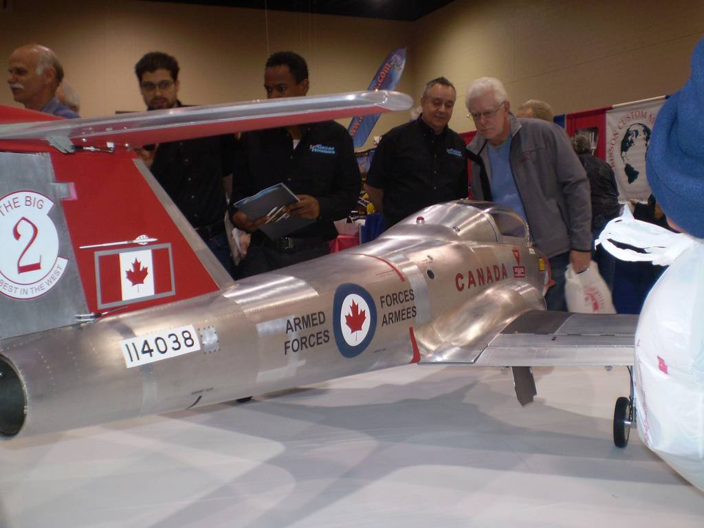

I have not experienced any issues with my Futaba 2.4 rx's in a fuse completely covered in flite metal. My F104 is that way. The antennas are inside the fuse, not external.

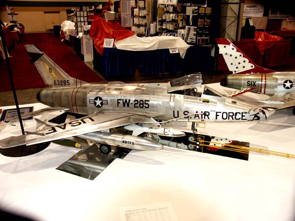

Technically there should be no problems with 2.4 and aluminum, however there are those that have reported having them. Im not using flight metal, but i do have a plan that was entirely thermal plated with aluminum. Since I am using a power-box anyway, i figured I might as well take the extra precaution for running a 2nd Futaba RX. I will run two antennas out in the tail area out bottom, and the other set inside the cockpit. Honestly, i do not expect to me seeing the power box switching receivers at all, but with a certain of time and $ into a project, and extra $150 receiver just wold not make sense not to have. In my case i was able to use 2x rx via s.bus into the powerbox SRS. With other brands, i would just use several of the remote receivers.

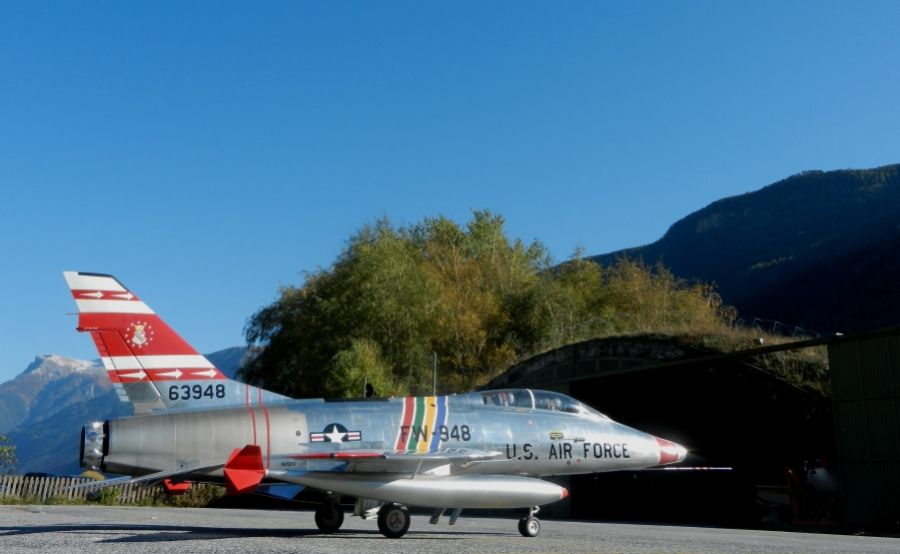

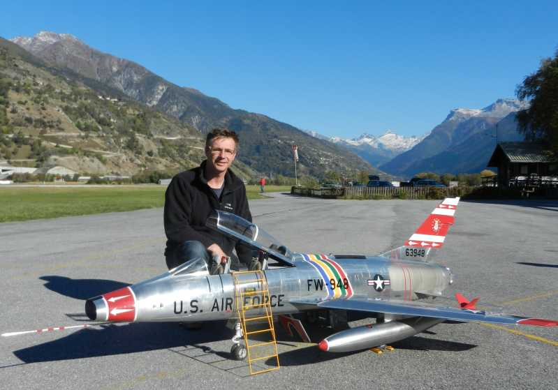

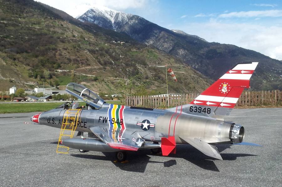

Since2011 my HUN has many sucess full flights with 2.4GhZ. Firstwith spectrum ans later with Fasst Futaba and last summer one and a halfflight with HoTT. Keep the antennas outside from the fuselage is essential.Different range tests showed that the 2.4GhZsystem with antennas inside froma Flite Metal body definitely not work.</p>
