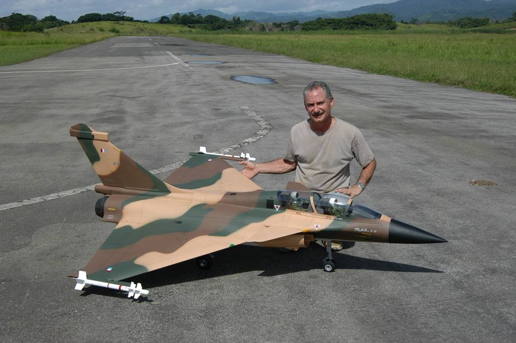

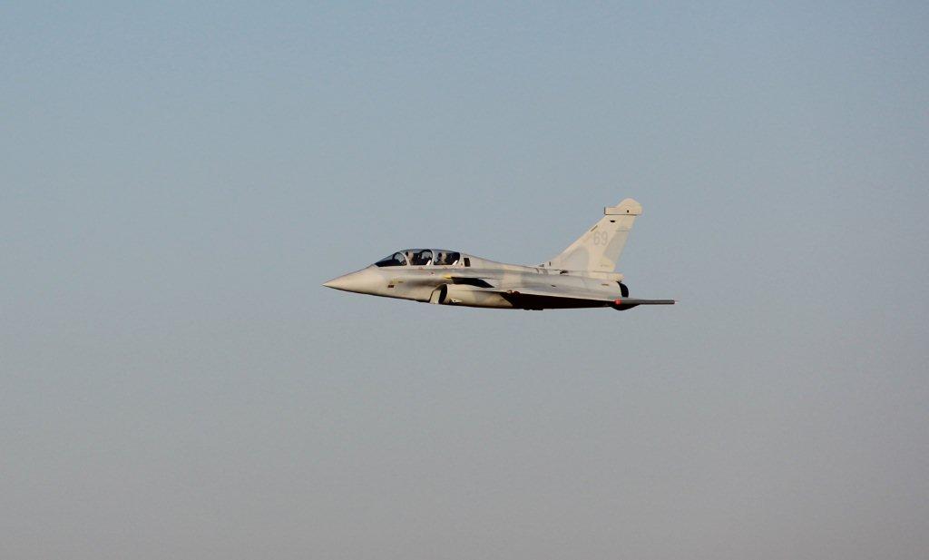

Too bad [&o]
it is a superb aircraft. We just brought one back to life with 2 cheetahs and it is just amazing.
And it was not hard to build, probably the most prefabricated pre-arf era plane

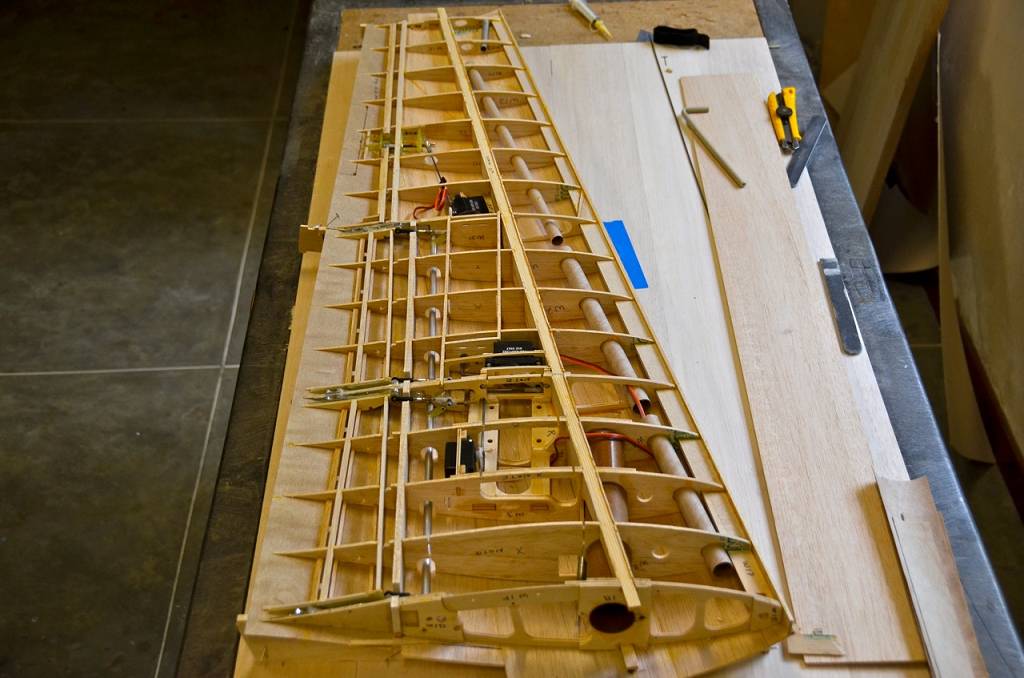

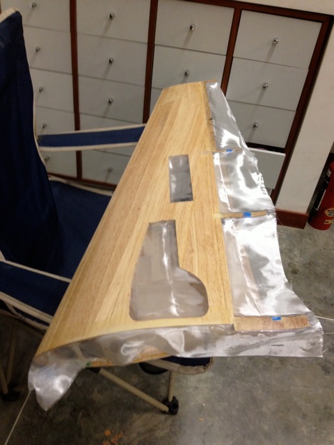

Amazing how the definition of "builders project" has changed in just a few years !!!
With the exception of finishing and painting, the BVM Rafale is not less of an ARF than an Electra.
THIS is a builders project ....

Impressive Jack. The Flaps look to be very complex.. Do you mind telling us what it is???

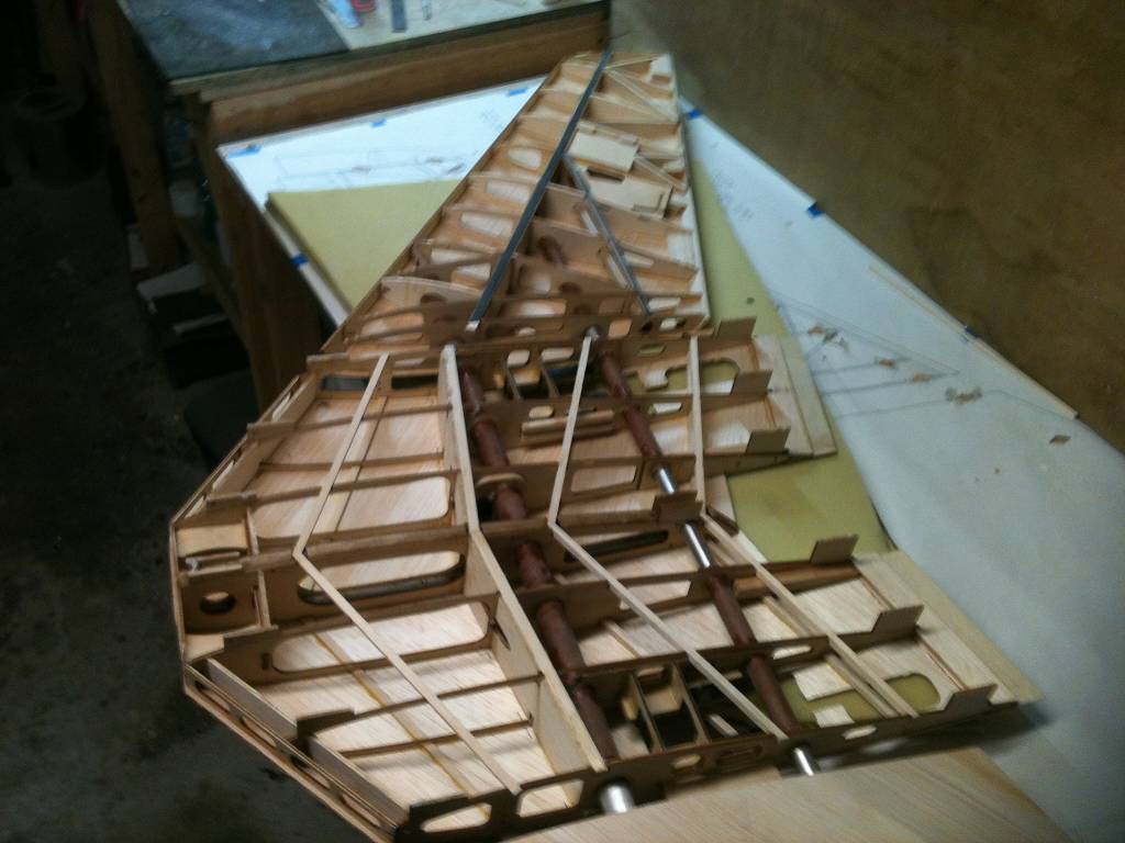

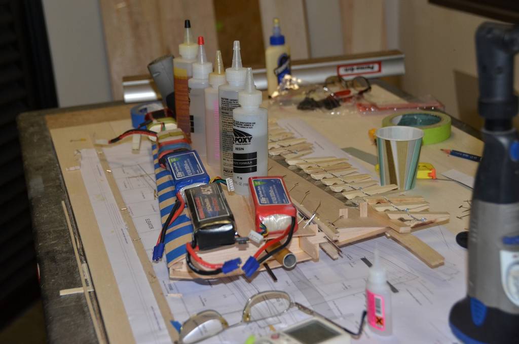

I love this style of build. This is on my bench right now. Not quite as complex but I think it still counts.
The BVM Rafael was on my list of models to do.... One day.

so nice to see real builders in this ARF world! ...Roger i think this are aluminium torque tubes so the flaps wont twist/blow back.

Hi Roger, it is a Fouga Magister from Philip Avonds.
Yes, the flaps are very complex. Each has 6 ball bearings (3 on each side) that slide on aluminum rails fixed to the wings. The torque tubes connect to the extremes of each flap to transfer the servo movement. The ailerons internal linkage is quite more complex !!

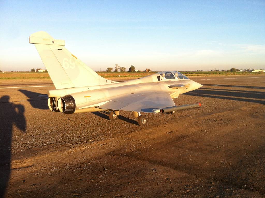

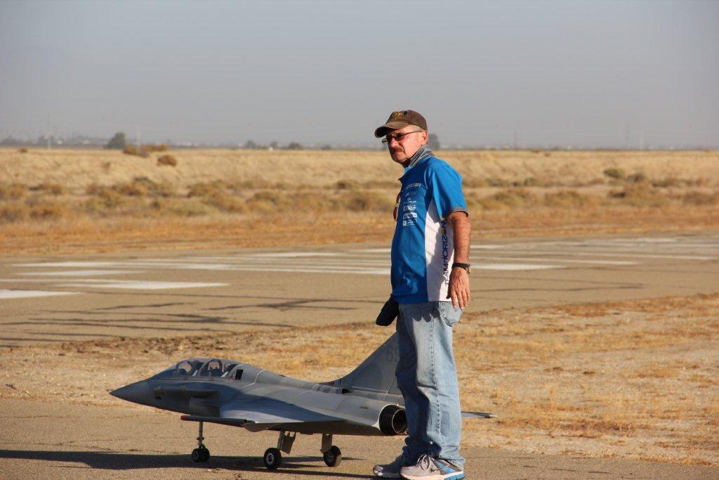

Sean, I agree with you; it it a shame that such an awesome kit is not made by BVM anymore. It was probably his most prefabricated kit ever made. An unpainted ARF in today's standards for sure. It's twin engine performance is still unmatched.
A few pictures of my Fantasy scheme one (my second Rafale):
