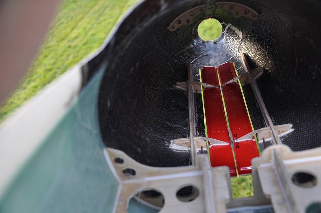

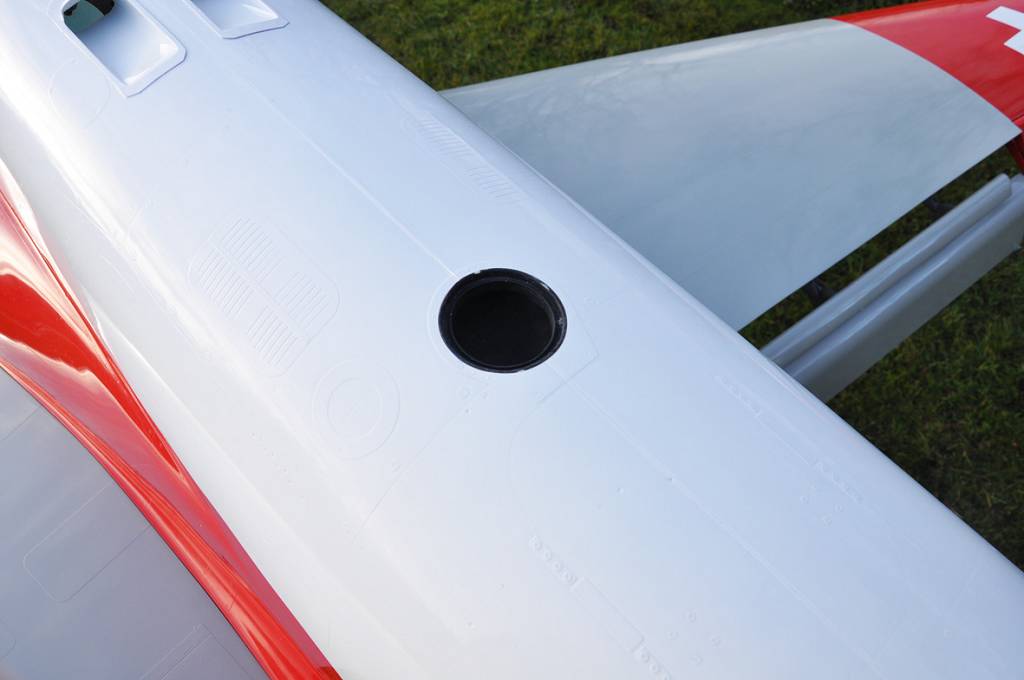

After owning the fifth scale CARF Hawk (originally scaled down from the Skygate) for a few years I always said the only way it could be better would be to have a bigger one. With all the work involved on the Boomerang side I would never have had time to build the Skygate kit version so how cool is it that CARF have finally got the ARF version available ! Of course it would be sensible as Boomerang sell CARF models to have one to try
My Hawk arrived recently and I haven't had a chance to look at it properly but today I finally had a chance to hang the kit together and boy am I impressed ! Fantastic fit and finish, all the original detail of the Skygate model and very ARF. Nose gear doors are hinged and fitted, main gear doors same thing but not fitted for ease of transport. Everything hinged (scale), control horns in the surfaces. CARF have also taken to blending the seams on the fuselage which is great. Everything looks to be usual CARF style, superbly engineered, very strong and very light. I have weighed everything going in the model and I see no reason why this shouldn't be an under 20kg dry / 25kg wet model with a 180 size turbine. Legend has it that these babies fly better with a bit of weight in them but the great thing is you can have the choice to add weight if you want whereas taking it out isn't quite so easy.
Im hoping to get on to the assembly over the next few weeks but from what I have seen so far it shouldn't take too long. Here are some pics for starters..

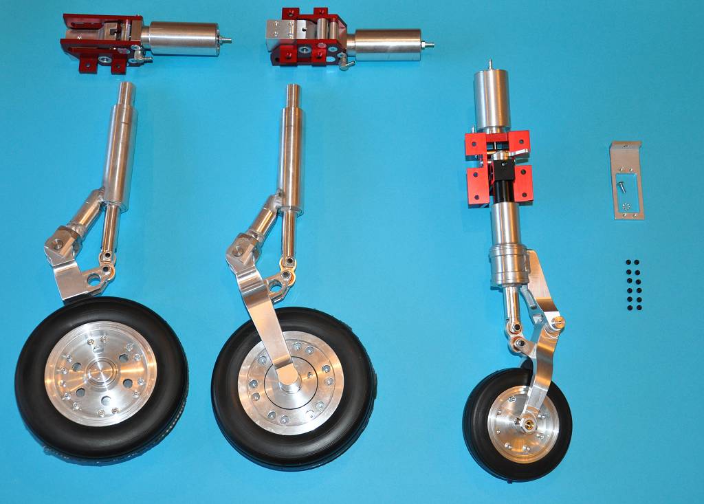

Super monster undercarriage - scale leg covers supplied for the main gear as the original Skygate kit.

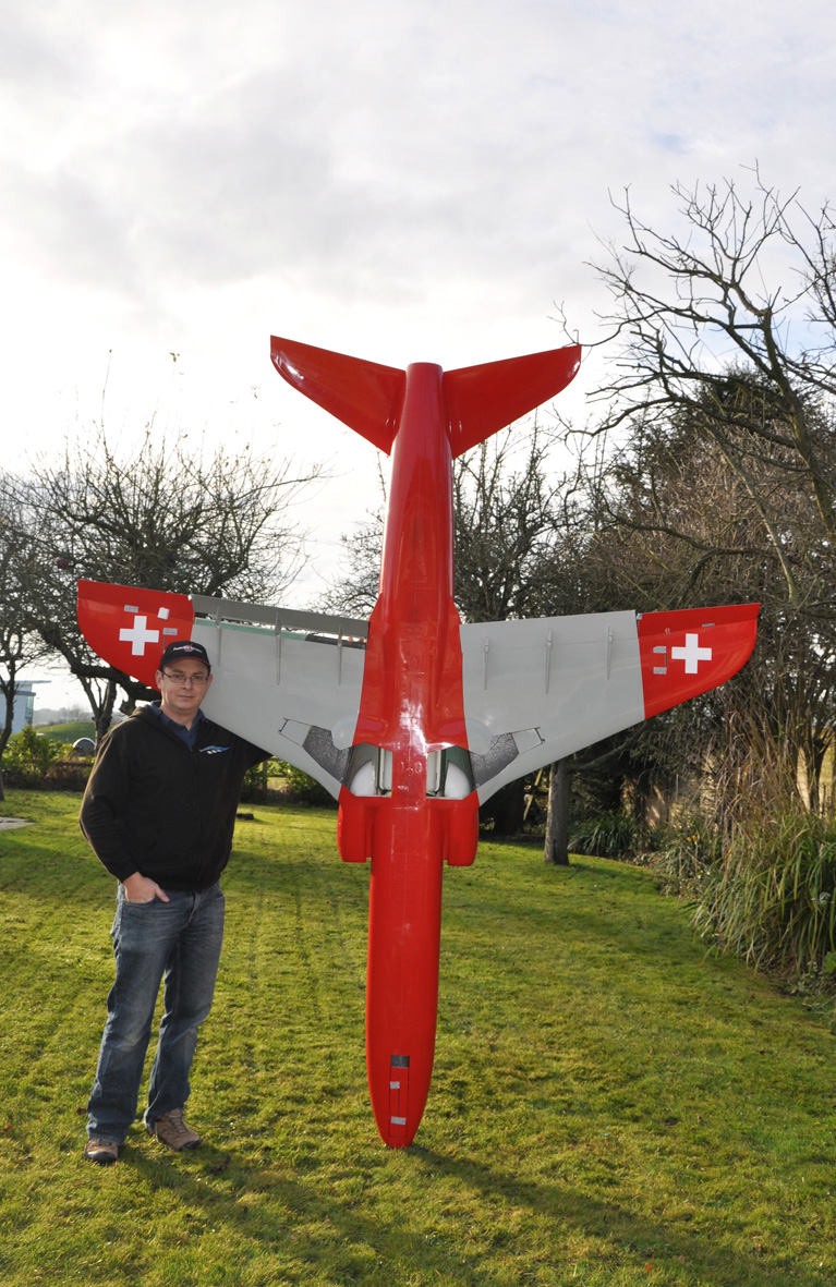

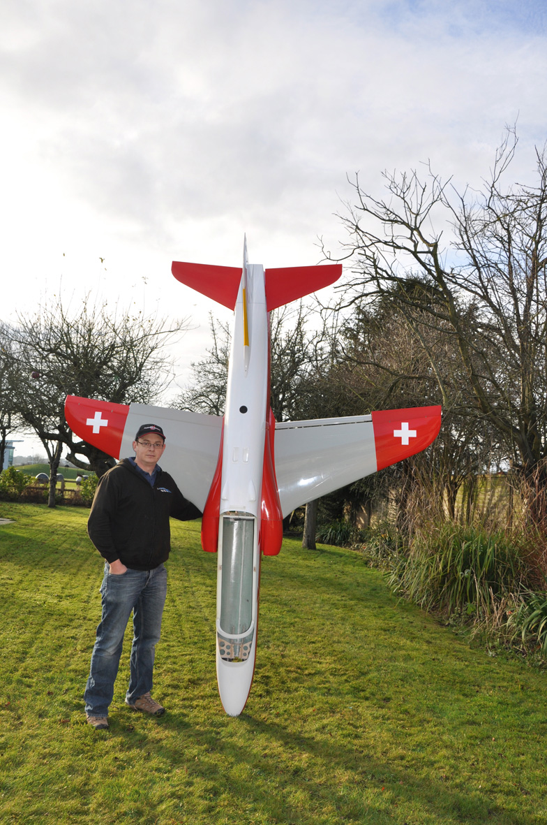

Mike , the wingspan is 2510mm and length 3000mm so slightly large than 1/4 scale
Vertical and horizontal stabs both remove very easily for transport and, should you wish to have it the front half of the fus is also removable.

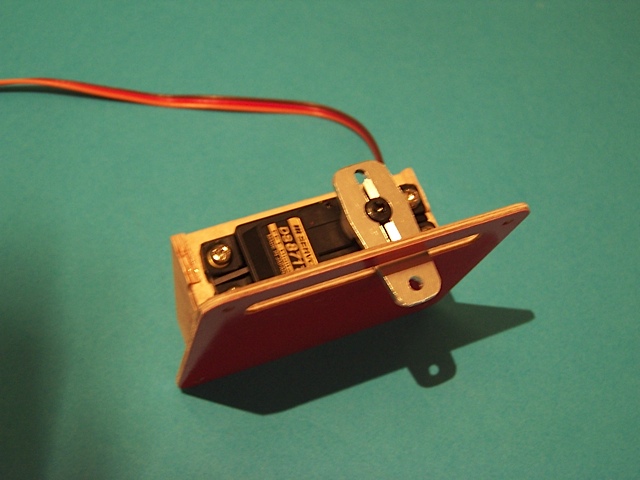

Moved on to the flaps and ailerons next. I could try and make this sound complicated but it was just a case of screw the servos in and make up linkages. The biggest decision was choosing the length of arms for the throws I wanted.
Ive decided to go with super smooth JR8711 all round.

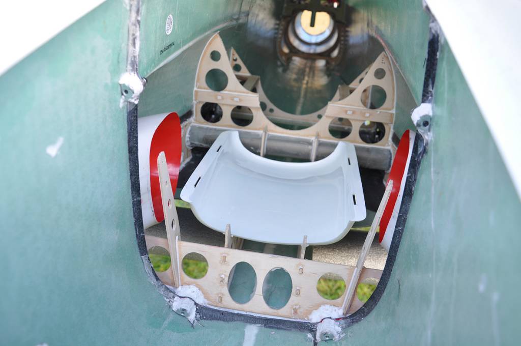

Default RE: CARF Skygate Hawk in the house !

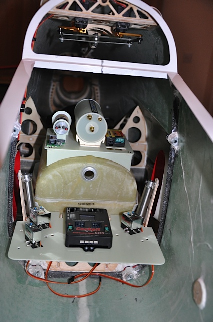

Have been playing with the install this evening. Decided to put the fuel pump, ECU and bubble trap on top of the tank which in turn is velcro strapped to its seat like the smaller Hawk and Tutor. I've done this for easy access to the turbine behind. The whole fuel system and ECU can be taken out with the tank just by releasing the tank straps.
The air and PowerBox system is on the forward tray but still mounted to the rear fus formers so the fus can be split easily if necessary - this is a big aircraft !
