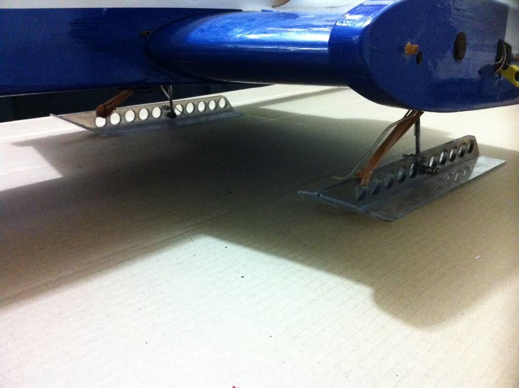

I recall a few years ago..seeing a video of Gary Arthur flying his Boomer Sprint in the winter with some custom ski's. I think I would like to try this my self this winter, with the same plane.
What are the possible negatives with this.. Crystals in the fuel? Can an additive be used? Grease freezing in the servos?
Would like to hear from people that have done winter flying with turbines.
Hope Gary still has the video of his Sprint on Ski's

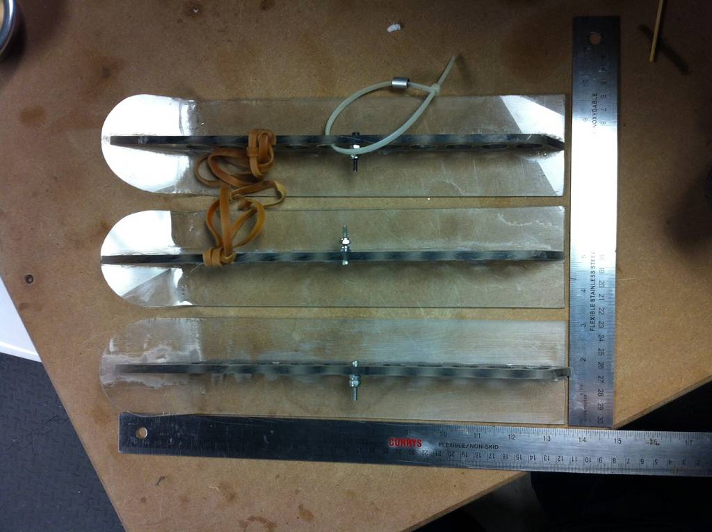

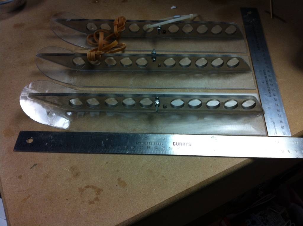

Flying in the winter is a lot of fun. The runway is so wide (the entire field) and the jets have added thrust due to the dense air. The only thing is you do not have brakes as seen near the end of the video when I was trying to get just a little closer.
I made the skiis out of lexan and they work great. They do not stick to the snow and climb out of the snow even when it is soft and fluffy. A simple elastic band is used to hold the tip up and a bolt is use as a stopper to control the height of the tip.

Thanks for posting Gary.
I understand you dont fly that bird in the winter anymore.. but if you were to do it again.. What would you different? Wider or Longer skis? seemed to belly out there in the deep stuff
Got any dimension you can post please. pics?
I love winter flying! Been doing it long time now..but never with a turbine or a plane as heavy as the spirnt all fueled up.

I still fly the same jet on the same skiis every year. I would not make the skiis any different. They work very well. As I mentioned earlier, they will lift right out of the snow as you start moving.
ID:	1834071   Click image for larger version
ID:	1834072   Click image for larger version

I added a few pics above.
I had a couple flights today on about 8" of snow. The only other fliers where the heli guys.
http://youtu.be/Ls4z5-qISqo
