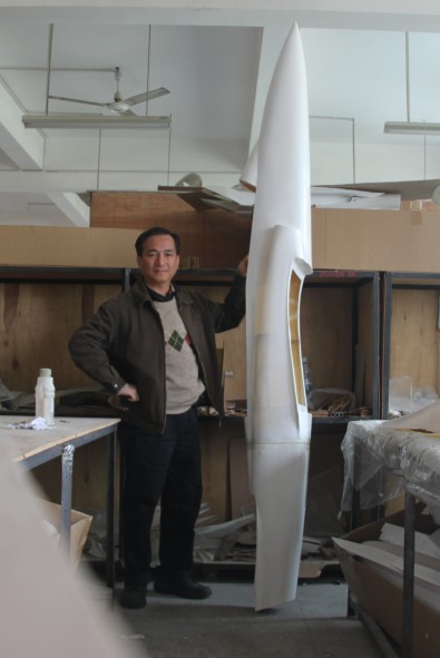

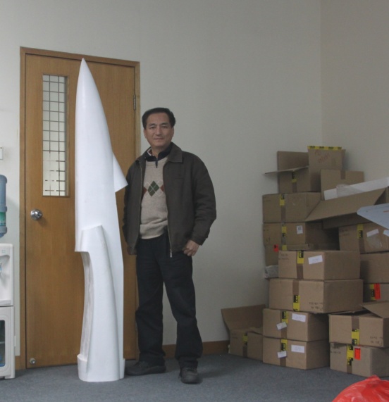

Hi all
i just got the front fuse of Ultra Dragon prototype ..
i am very happy with this large Dragon [X(]
cant wait to finish it.,

Anton its looking good , i cant wait to see the jet fuse finnished .  great work !

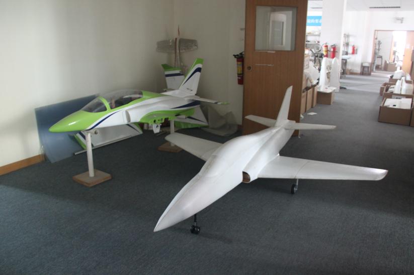

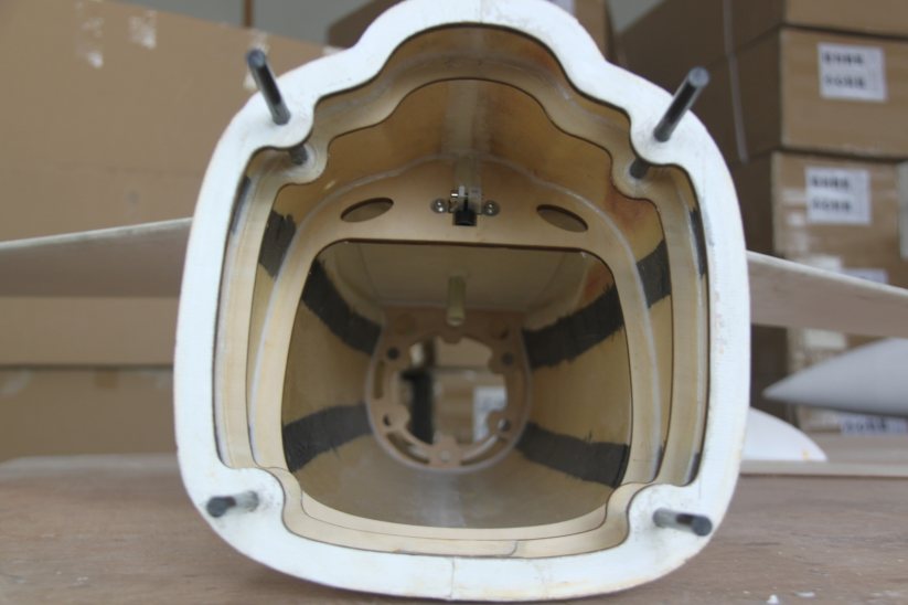

Thank you alot !!
the 2.65M (104.6") length very large![X(]

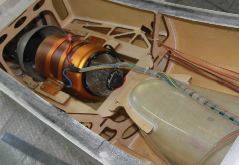

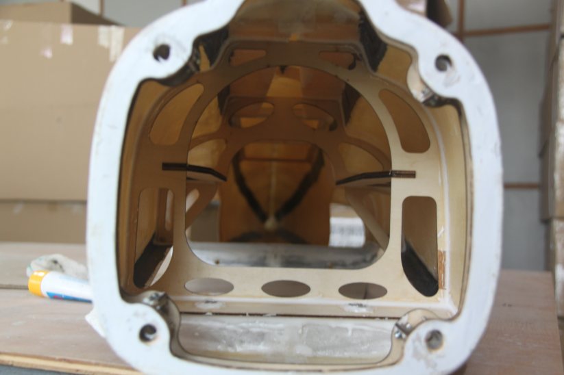

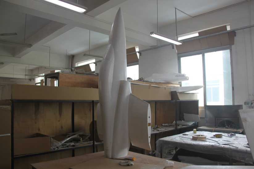

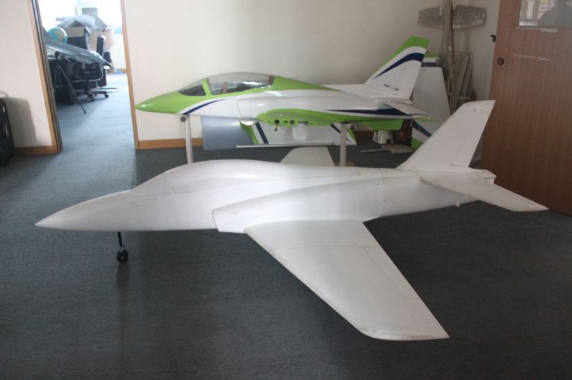

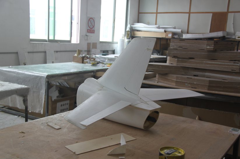

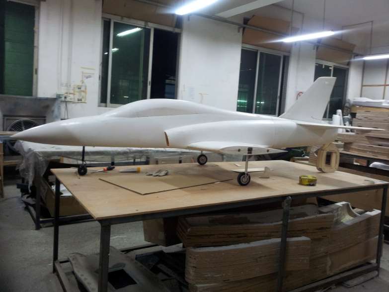

Thank you all suggested,
i think the weight for Ultra dragon (painted with the nose gear door) should be 16kg around.,(35lbs)..[X(]

Wow, you don't waste any time. From 3D drawings to having the turbine installed in the prototype
fuselage in such a short time is pretty impressive, at least to me. I love to see projects like
this take shape, please keep posting pictures.
