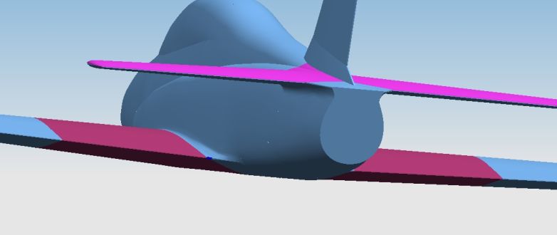

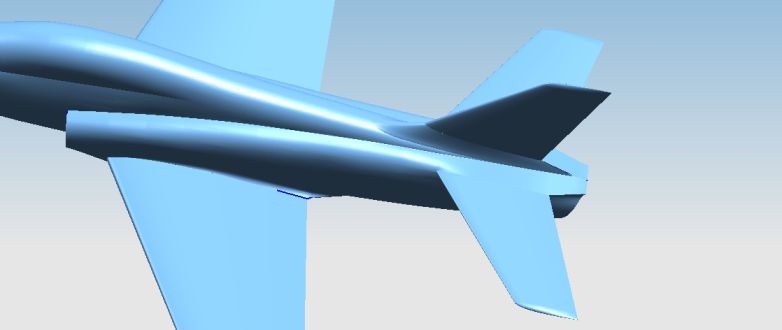

I am interesting design the Large aerobatic jet for the new rules of F-3S, i now enlarged the Dragon and modify some out line for better my new Ultra Dragon, and I can not wait to test fly it!
the new Ultra Dragon
length: 2657mm (104.6")
wingspan: 2337mm (92" )
here are 3D drawings for the ultra Dragon, i will let you know the more information for the new Ultra Dragon, any suggest would be appreciate!!

Fin/Rudder needs to be larger....taller (big canopy will upset airflow) and more cord to overcome fuselage nose area for good tracking...

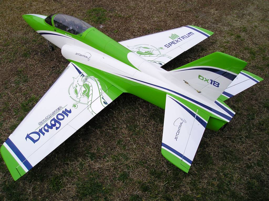

And can I get some trade in credit for my now compact dragon for the bigger version?
mike
Thank you, good idea ..

I love the design and the fact you are going to make this already great jet even better. I agree with Dave re; the vertical fin/rudder. From the CAD, it looks like both can be enlarged. . .BUT keep the sweep for stability. My suggestion would be to make the stabilizer/elevator and vertical fin/rudder exactly the same size. Benefit would be one mold for production as well as part exchange availability. There are aircraft manufacturers today who use this very concept. Another benefit would be aerodynamic balance due to exact airfoils of both.
I look forward to getting my hands on one of these. Keep us informed of your progress.

If you make the fin/rudder too tall,you will get excessive coupling during Knife edge flight. This can be mixed out,but is something you should at least consider.Good luck,

The trailing edges of the flying surfaces on most jets are to sharp, ( come down to a point) if these were kept thicker ,this also increases straight line stability. The fin / rudder trailing edge is one of the most important to do this it stops fish tailing.
Shape looks great, better than some to do the F3s job, :-)

I think you can increase the verticaly size of the air intlet to able to mount very big engine like P200.
I don't know if I have explain it clearly.

I think the whole concept is great. A larger Dragon will be nice. the cad drawings you posted look good to me.....maybe a little more cord on the fin and rudder for looks and added yaw stability
Mickey
