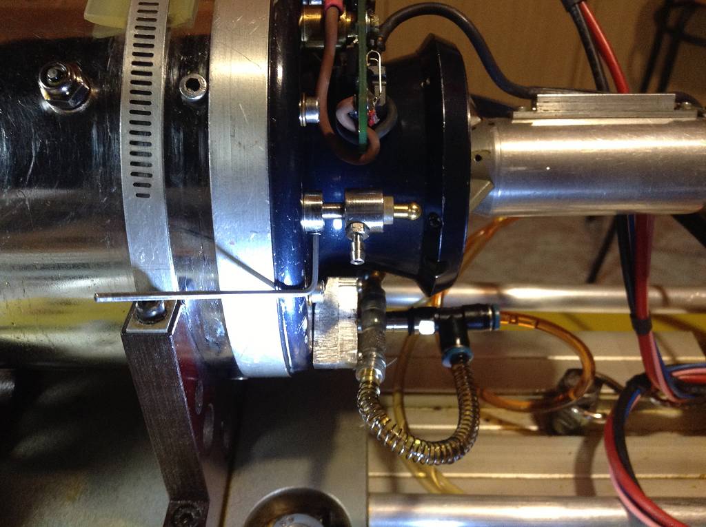

Specifics :
outside diameter 3,7mm
weight 6 gr
pre-warmer & vaporization time 3 sec
current <4 A
<!4><!4><!4><!4>voltage 6,5 - 7,3V
Santino

Here follows the video showing the turbine start with this new burner
Select the 1080HD resolution to see the engine parameters
The initial sequence consists of:
1) 0,5 sec to spin up the bendix
2) 1,0 sec to rise up the turbine rpm
3) 0,5 sec to detach the bendix for the bearings condition ECU monitor
4) 2,0 sec to regain the bendix and to rise the rpm at about 5.000
5) ignition
6) as soon as the temperature rise 8&deg; within 2 seconds, the main fuel starts
7) at 150&deg; it starts acceleration to minimum rpm
[youtube]http://www.youtube.com/watch?v=_HuBJeNHP1g&amp;list=HL1361627748[/youtube]
