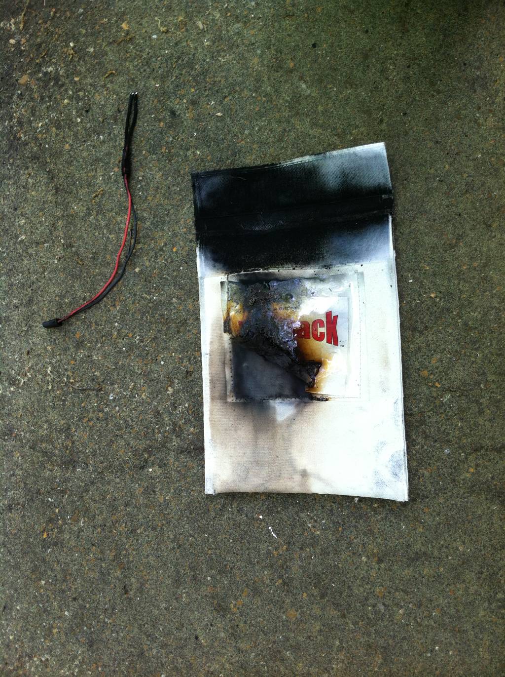

For those of you who charge their Li-Po batteries in their planes, take a look. This happened with me sitting 6 feet away. A battery exploded while charging inside the Li-Po Sack.
THANK goodness it was in the sack and not in my plane.
I was one of those guys who thought it would never happen to me.. WRONG!!!
John S.

I almost burned my house down with a cheap 1300mah lipo that I had put on the back porch in a document fire safe! It puffed while charging, I put it 3' away from my house on a on concrete in a document safe and still charred the side of my house... TP packs are all I use now.

I agree the li-po sack is better then charging in your plane... but it's still not a safe place! Li-po packs holds an enormous amount of juice, I use a 3S 2200mAh to jumpstart my Volvo diesel in the winter, doing the work my 120Ah lead battery can not do. I would never recommend anyone to trust a li-po sack with anything larger then a 500mAh pack.
When a pack caches fire there have been something wrong, mostly user error when setting up the charger. Would be intresting to know if you did find the answer to why this pack cought fire.
A concrete box with 2" walls would be a fire proof place to charge your packs, but the smoke would ruin alot of the stuff in the surroundings any way.

I've been in the hobby long enough to know two people who did lose their garages or part of their homes...I think dantley had a similar problem as well? I always make sure the proper number of cells is showing on the charger, and NEVER leave the batteries. I have a smoke detector sitting above them and fire extinguisher right next to it. My error was using a cheap ass off brand pack that were probably QC'd by a ten year old while he was watching cartoons. I still use lipos for my jets, but I have them taped together and easy to remove out of the plane to charge. Newer projects are A123.
I designed the Venom Stronghold metal battery charging box when I worked there. In the process I blew up many LiPo battery packs including 2S 5000mah, at least 12 packs in one day in the same container at one point.
My point is I know how difficult it can actually be to blow up a LiPo on purpose. I would say that the pack failures and subsequent fires and damage could have been directly related to charger set up error AND lack of supervision. The charger when set to NiMh charge mode can pop a pack but it takes a long time.
In general if your pack has not recharged in about 1 hour at the standard 1C rate then there is an issue of some kind. Being present to check the charging parameters will prevent a catastrophic failure. Most chargers will fault and stop a charge cycle if there is a problem provided it is set to the right mode of charge.
I have not seen, in the millions of packs we sold, a single pack explode during charge due to a defect. Ive always seen packs fail due to misuse and incorrect charger set up.
Also the one great benefit to a LiPo pack is its early warning by ballooning BEFORE bursting open.
In most cases Ive seen or purposely caused failure in metal round cells there is very little warning before a catastrophic event. When a NiMh cell explodes its literally a grenade sending shrapnel flying at high velocity outward followed by material on fire.
Ive seen cases of misuse and mishandling resulting in the loss of an eye and/or property damage.
I prefer LiFe or LiPo for my models and Ive been testing this for over 4 years straight in nitro, edf and jet models.
MAKE SURE YOUR CHARGER SETTINGS MATCH YOUR PACK BEFORE YOU PRESS START!
DO NOT STORE YOUR LITHIUM PACKS FULLY CHARGED FOR A PERIOD LONGER THAN A WEEK
DO NOT CHARGE ANY BATTERY PACK IN YOUR MODEL

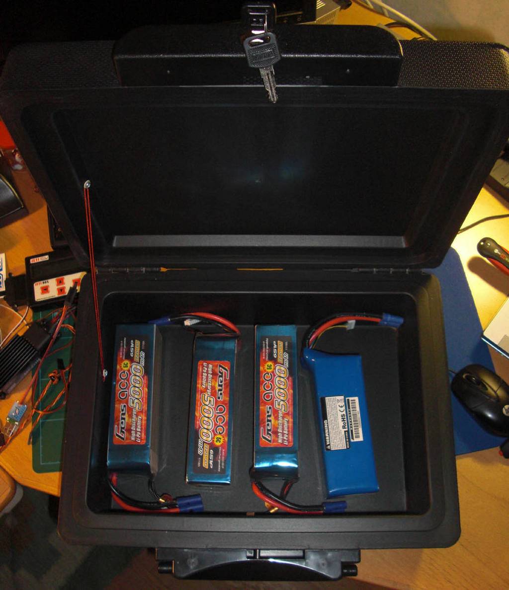

Hi,
I have 3 of these Robbe LiPo-Tresor boxes now so it feelslittle more safe to store all LiPo batteries I have in them.
Weight of the box (empty): 8 kg / 17.6 lbs
Inner dimension where the LiPo is placed: 320 x 220 x 75 millimeter / 12.6 x 8.7 x 3 inch.
Link to Robbe homepage about this "LiPo-Tresor":
http://www.robbe.de/lipo-tresor.html..._from_store=de
Video that show a 6 cell 5000 mAh LiPo on fire inside this box:
http://www.youtube.com/watch?feature...;v=hK4ECoV66Kg
It is little unclear how much LiPo packs You should safely place in one box and the box would still be able to handle aLiPo-fire in the box.
But Robbe said this when I asked them:
Hi,
You can put many batteries there if you have enough place for this. The case is to eliminate open fire - not for smoke or something else....
with best regards
robbe® Modellsport GmbH & Co. KG
i.A.
Carsten Druleib
Robbe-Service-Center
Metzloser Strasse 38
36355 Grebenhain
Not crystal clear answer.
I do not think there are any Robbe dealers in US but maybe the CentrySafe Small Capacity Fire-Safes that is available in US can work OK also
for storing LiPo packs:
http://www.sentrysafe.com/Series/89/...ity_Fire-Safes (View all)
/Bo

I would be interested in how this fire safe is different than the one I had. A 1300 mah pack completely destroyed it. That one looks identical to the one I had. The pack burned through the fire safe, then the side of my house.
Hi,
That is the big question: how much total LiPo packs can be in such box. How large packs (how many cells and mAh) can be safely in the box.
I have 3 old 6 cell 5200 mAh LiPo packs that could be the "fuel" in a test but it would be an expensive test for me to find out what happen if
in a test all that should go on fire in a Robbe safety box. Little to expensive experiment for me.
At least the box is better then the standard grey LiPo sacks I had before. But the LiPo safety boxes like the one from Robbe may lead You to think You are safe but in reality it is no guarantees Your house will not go up in smoke if a LiPo pack in the box goes on fire.
Only proof is the video, that it can handle one 6 cell 5000 mAh LiPo that catch fire inside the box.
I know Graupner also has a LiPo safety box but it is much more expensive (close to 5 times more then the Robbe safety box).
http://www.graupner.de/en/products/c...1/product.aspx
/Bo

In terms of storage your container, like an ammo box, is not the best idea but it will do for 2 or 3 packs maximum as long as they are 2 or 3 cells a peice. For larger packs 3 cells and up these should be isolated to one container per pack ideally.
Do Not Store all of your LiPo packs in one container. Spread them out over a couple containers to prevent a runaway fire situation and potential explosion.
LiPo packs EXPAND to 4-5X's their size when they fail. If several of them are in one container they will probably burst the container and effect anything surrounding the immediate area.
Also what keeps a LiPo pack hot after the fire is over is the many sheets of copper that make up the individual cells. These will be very hot and will contribute to the fire situation.
Storing of LiPo packs should be done at the nominal voltage of 3.7VPC. If not the packs chemistry will cause more internal resistance, poor performance and loss of capacity. LiPo is not the best "storage" chemistry. LiPo is designed for cycles not storage. For storage applications use LiFe.
