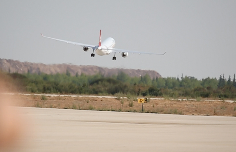

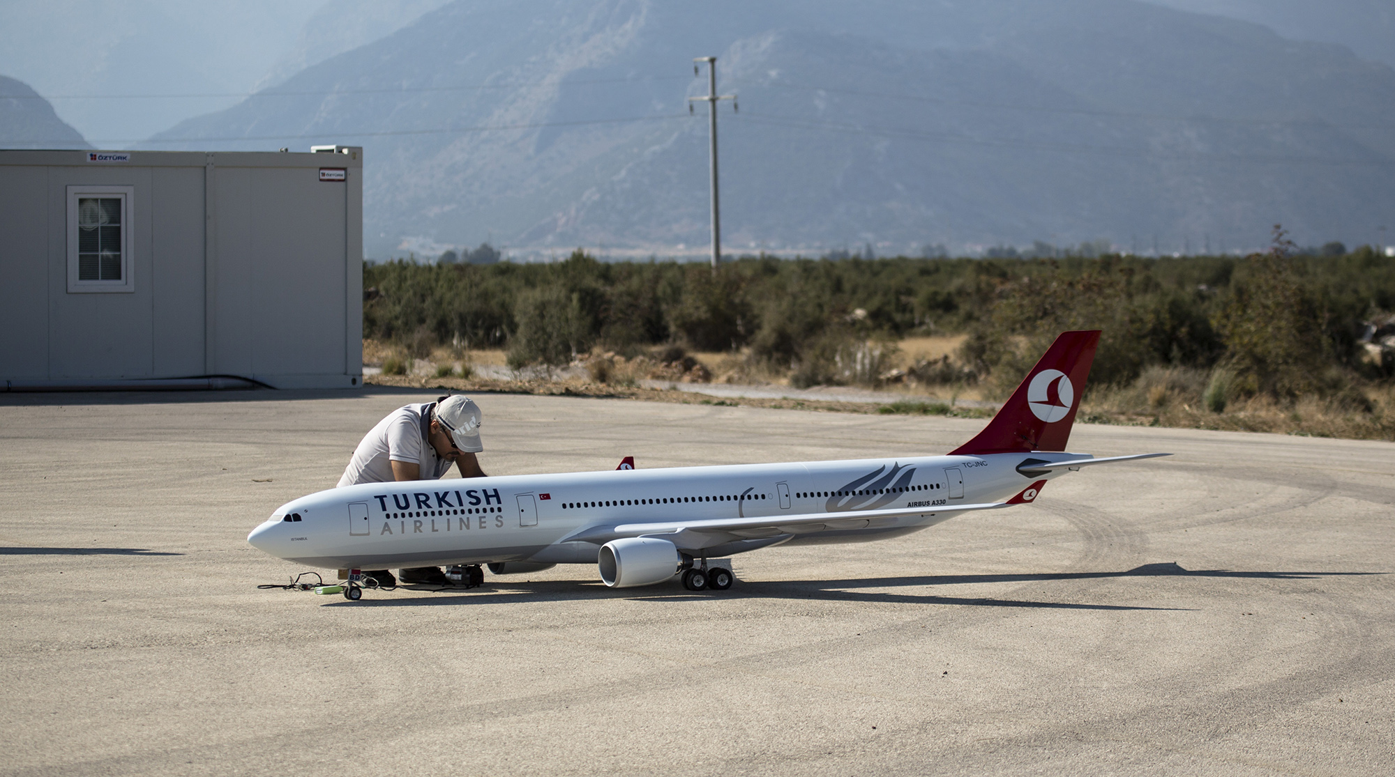

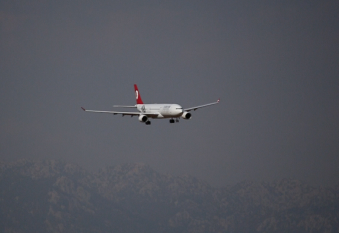

http://www.youtube.com/watch?v=liaGLkpAhIo here are some photos of my fight...
ID:	1925961   Click image for larger version
ID:	1925962   Click image for larger version
ID:	1925963   Click image for larger version

Fantastic!!! great job in the windy conditions. congratulations.
Great aircraft the A330. If I were to build an airliner, that would build the same, either a -200 or -300, and it has to have the CF6-80 engines
dave

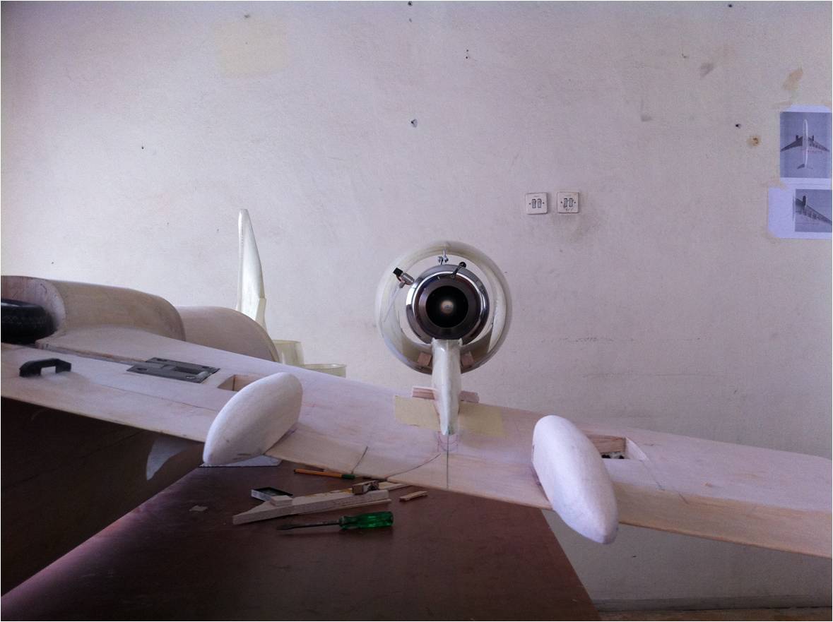

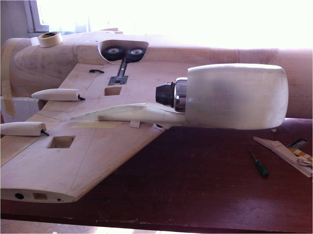

Congratulations on a very nice plane and flight! Would be interested to see how you fixed the turbine inside the engine shroud and how the whole engine is fixed to the wing.

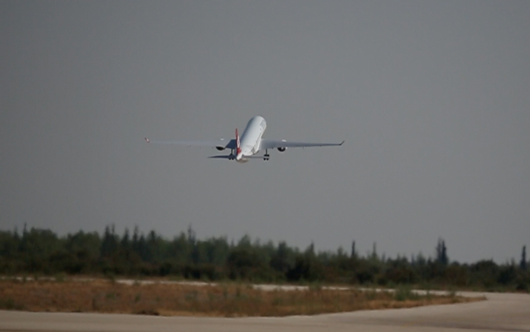

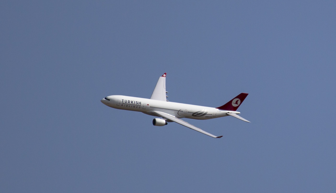

Default Photos of 2 nd flight
ID:	1926031   Click image for larger version
ID:	1926032   Click image for larger version

here are some photos showing the detail. There is no direct connection between fiberglass parts and engine. I've used a strong wood fixed to the wing (with epoxy and carbon rod) in one end and the engine in the other end.

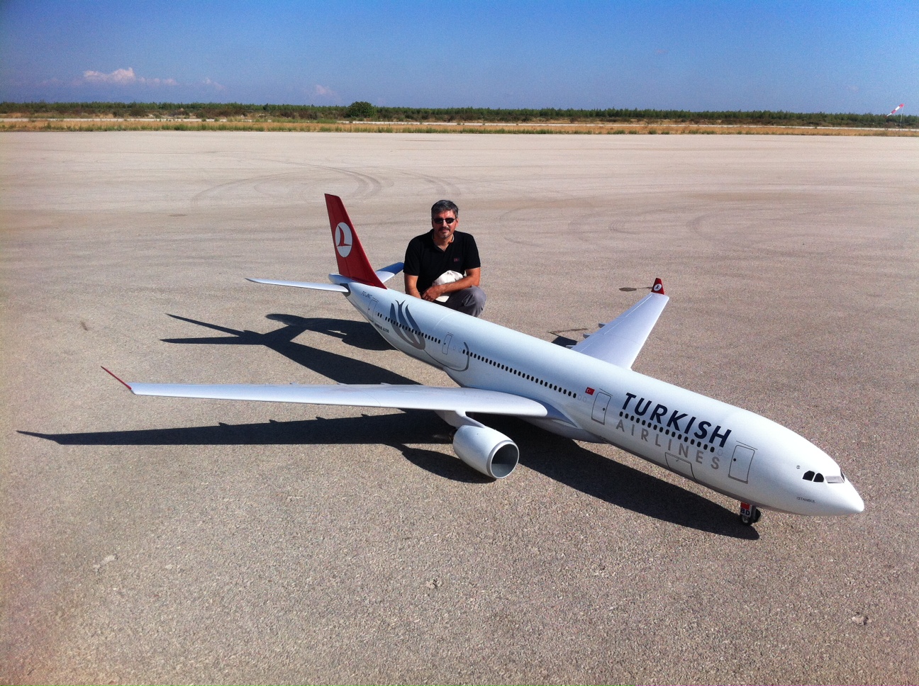

Nice A330, did you make the plans yourself?
Old 10-01-2013 | 01:11 PM
  #35
Joined: May 2013
Posts: 38
From: Istanbul, TURKEY
[QUOTE=jsfboat;11628486]Nice A330, did you make the plans yourself?
Plans are from Norbert Rauch from Germany.
