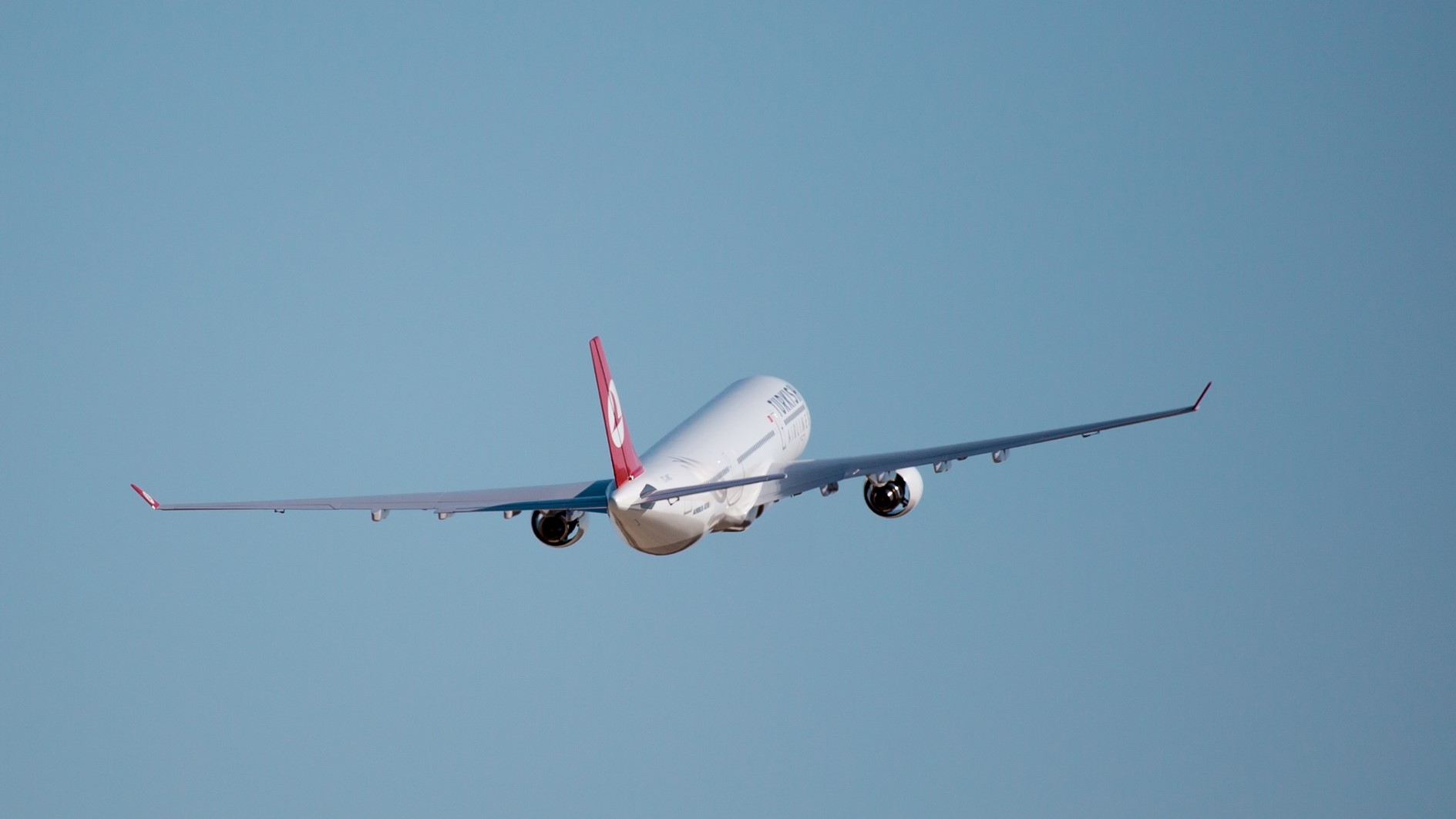

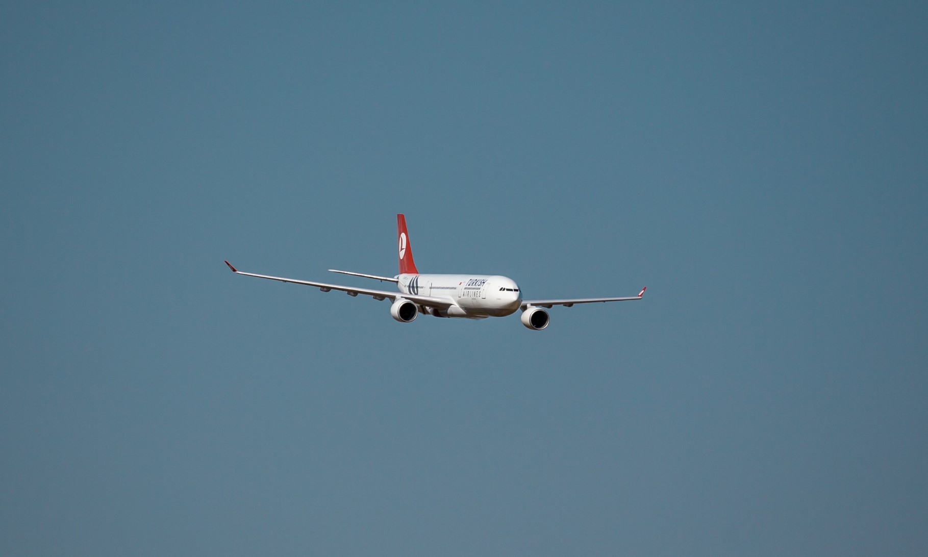

new photos of my girl...

She is beautiful Do you have video?

Thanks Mike,
here is the video ..
http://www.youtube.com/watch?v=ptMMyy_fFlo&feature=youtu.be

Thanks for video Sir.
You also have a little bit way and roll instability during fly on low speed?
