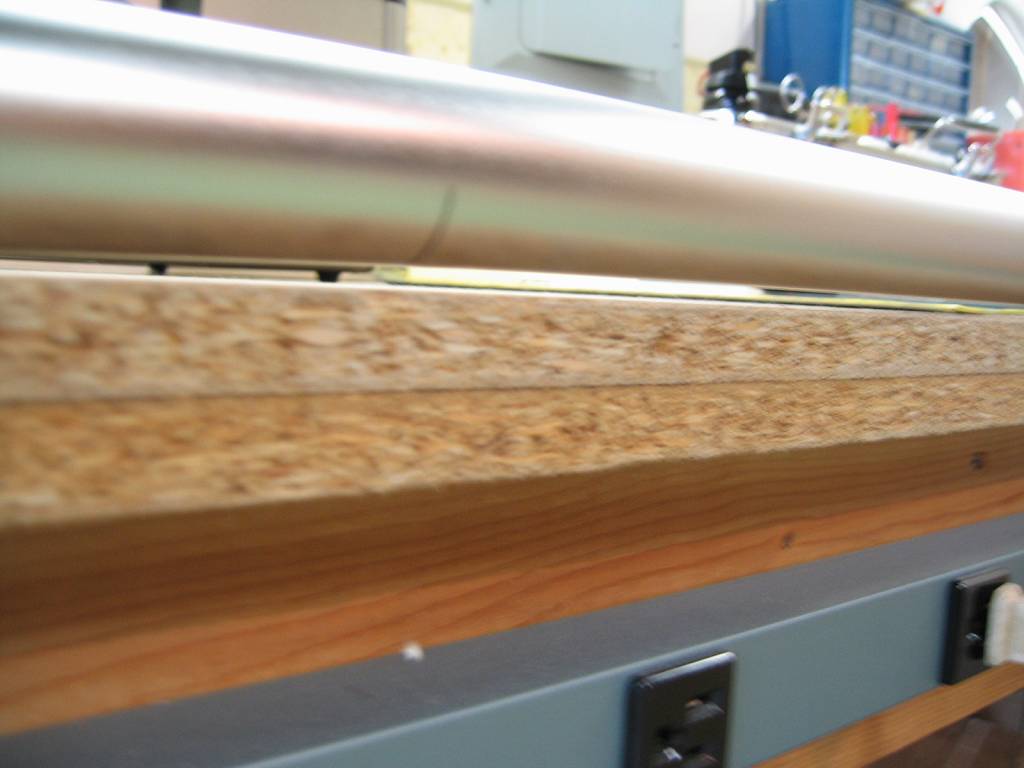

Hello Guys,
I was out flying some easy flights on my new Skymaster Large Hawk this afternoon. 4 flights today, The airframe after today only has 18 flights total. After my flights today and during the tear down, I had a hard time pulling out the wing tube. I knew right away that this was not a positive sign. After getting the tube out of the fuse, this thought proved to be right. I had a bent wing tube and from the way I flew it today, this was hard to believe how bent it was. It even has a start of a compression at the joint of the fuse and wing root. I am not hard on my airframes with my style of flying. No hard pulls or high "G" manuvers. The largest gap from the table surface is 3/8" in attached pics.
So my big questions is, are there any substitutes for the Skymaster wing tubes ? I have tried checking my aluminum wing tubes from my planes and even a Carbon Fiber tube that I have and they are just a tad oversized compared to the SkyMaster tube on my plane.
What do you guys do in this case? Are there any sources for replacements other than Skymaster ?
If i have to use a Skymaster replacement tube, can I add a ply insert in the vertical position to help with this bending problem, and is it even a good idea ?
Thanks for any advice and help.

If you can find an insert(tube) of either aluminum or carbon tube that fits inside, that will increase the AMOI of the existing tube(unless there is a seem then forget it). But you got to get this one straightened or buy a new one. Aluminum will yield and fails pretty quickly outright after you reach the ultimate yield strength. I dont think you got there yet, but it yielded in the extreme fiber for sure.

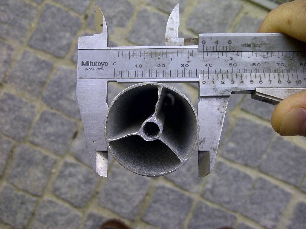

Ho Joe
This tube is 38mm OD.
There's an old thread regarding this issue, regarding wall thickness of the tube. What's your tube wall thickness? There are 1 and 1,6mm thickness tubes. It is very important to let us know tube profile and thickness
I asked SM for a larger tube like this one and been trying to find it for ages...... this was the one sent with my kit

Nuno, isn't that 36mm?!
Old 06-05-2013 | 01:44 AM
Pat Barnes's Avatar
Joined: May 2009
Posts: 186
From: Dorset, , UNITED KINGDOM
Default RE: Wing Tubes
ORIGINAL: schroedm
Hi Mark - Nuno is correct - you read the calipers at the 0 on the bottom scale, not the metal edge. The top scale gives the decimals so the calipers are reading 38.0mm in the photo.
Regards - Pat
