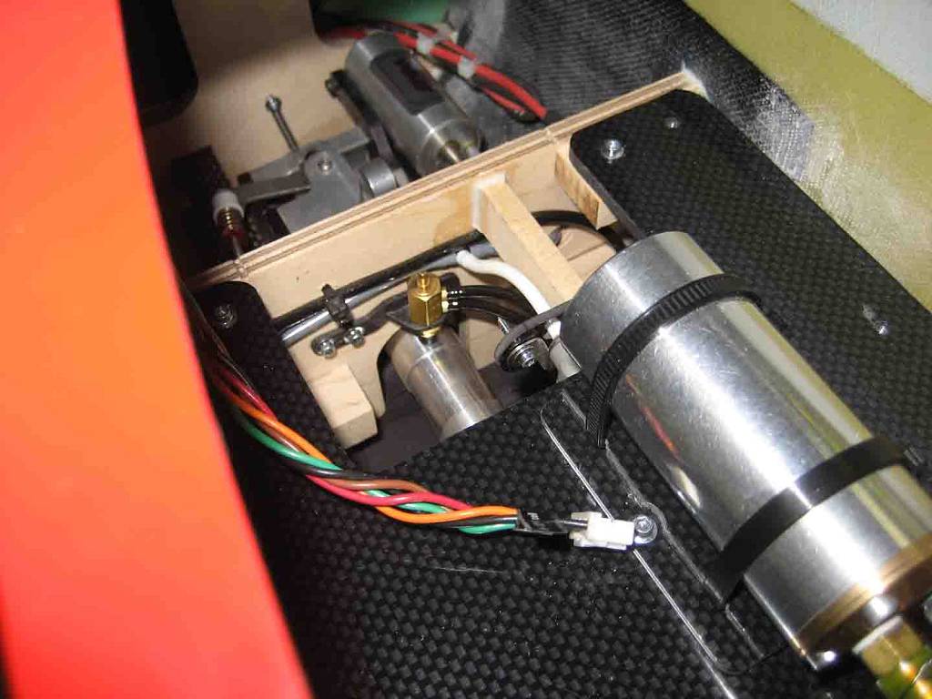

I'll go against the consensus here. I used the push button on my Ultra Bandit just as the instructions show and it worked fine. I like it because it is the simplest solution (KISS principle), it is easily adjusted and by having it actuated by the nose gear strut, it guarantees that the nose gear door will never actuate closed before the nose gear is retracted. None of the other methods can make that claim and it's almost a guarantee it will happen sooner or later for a variety of reasons.
I'm not sure why people are saying the nose strut retracted position is inconsistent....this is BVM stuff! Wherever it retracts to, mount the button firmly against it and you're good to go.
From your description, you have a bad switch. Get a new one and you will be fine.
Craig

Craig, my install is an identical copy of yours.. and it leaks more often than not.  I have set it up in such a manner that the button is completely pressed when the gear is up...but every now and then I find that the gear has not reached the exact same place to compress the button.

In that case, I would try the mechanical arm like Harley suggested. I would also make sure you are positioning the button with the jet upright, such that whatever "droop" there is in the gear is accounted for (i.e. with negative G it just pushes against the button, rather than away from it with positive G), if that makes sense.
I also still believe you have a bad button. I would get a new one regardless because it should not leak air under any circumstance.
Craig

Ragz,
You have a leaking button valve.
I have the same system as Craig's (but with the lever) in my FA-18F, on a main gear leg. It works perfectly, and the doors cannot close unless the gear is in the wells. I try to use the KISS principle. (Keep it Simple, Stupid).
Changing gear valves is a hassle, and many of us have found some of the electronic valves to be expensive junk.
Just install a new lever actuated valve in the same place, and the problem is solved.

I have has similar issue with the lever activation on my nose gear for my A10. A little flex in the system caused the lever travel to vary and the valve to leak. It worked fine out or depressed, but partially it caused a problem.
I reworked mine by making sure the structure around it was solid and also used a softer endpoint.
I used two fuzzy sides of velcro(so they don't stick) so the the lever would be pushed firmly but could also not have too much push on it. This worked for my A10.
I had it hard mounted in my f18 on the nose gear and that worked fine too.
I did have one break (plastic arm) also.
My uB has the over travel trigger, this works well but also doesn't ensure that the gear are retracted before triggers the nose door.
I just have the gear servo slowed down so it works fine in the air.
Good luck
