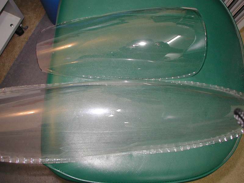

Hi Guy's
Here is the shot with and without Future. Hope you don't mind.
Dave R

How do you apply the Future?????
Kevin
Old 09-25-2003 | 07:40 PM
WhoDaMan's Avatar
My Feedback: (164)
Posts: 4,243
From: Davis, CA
Default RE: Canopy cleaning?
Hi Kevin:
Very easy to do. The way I do it is of course making sure there is no dust on the canopy. I use soft clean cloth or a soft paper towel. I soak the towel with the future and wipe the inside of the canopy in one direction only. After that has set up in about 30 min, I than do the same on the other side. Work fast it sets up quickly,,,, always start at one end and wipe toward the other. It has instructions on how to remove. keep the towel soaked. Do not worry about little hairs they will disappear. The way modelers do is dip the whole thing. Makes them look like glass. Practice if you can. Hope this helps
