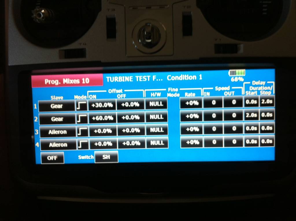

I have a 1/6 SM Hawk using a 18MZ.
The gear and doors are on one BVM valve using one servo. I have had to use the slow servo function to give the doors enough time to close since the landing gear is so slow on retracting.
My question is:
Is there a way to have a mix where the servo will initially travel a certain distance at normal speed then at a particular point travel the remaining distance at a slow speed.
Don

Yes.
Go to you P mix screen. Select offset feature.
Use line 1 and 2 for your gear function.
Put in your first offset point on line 1 and your second offset point in line 2.
Now put a delay on the "in" of line 2 and a delay on the "out" of line one.
This will allow the gear to move to the first point immediatley, then have the delay before moving the remainder. Same for when you turn of the mix, it will delay the opposite way.
Old 07-25-2013 | 01:22 PM
Gary Arthur's Avatar
My Feedback: (29)
Posts: 1,436
From: Hamilton, ON, CANADA
Default RE: Help with offset mix for gear
Looks like this

Old 07-25-2013 | 01:47 PM
Don Perry's Avatar
My Feedback: (51)
Posts: 688
From: Oklahoama City, OK
Thanks!
Exactly what I was looking for.

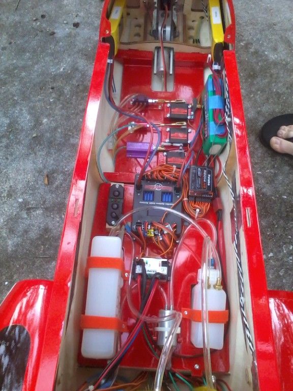

Old 07-26-2013 | 07:10 AM
Don Perry's Avatar
My Feedback: (51)
Posts: 688
It's one BVM valve operated by one servo. I forgot to add the the opposite servo horn also actuates a BVM button valve which closes and opens the doors. but for my programing question the whole set up is done using only one servo.
it is the top servo in the pic.

Old 07-26-2013 | 07:19 AM
My Feedback: (61)
Posts: 494
From: spring, TX
ORIGINAL: Don Perry
that sounds better
i use that method all the time. works great.
Dieselman1220's Avatar
My Feedback: (25)
Joined: Feb 2004
Posts: 886
Received 10 Likes on 9 Posts
From: New Braunfels, TX
Yea that's what I thought that's a neat set up just takes some tinkering to get it right
