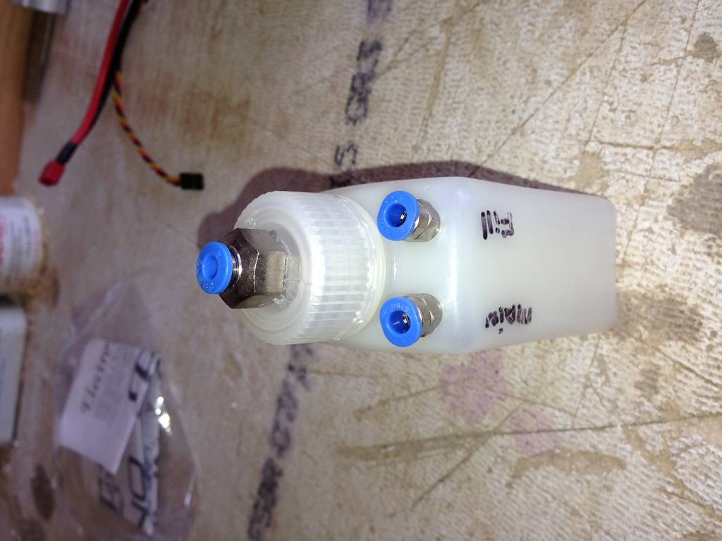

Hey all, got an HST for my current jet on the bench and this jet used to be set up for a UAT. The problem i see is the UAT uses a larger size tygon because it has barbed nipple fittings and the HST uses a festo connection. Has anybody had this and how did you do it? Just use a festo step down fitting? Or did you convert the HST to a nipple style setup? Also, the HST uses a metal clunk and not a bag, does this arrangement work well? I have always used the UAT and have no prior knowledge of the HST. The tank will be setup in an almost vertical arrangement due to space. Thanks in advance!

Are you sure it's a Hanson air trap? All the ones I have seen have bags the same a UAT.

Pretty sure it is, got it off a friend and he said it was

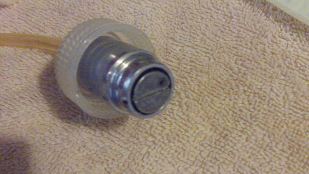

Here is a pic of the clunk

Dont think thats a Hanson, My Hanson traps have barbed fittings and a bag...
yours might be a MAP bubble trap.

All Hanson including the HST is bagged.. Not sure witch one this is but i would go with the traditional BVM or Hanson Bag style.

Yeah, thats not a Hanson Nick, Hanson has barbed fittings and bag, just like BVM UAT. That looks like a home made UAT.

It looks like a well made air-trap. You could use the festo male barb or female push lock 6mm to 4mm adapter. And tygon will work over the male barb of the adapter. Use safety wire. Just DO NOT use tygon into the female 6mm adapter. The tygon is too soft and will deform over time and cause a leak.

I read on some older posts that the original HST had the festos and Hansen offered to retrofit that style for nipple fittings to accompany the fellas with larger turbines because they were worried about vacuuming of the larger engines...Is it possible this is a HST but the older style?

That looks like the MAP trap. I'd get a bvm, hanson, or JMP accumulator.
