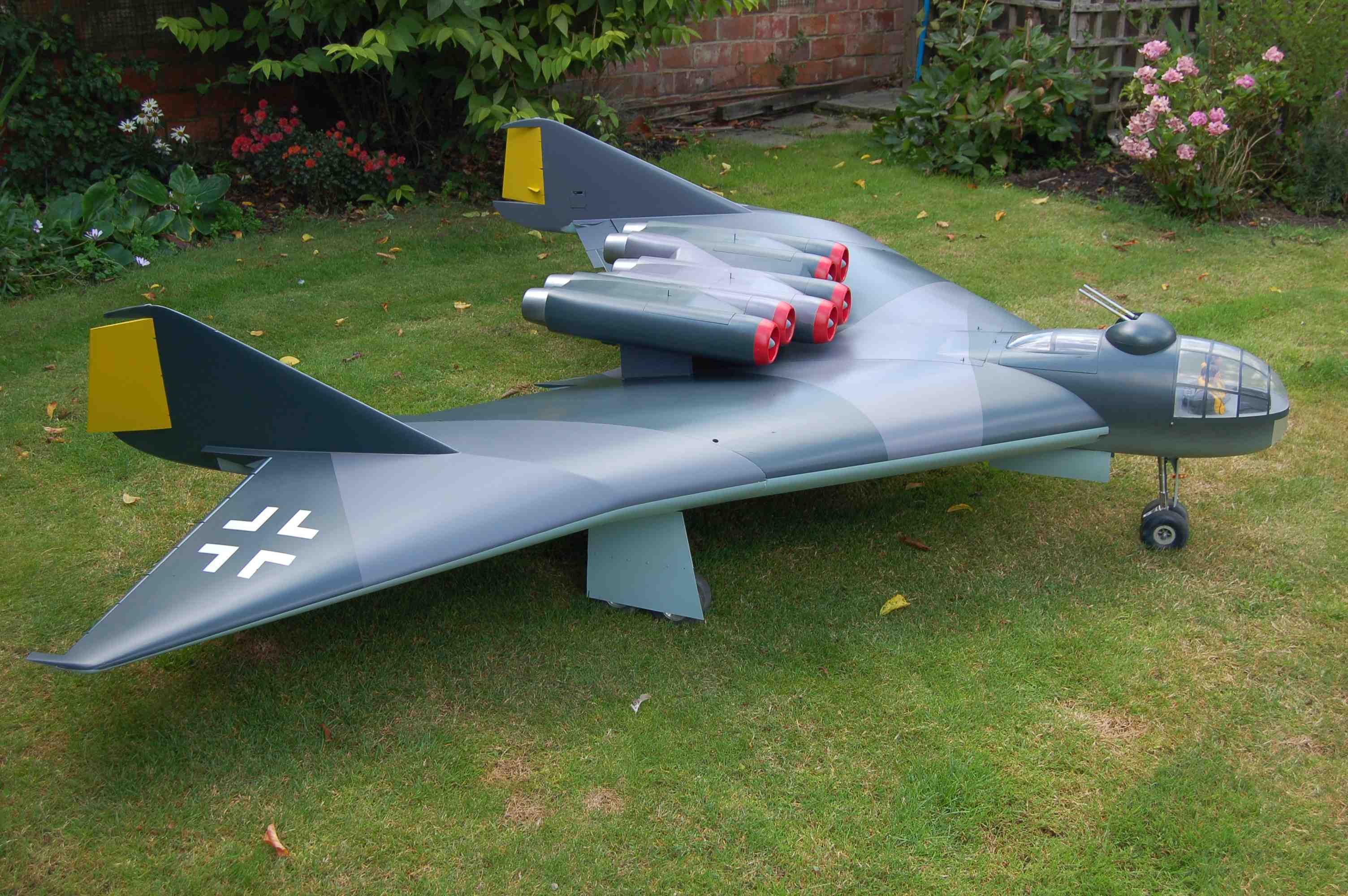

For those that have not seen the plane here is an earlier shot taken in my garden.
