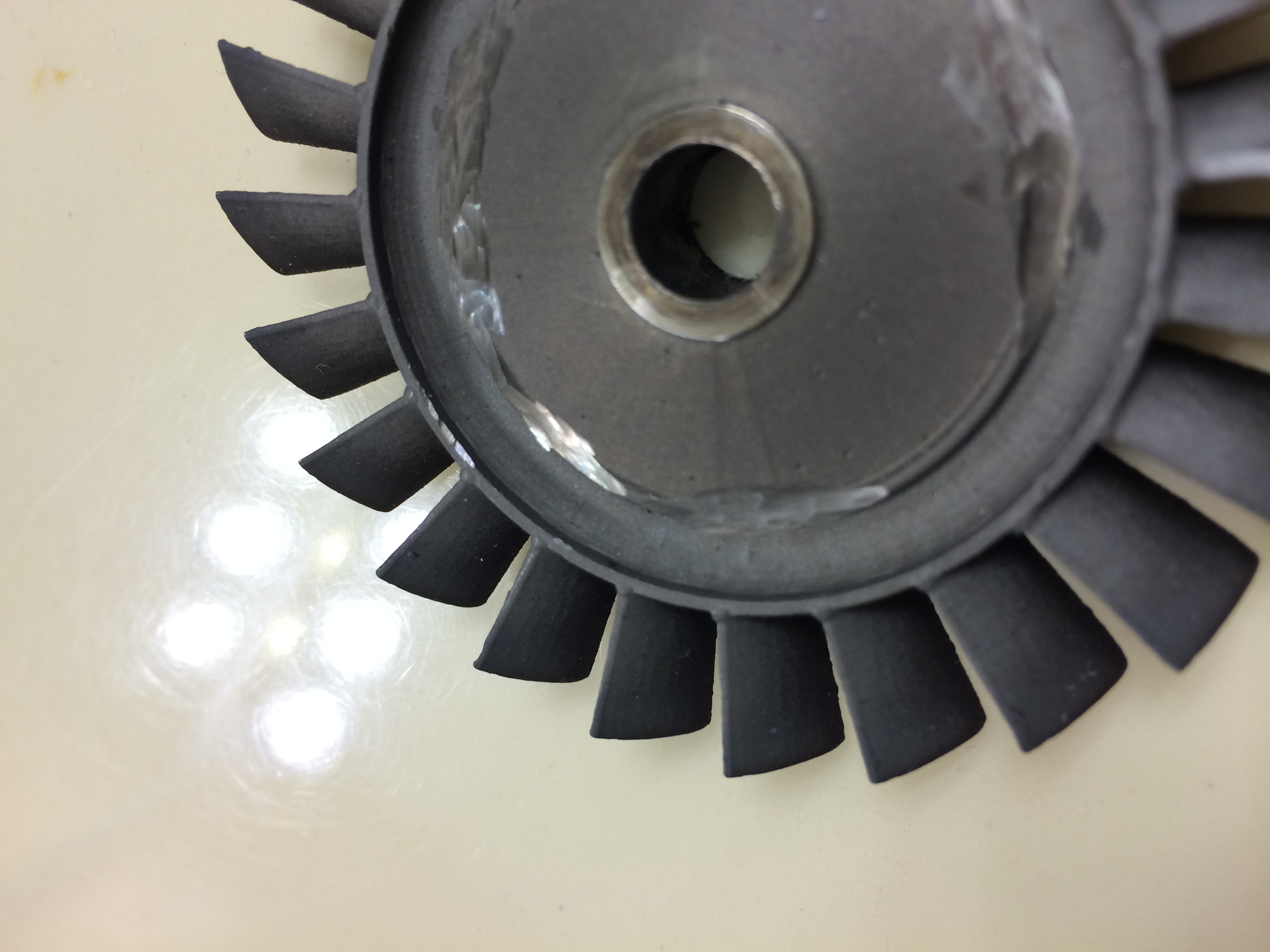

I am not sure that the back side of the wheel is marked, it might be the front side. The way I was shown to tell the difference is to look at the point where the trailing edge of the blade meets the wheel and see if there is a lump there. I don't remember if the lump was good news or bad, I'll take a look tonight and get back with you. Along time ago I posted pictures of this, but it's been so long ago I don't even remember if it was on RCU.

......... The way I was shown to tell the difference is to look at the point where the trailing edge of the blade meets the wheel and see if there is a lump there. I don't remember if the lump was good news or bad,....................
Steven
I found an old thread from 2003, and it said that the "Bumps" were the wheels that were questionable. The S/N on my engine is 1K158, and the printed manual is from 2002. So, I guess I can assume it's a later engine. And, hopefully, it's when they decided to start x-ray'ing.

If you look at the picture (provided I can figure out how to post it) you see a suspect wheel. The bumps where the trailing edge of the blade meets the wheel is the give away that can be seen looking up the tail pipe. If that area is smooth you probably have a good wheel.

Thanks for the pic. I can see what you are saying. It's almost like a weld bead at the junction.
BUT.... I just put a bore scope down the center cone, and my blades transition smooth !!!
