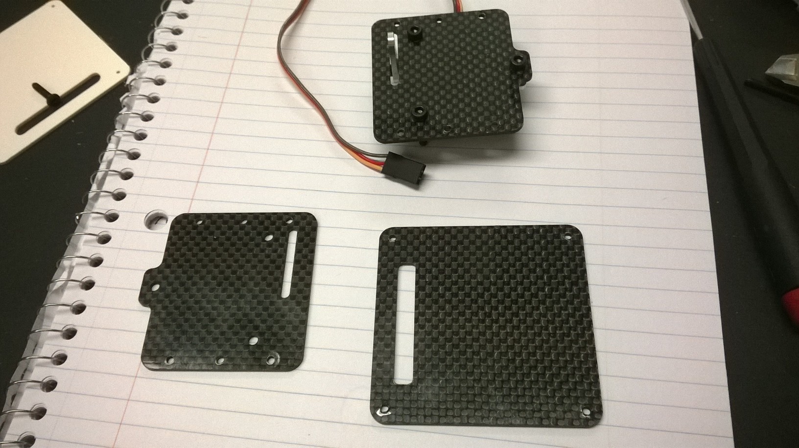

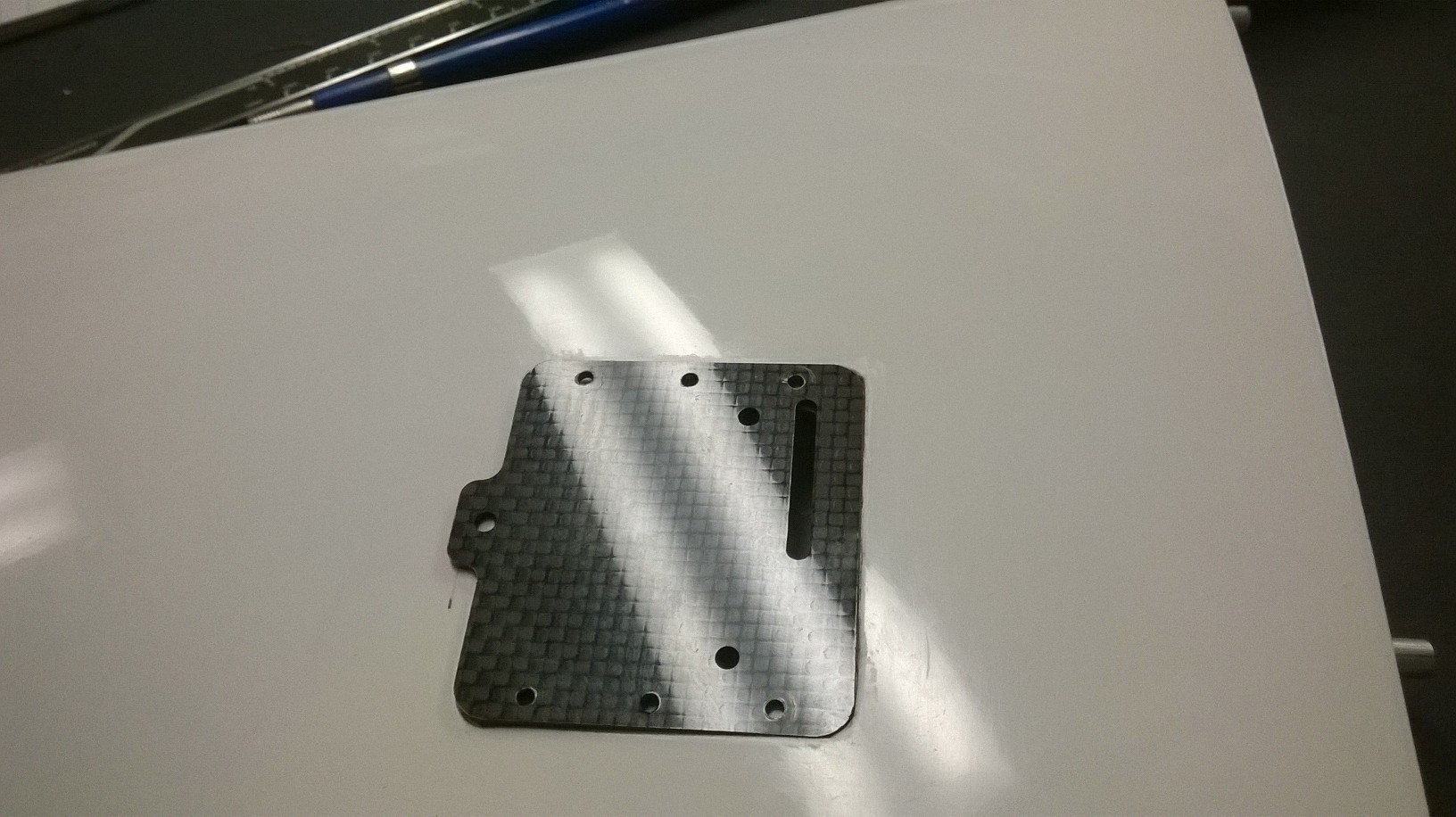

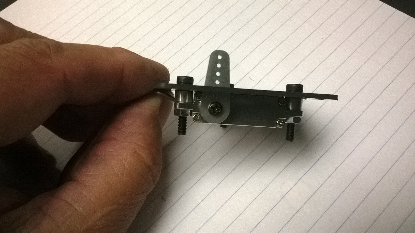

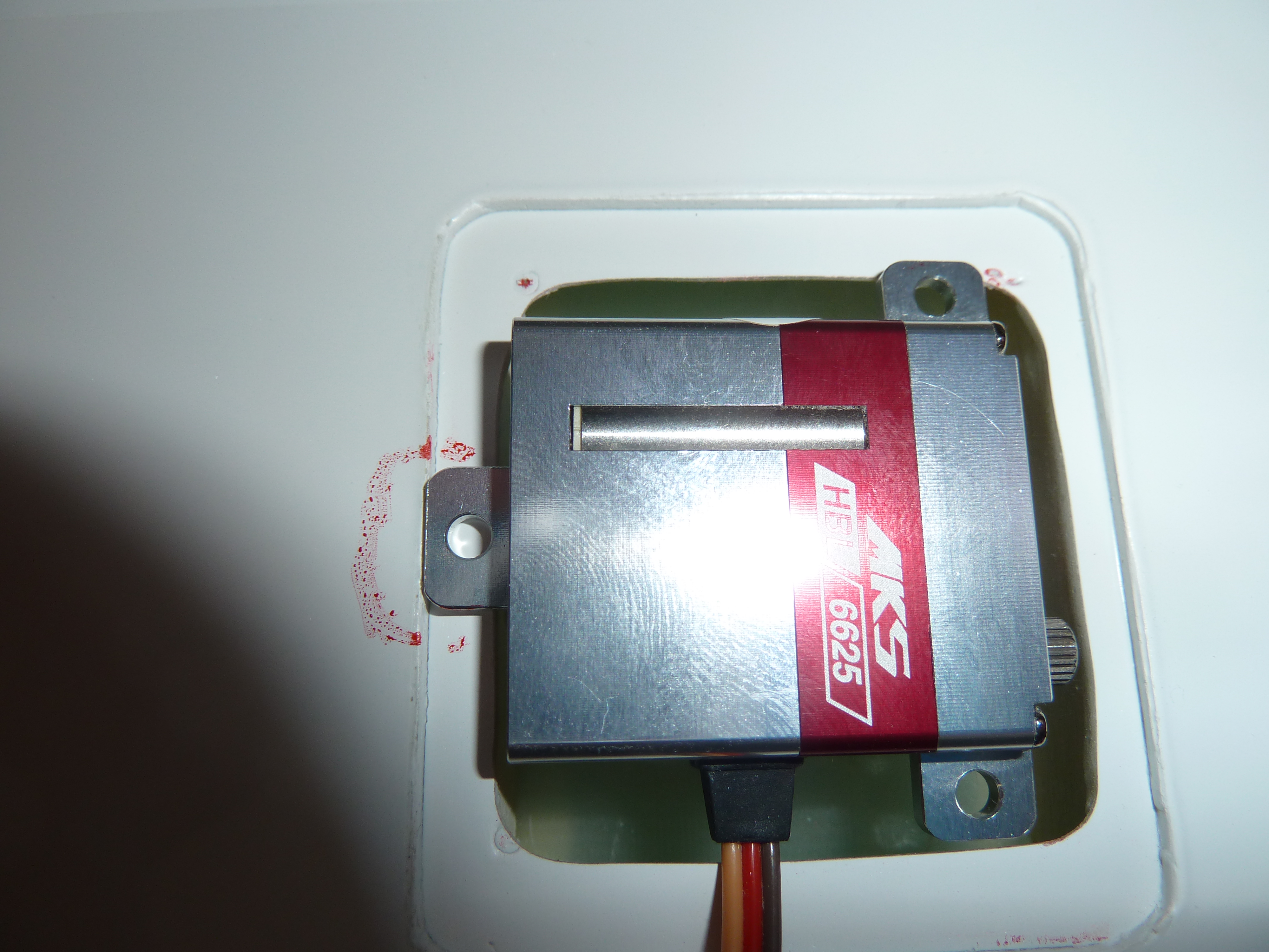

A friend cnc'd some new carbon servo plates for my plane. We came up with this method for the elevators. I am using MKS 6625HV wing servos with three mounting lugs. We had to flip the servo output over to the inboard side of the bay as I did not want to notch the inboard rib for the bottom servo lug clearance. This rib has the elevator tube running through it. When I get them mounted I will post pictures. Will also change mounting bolts to button heads.

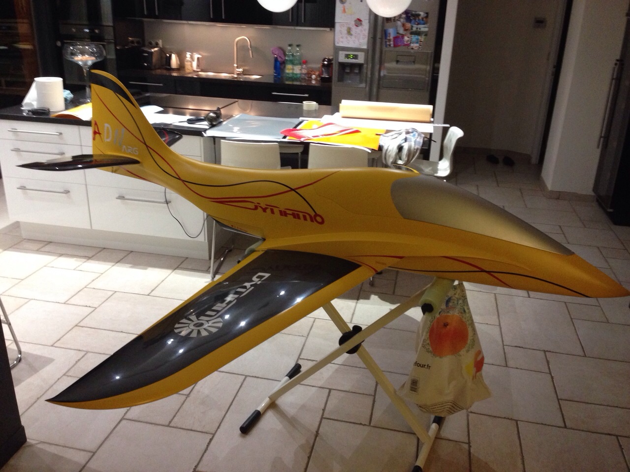

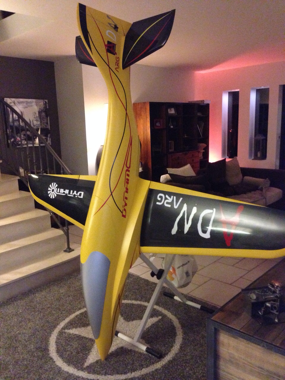

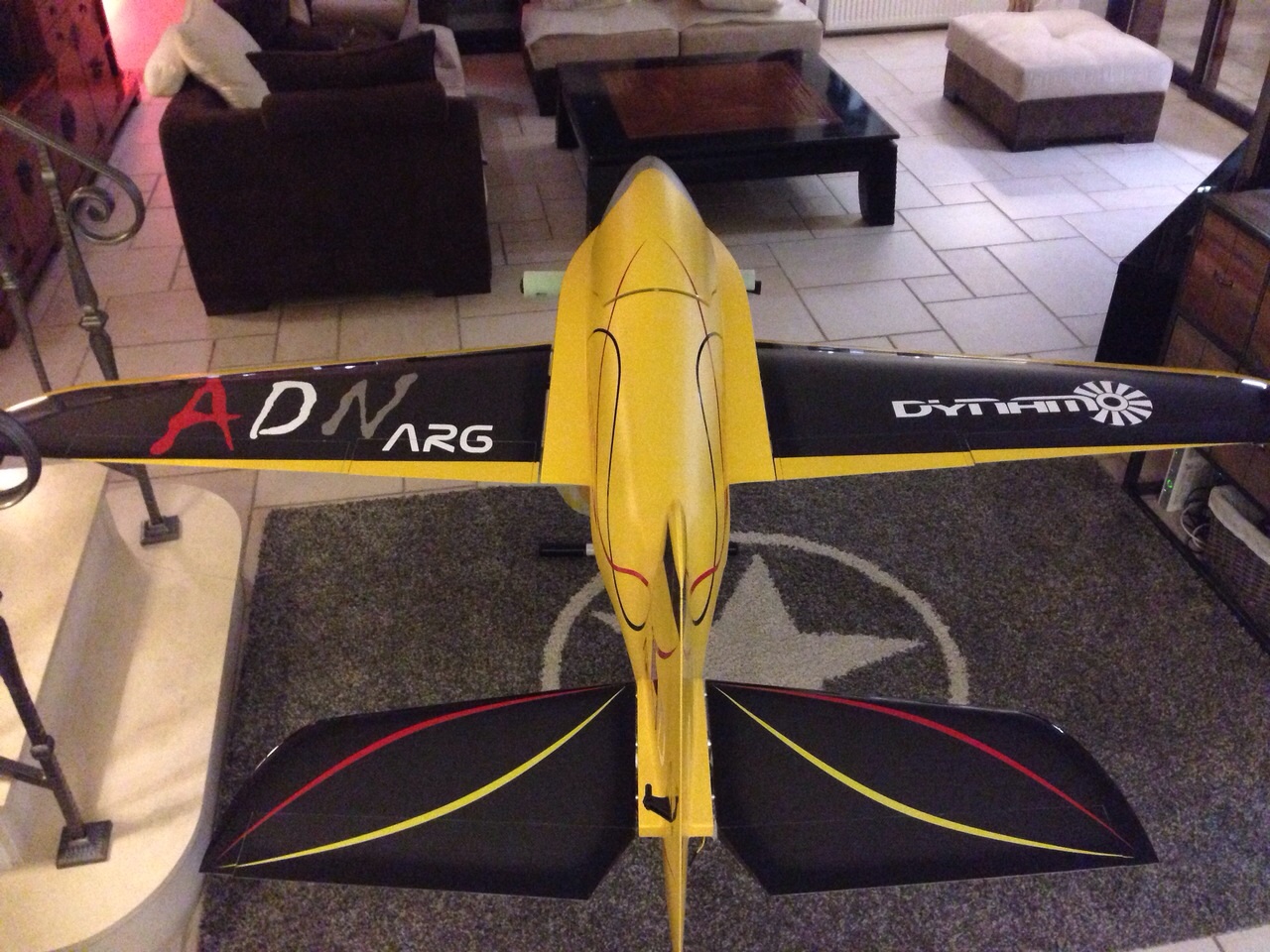

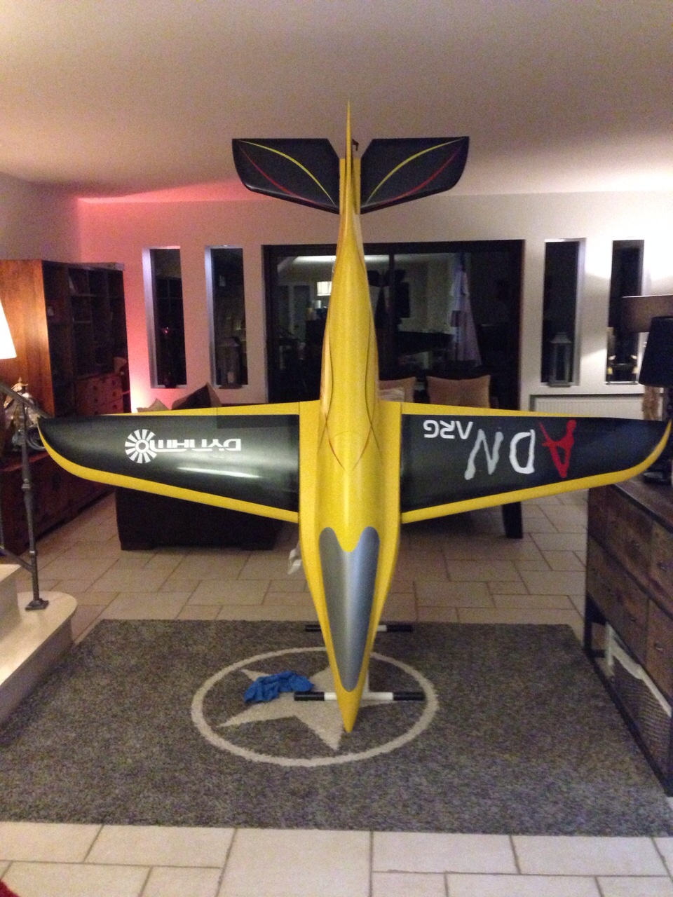

hello guys, some photos of the new version all carbon, grain weight (1.5 lbs) and more rigid ...
first take off within 15 days.
