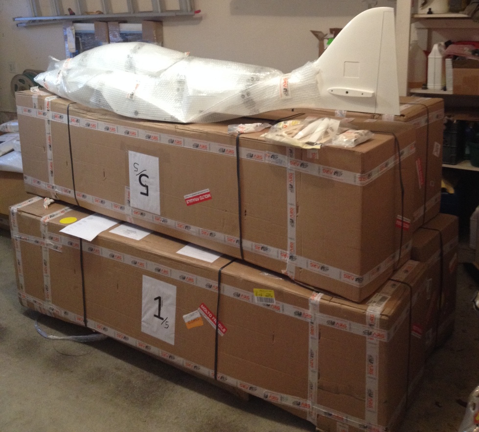

I just received the DYNAMO kits from Italy and I will be building one. I thought I would start a build thread on it.
The Dynamo is designed and built entirely by ARG in Italy to provide a good quality, full composite aerobatic jet trainer.
It is also very agile and a good advanced every day fun model. It is fully short grass field capable.
The fibreglass and wood are of very high quality and the formers are glued accurately and with proper glue joints, typical of European manufacturers.
Special attention was made to the flying surfaces profiles and composite construction.
The jet is very light, with a low wing loading of just 170 gr/dm2, that allows a takeoff from asphalt and from grass within 30 meters (100ft).
The Dynamo is designed to use 80~100N platforms.
The Dynamo is the perfect choice to become part of this wonderful world of RC Jet flying.

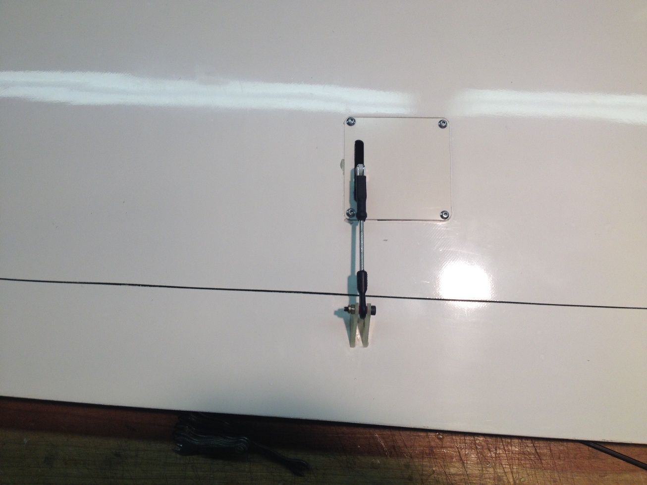

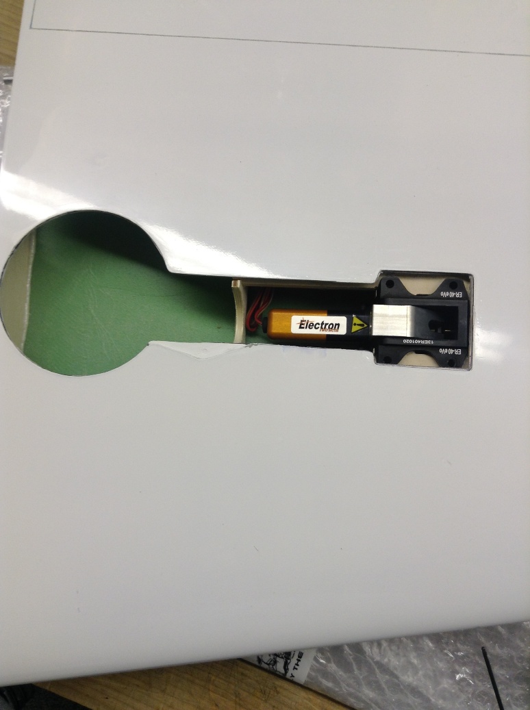

Did not get a chance to update yesterday, so here it is.
The Aileron and retracts skins need to be cut, they are marked so it is very easy to do and only takes few minutes. You need to also cut a 40x20mm hatch to access the Flap servo area.
Next install the flap servo, control arms then retracts.

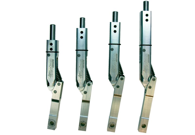

You can cut the access hatch approx. 245mm from the leading edge, also the 40mm x 20mm is an approximate dimension.
It is not really too crucial to be exact here with dimensions since this is an access hatch only and will be used as an exit hatch for the leads as well.
I left the strut cutout straight on purpose, i have been testing which struts to use. They all fit and might require a slightly different cutout that's the reason I did not cut it. As it turns out the Behotec will be too heavy duty for this plane, the plane is lite and the struts will require too much weight to compress or a very heavy landing.
Electron struts as well as JetsMunt struts will work better, and they will be cheaper for the end user.
As a result, I have ordered the JetsMunt struts and as soon as they are here I will post some pictures.The Electron retract units fit perfectly and the mount is pre-drilled for them. Blind nuts and screws are supplied with the kit as well to bolt the Electrons down.

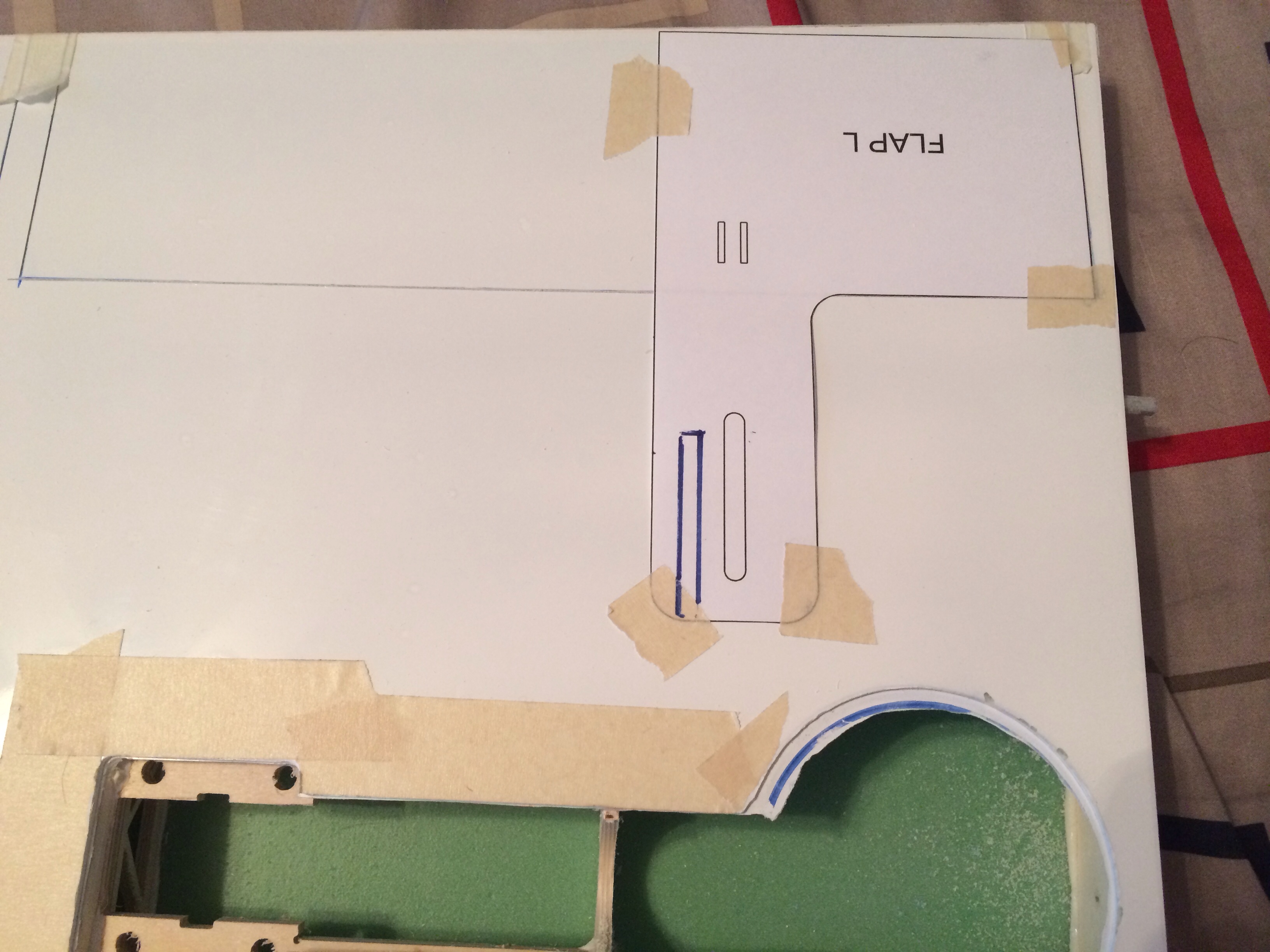

The template for the flap servo control arm does not appear to end up in the correct position. After placing servo in the wing rib, and template on wing. There was no way servo arm would hit it. Anyone else have this issue?
Old 12-09-2013 | 11:08 AM
My Feedback: (20)
Joined: Sep 2011
Posts: 59
From: Plattsburgh, NY
The 134mm from trailing edge and 116mm in from edge with cut out of 6mm centered from the 116mm mark and length of 50mm seems to hit the mark

Don't use their measurement.
They are using different servos.
Just measure it yourself.
I installed the servo with a short arm, rotated the arm until it dented the skin, then cut the slit.
ARG is using Graupner servos and although they have JR equivalent, a lot of them are not available in North America
Just use your own judgement.

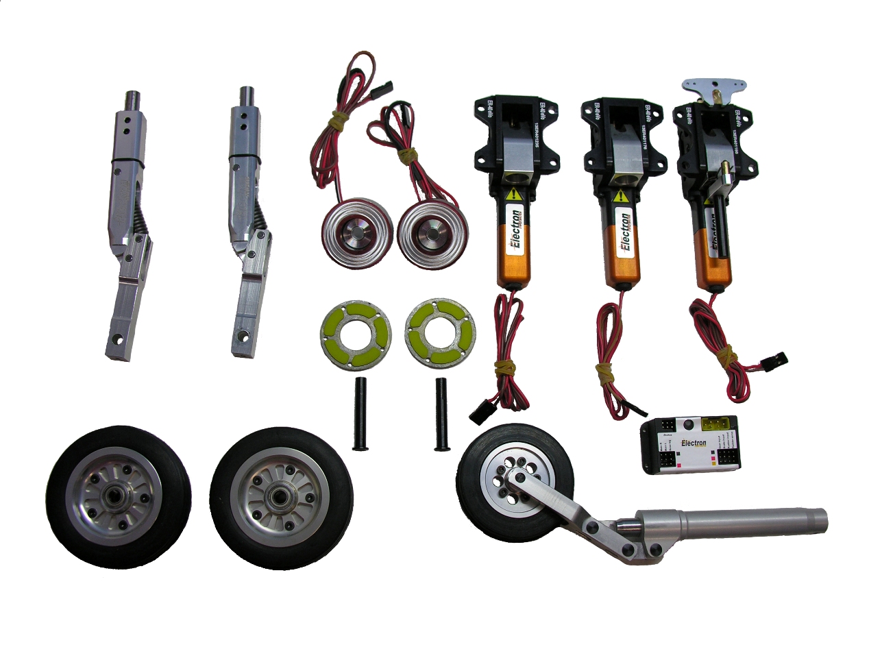

Electron based retract set, wheels and brakes are finally done, should be a few days before I have all the parts in my hands. Should be a drop fit.

My Feedback: (20)
Joined: Sep 2011
Posts: 59
Great let me know when in and I will place the order. They look nice.
