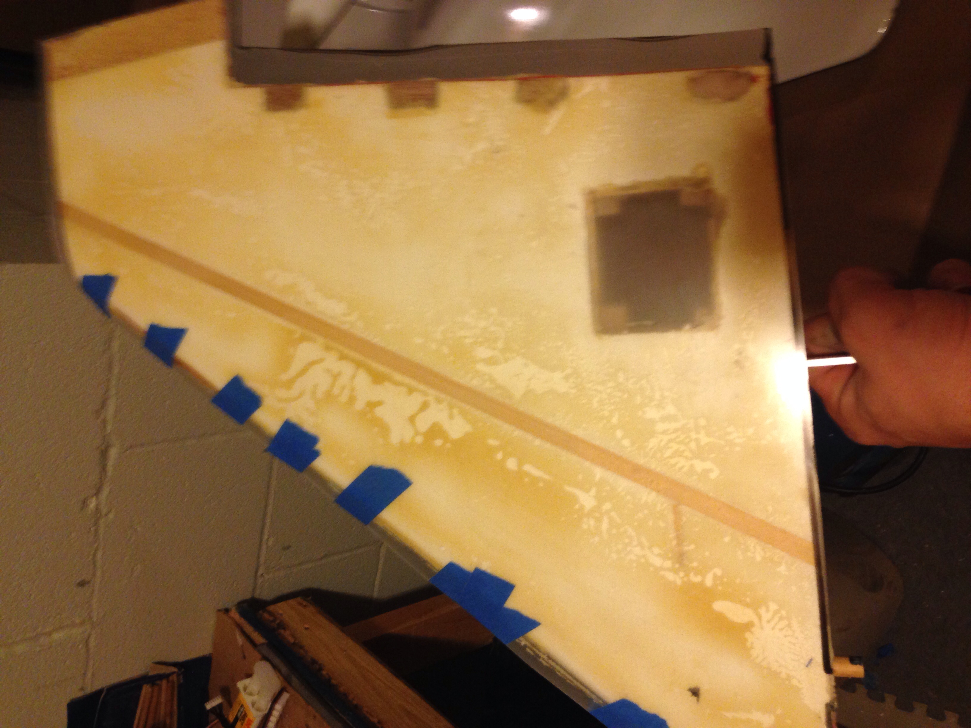

True but it's more fun this way, I'm wet sanding the rudder right now.
I added dee carbon fiber spar to the wings, then sheeted with flight skin
i got some nice carbon fiber coth to add inside the fuze

Pic

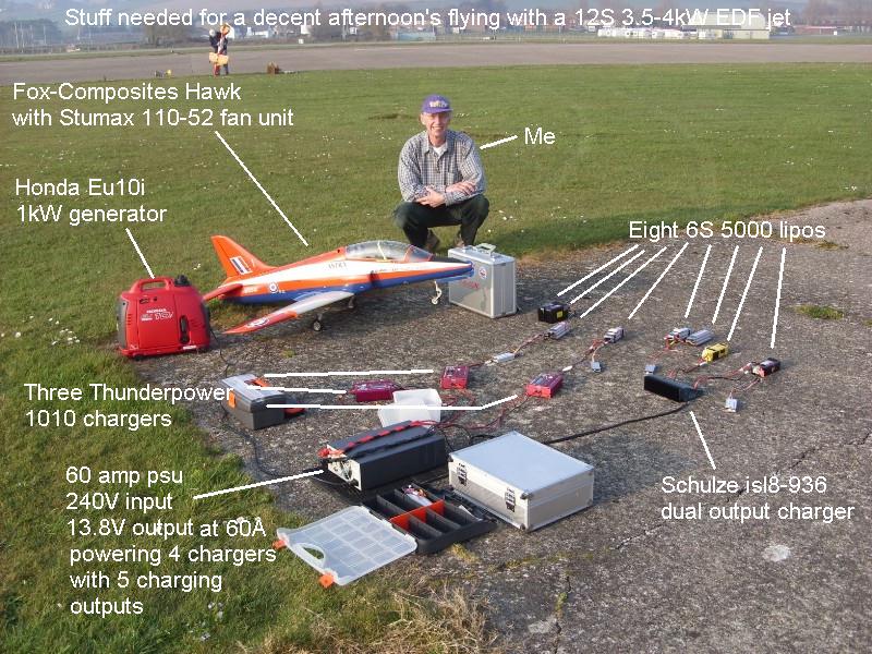

yep, and no generator running in the pits all day to charge the packs that are gonna last 5 min MAX!

True! Here's a pic of me about 3 1/2 years ago just before I saw sense and replaced the EDF setup with a Wren 44 Gold. The jet now takes off 1lb lighter and lands around 3lb lighter than it did as an EDF, Plus it's cheaper to run, and there's no worry regarding the aggressive throttle management needed to protect lipos, esc and motor of an EDF setup.
