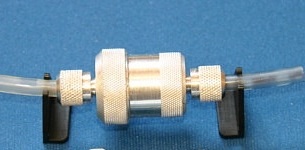

I went to install a new Jetcat style filter in the Kingcat I picked up. Opened the filter to lube the o-ring and seal it up to find the o-ring missing!
Anybody have a o-ring part number or source?

Picture of filter

May just give you the measures: 16mm outside diameter and 12mm inside, so 2mm thick.

I did found one in ACE hardware store.

Ok. Thanks for the dimensions and suggestions. I should be able to find something. I figured it would be metric.
