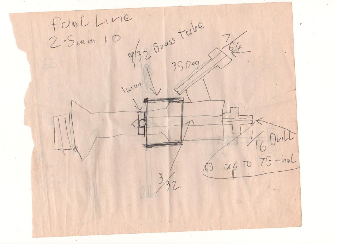

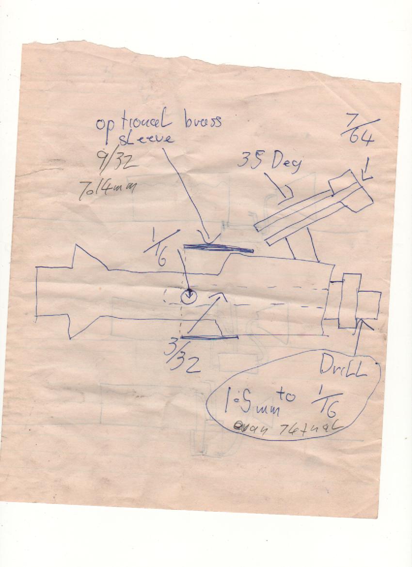

I Chris did not have anything to do with this Pulse jet (fun Jet) set up.But I can give some advice perhaps.The stock Flowjector is the hart of the problems with Dyna Type jets.Bailey Pulse Jets solved all this but unfortunately he is no longer around.You can do a Cheep fix on a stock Hobbyking Pulse Jet easy.These two photos are a way to do it.These set ups are for Methanol use as the basic fuel.Most add 20% Nitro to this to help starting and a dash more power.Methanol Fuel goes Very well with Dyna type Pulse Jets but it uses over Double the fuel content.It Protects the reeds by cooling and lubricating.
ID:	1995982   Click image for larger version

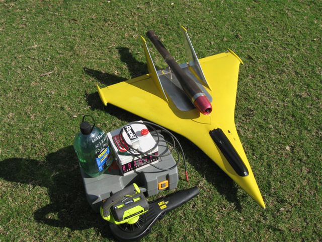

This is everything I need to go fly my RC INFERNO Pulse Jet.

Is that a rechargeable blower? Nice and compact.
Got my Doylejet somewhere around '86 or so. Very heavy head, with longitudinal fins versus radial. Nice looking engine, yes uses Dynajet reed and same performance.
I figure I'll have to get reeds cut locally for the 90mm engine, that's fine, I know a place as they say. Think I have three total.
Old 05-29-2014 | 07:52 AM
Yeah, nice blower, where did you get it ?

It's Ryobi so I will look in Home Depot. I have access to a buddy's gas blower but I want my own.

Bunnings Home hardware shop here in Perth WA sell these blowers.I started a Hobbyking pulse jet with it to once.It started easy but I had to force the fuel in by manual pressure at the air vent.

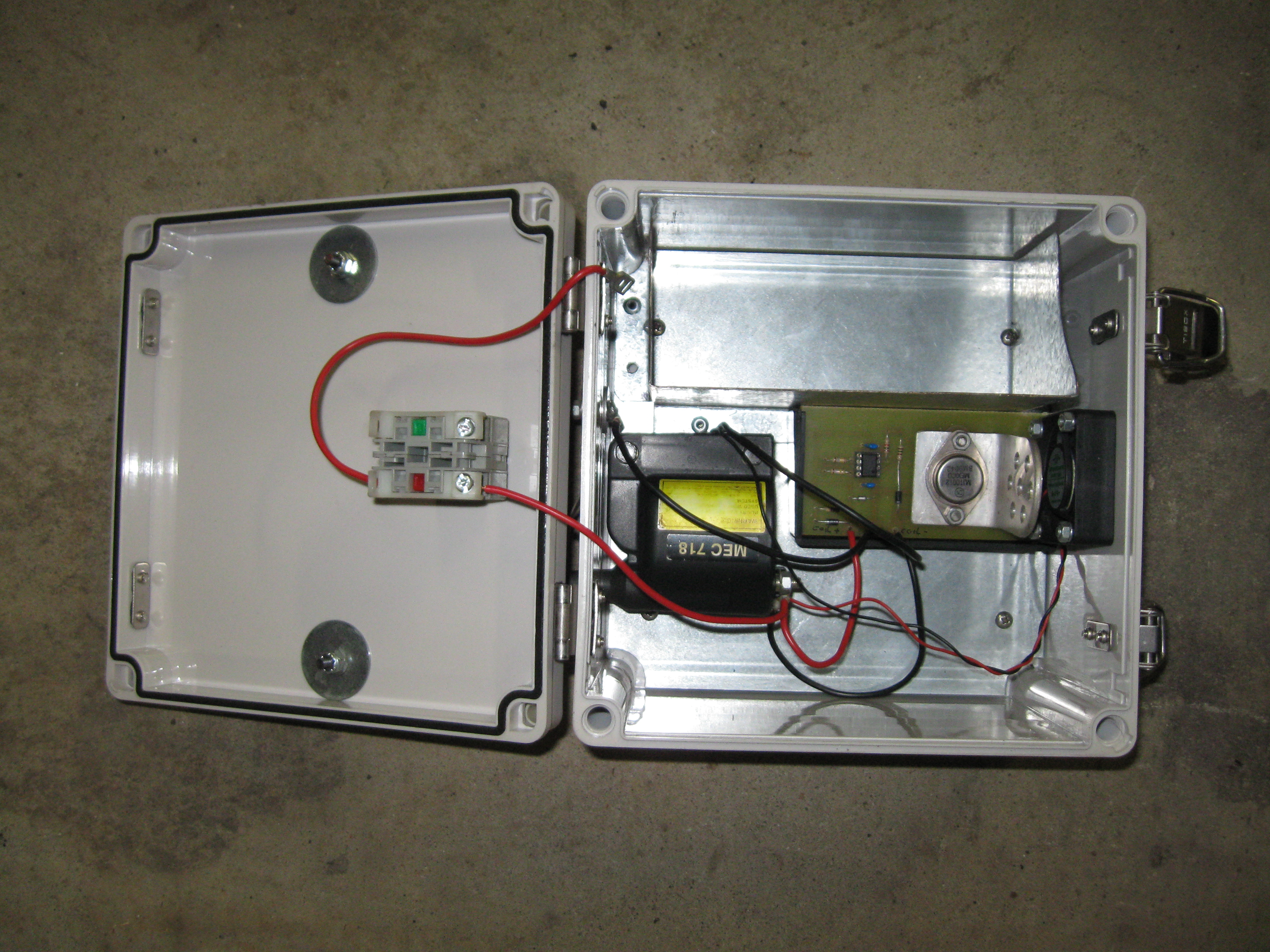

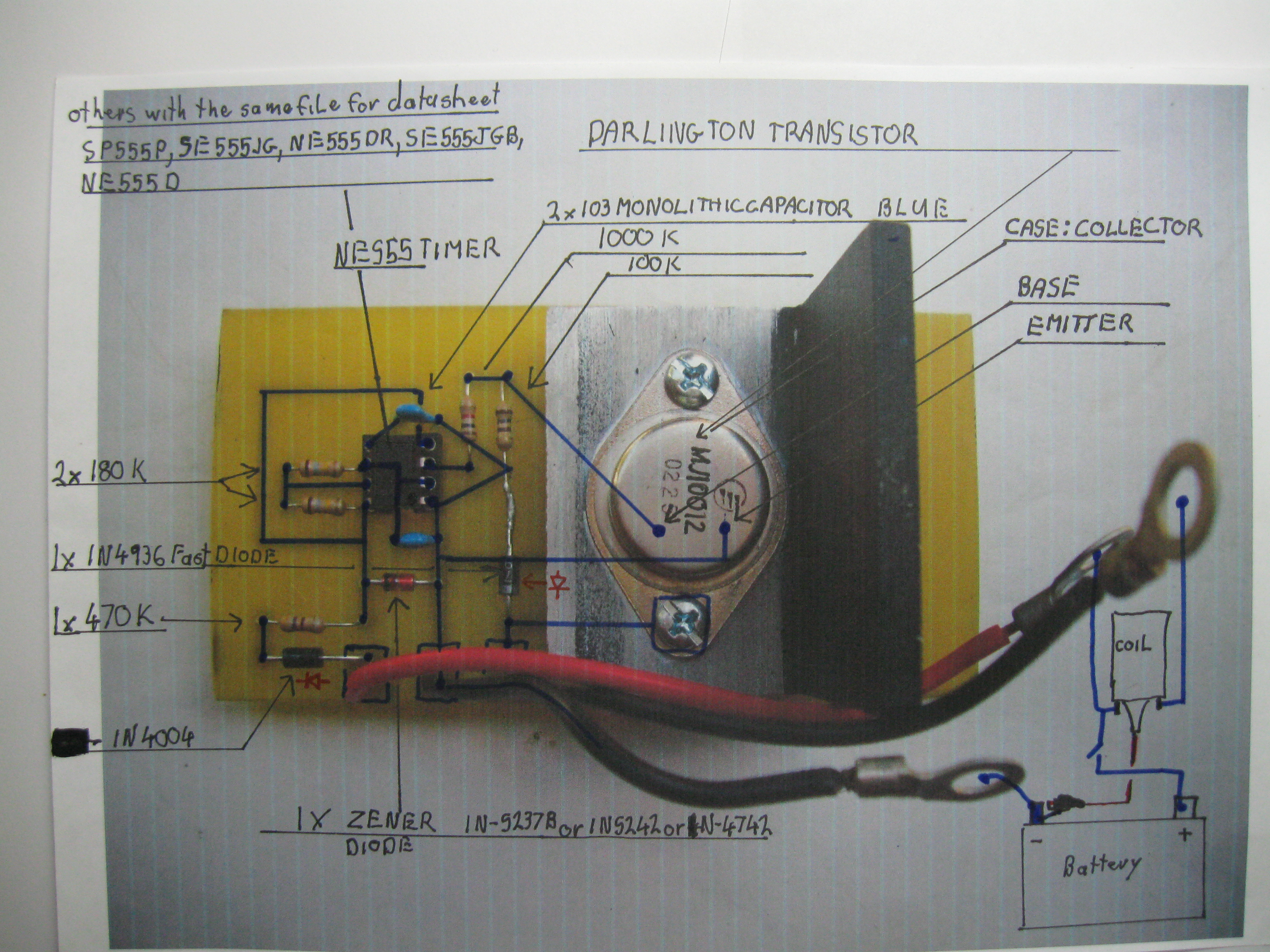

Posts: 37
From: Perth Western Australia, AUSTRALIA
As for anyone ever wanting to start a Pulse Jet in the air I myself would use this set up in the photo.This will fire up a 100% kerosene fueled er90 so its the most powerful Buzz box you could ever want.It could fit in the INFERNO but I dont think I need it really.I dont have much space as it is & I dont want electronic interference drama. This small coil is off a V8 car & is good for 50.000V & over 3 amps.They are prone to failing if you use copper leads on them & if the spark has no where to go.The electronic circuit you have to make your self but I have the planes if you can build this type of thing OK .Dont cost much to build & run car coils at 283HZ per sec.This makes the Spark Plug I use glow red in the center guarantying the er90 fire up instantly.I use old car can coils (with no ballast resistor)in buzz boxes now as they never fail.Most use Ford T coils for starting Dyna jets.
ID:	2000153   Click image for larger version

Blowers are great for pumped fuel systems but yeah, with a flowjector it's not the kind of air flow you need. I have an HV module from neon running lights that is fairly compact and provides a healthy spark. But at this point I am not planning in air restarts.. maybe for the Reichenberg I'd like to eventually build.
