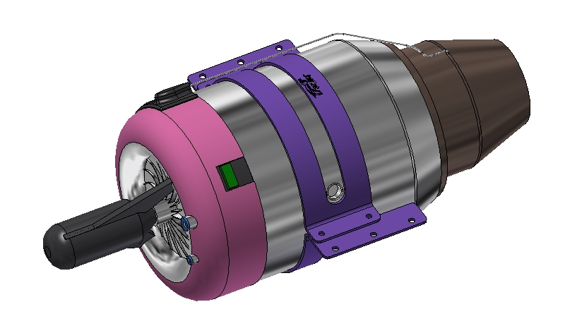

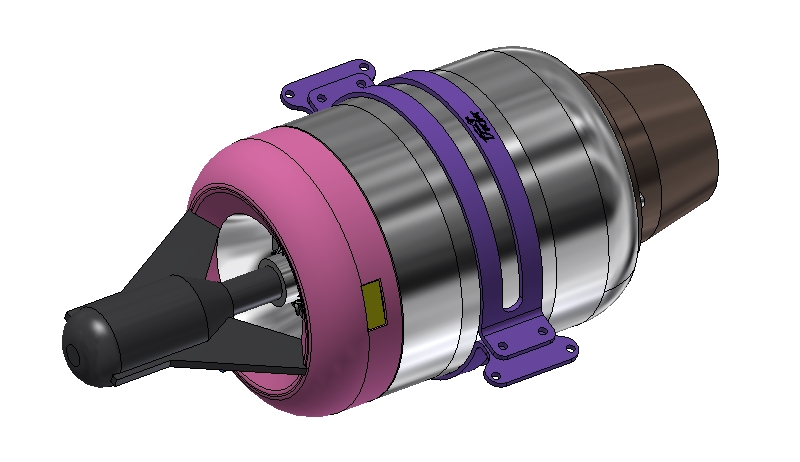

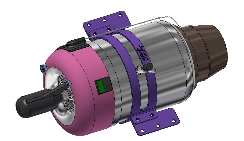

Very nice Henke. Did not think of 3D-print when I made these:
P100Rx, P160-SE, P160-SX and P200-SX with brackets.
The outer dimensions are to scale. Compressor and inner just for illustration )
Should any of you guys want to make a 3D-print of one of these, please post a note about it and I will send the STL-files. I could make it as Step-files too, should you want to make some modifications, disable brackets ets.
Feel free to ask, I'm not associated to JetCAT, just made the models from my own turbines for fun ( and some friends here that needed bracket holes and contours. )
And yes, they are free of charge :-) ( that we like )
regards and safe flying / happy building.
Lars
