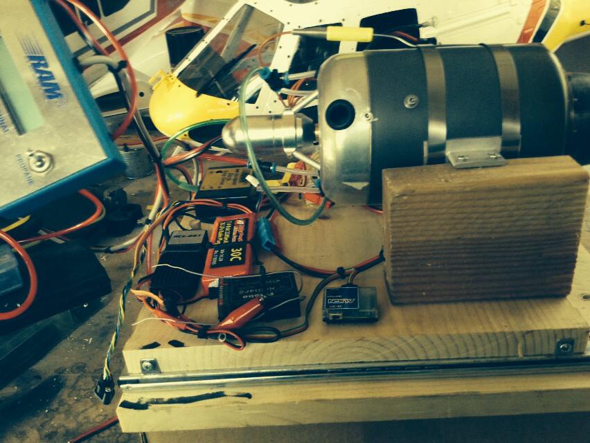

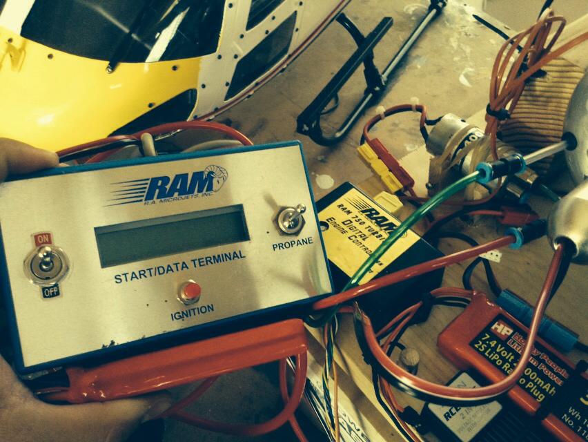

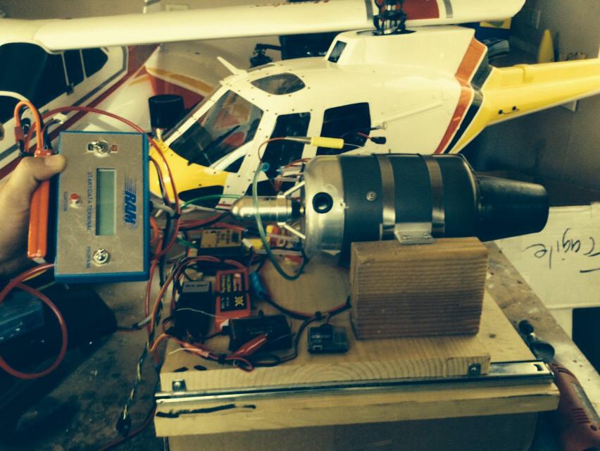

Hi guys
i have problem with my ram 750 turbine, it does not want to make the propane combustion.after awhile i cheked all the connections and spark plug. I think the internal gas line might be pluged. If any one knows how to unplug the gas line without take apart the turbine please let me know. Or a diagram of the internal gas pipe. Thank you

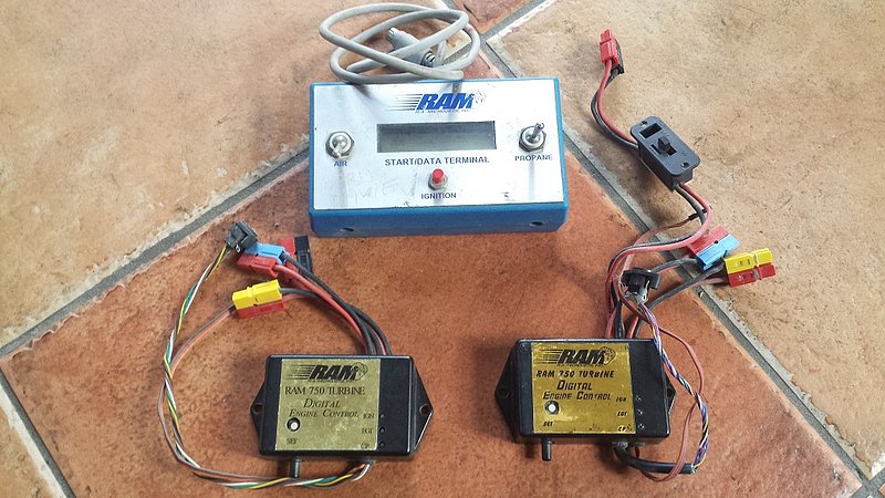

Originally Posted by NUNU
Also double check your rpm reading on startup..if it does not look quite right then the trick for that is to take a magnet and bring it in close proximity to the rpm sensor....to "defrag" the sensor (not sure if this is the correct term btw...but it does work)
Hey Nu I think he have the very old style ecu first design for airstart Ram 750 and use case pressure fuel tubing to control the pump speed. I think I have one somewhere but not sure if its good.
P.S
I would get rid of that old ECU and buy a conversion set from Bob Price or Xicoy..but you have to change the starter nut for one with built-in magnet.

Hi, I have replaced the scuba tank for an electric starter as suggested by one of the users in the forum and it works good and the throttle commands work properly. I can get the turbine to start with the propane but the fuel pump doesn´t send the fuel to the turbine to keep it running. on the start box it show the word "running".
