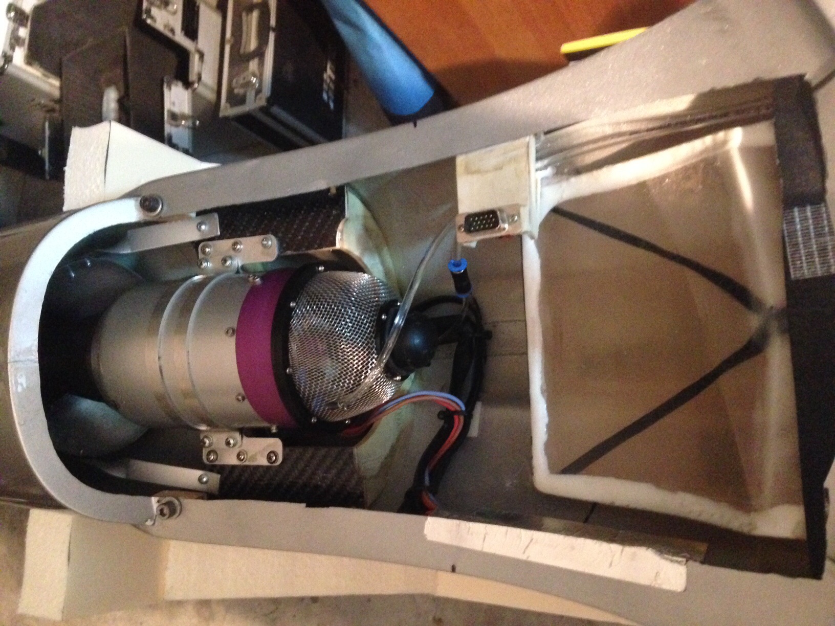

I made no provisional tests by installing all components on board and I understand that I can install the batteries in the nose by shortening the exhaust duct of 4 cm, soon I'll post some pics showing the turbine mounts

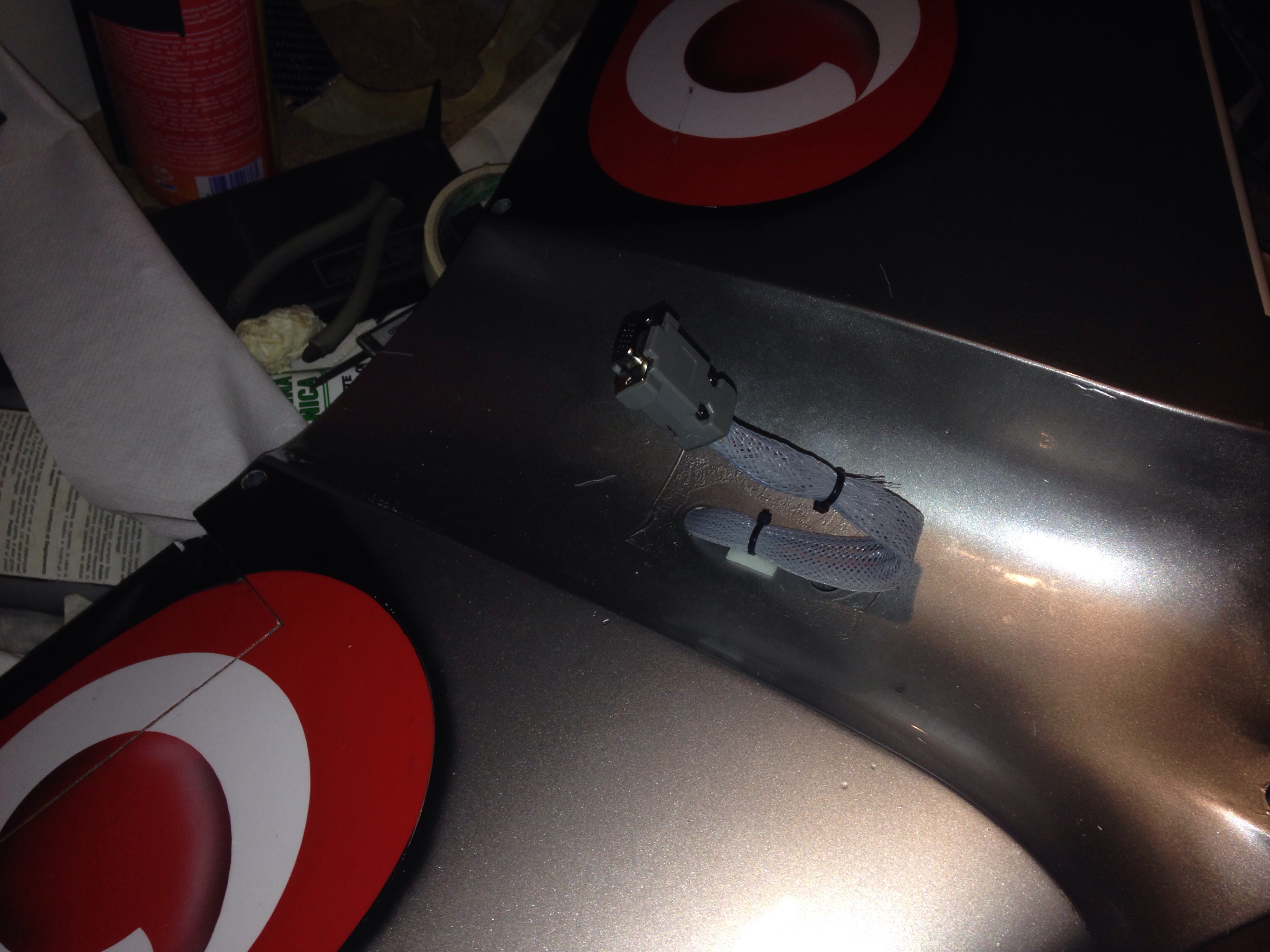

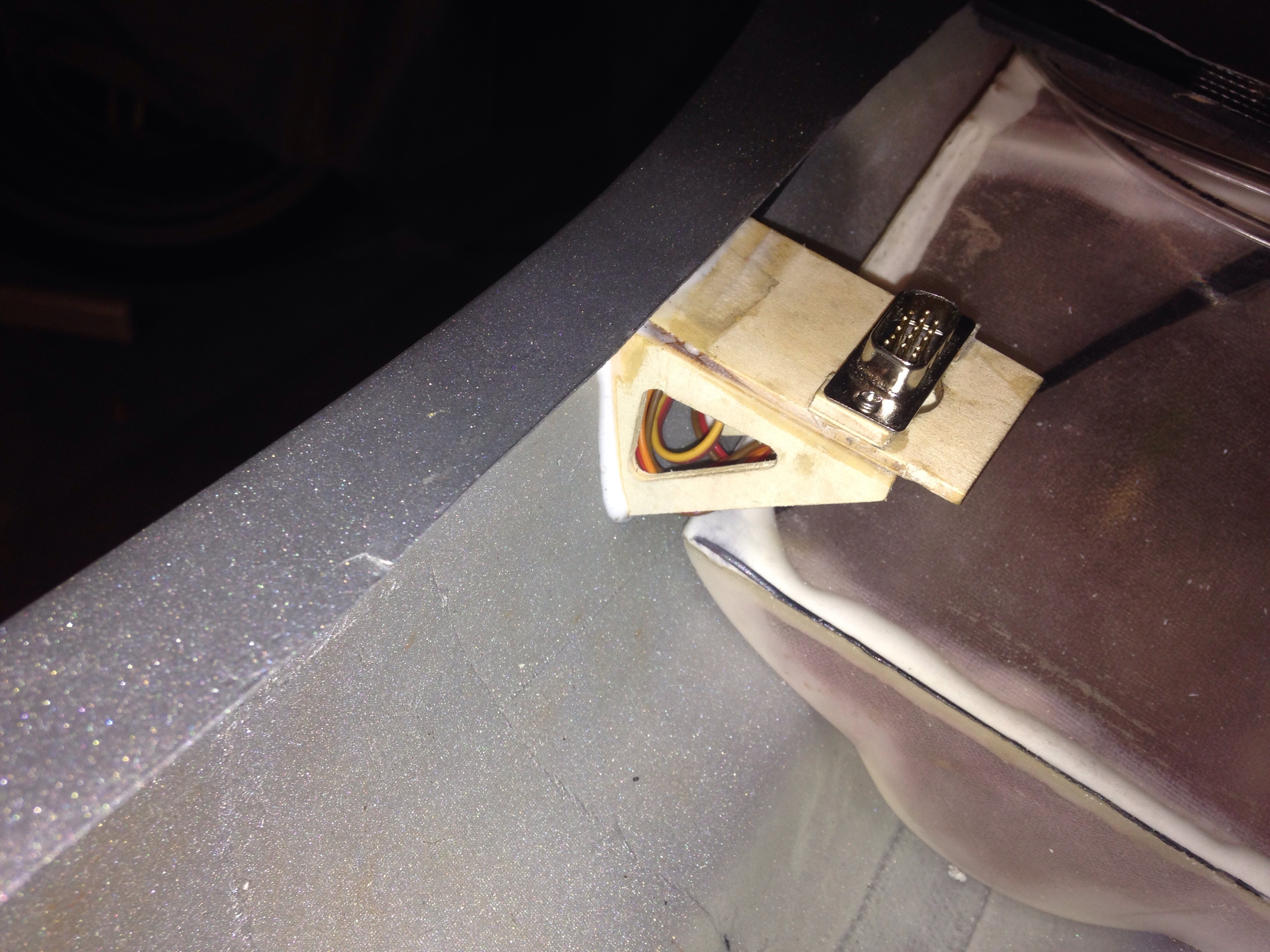

I decided to change the way to connect the wing servos to the rx using a pair of 15-pin computer connectors . Now the link is more quickly and safely ..... I hope

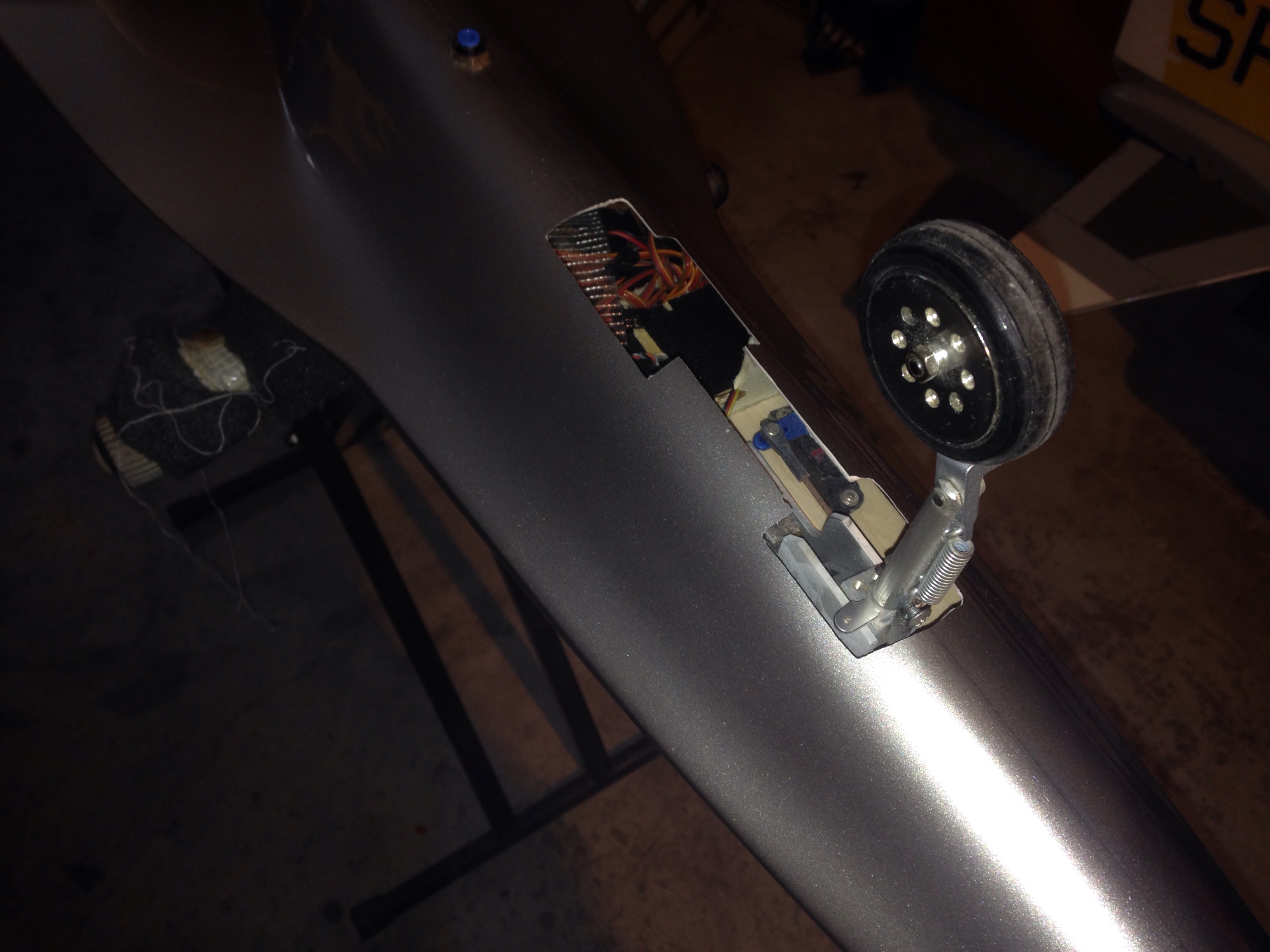

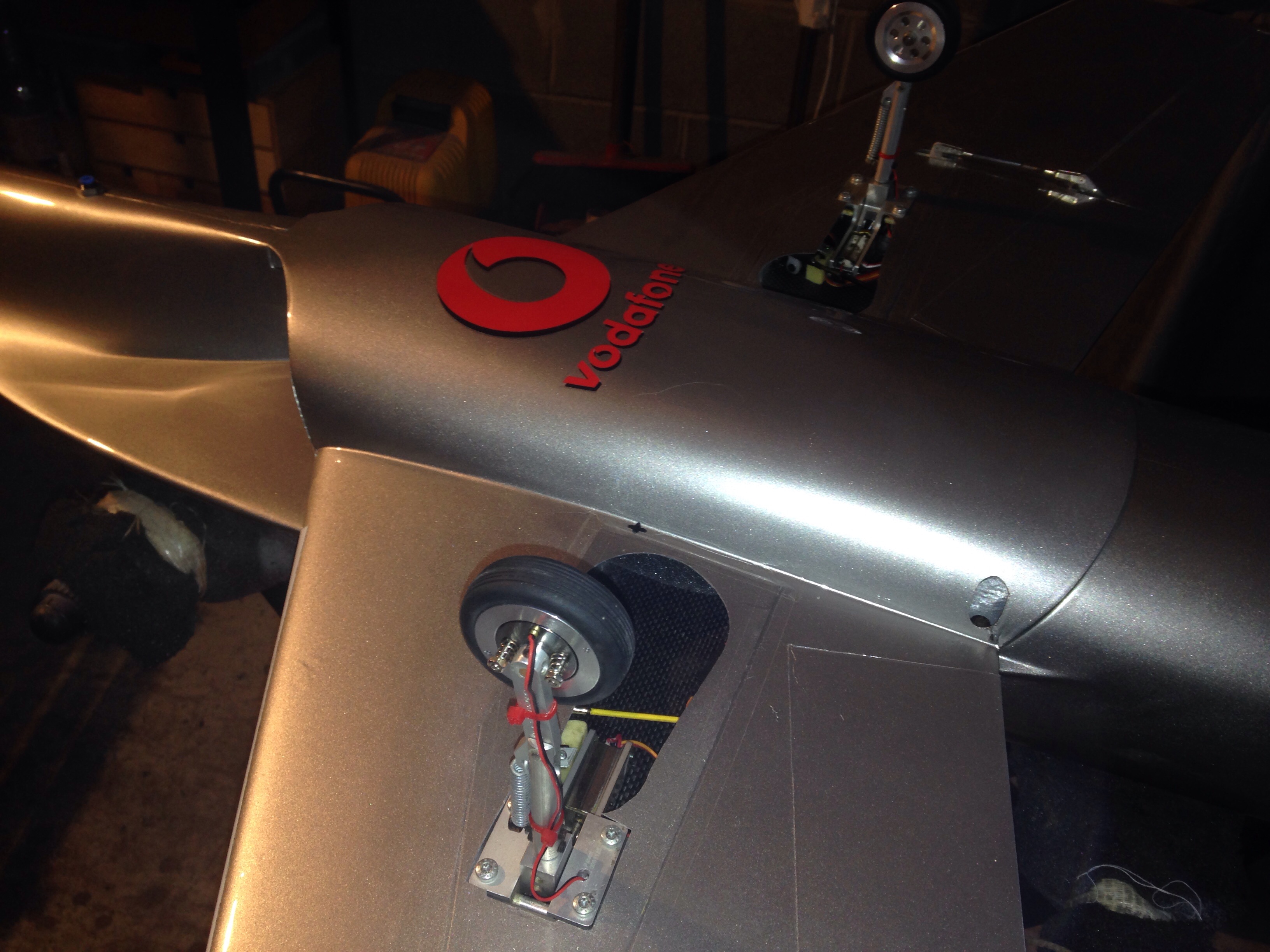

Landing gear detail. E.flite .120, tornado 55mm whells with magnetic brakes, tamjets legs with 6mm axel

From: Livorno, ITALY

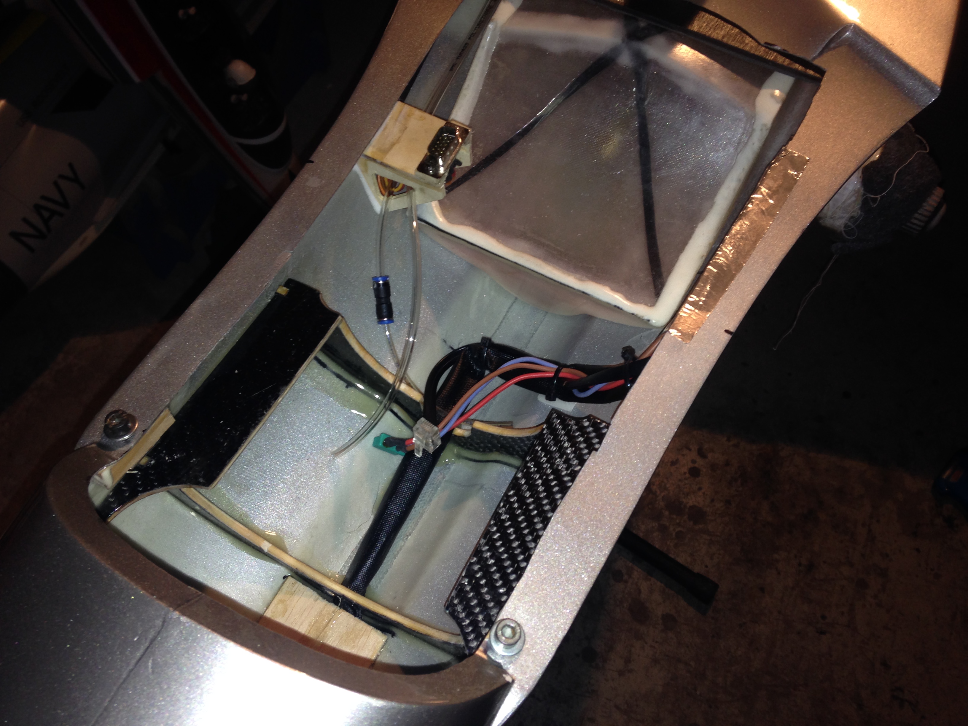

turbine mount ready to fit engine and exhaust pipe

From: Dublin, IRELAND
Very neat and tidy! you might want to look at some kind of locking mechanism for that wing connector though. The push pins from computers can get loose after a few times of connecting and disconnecting..
I agree with what you say ... Fortunately the plane is small enough and I have no need to disassemble the wing for transport.....

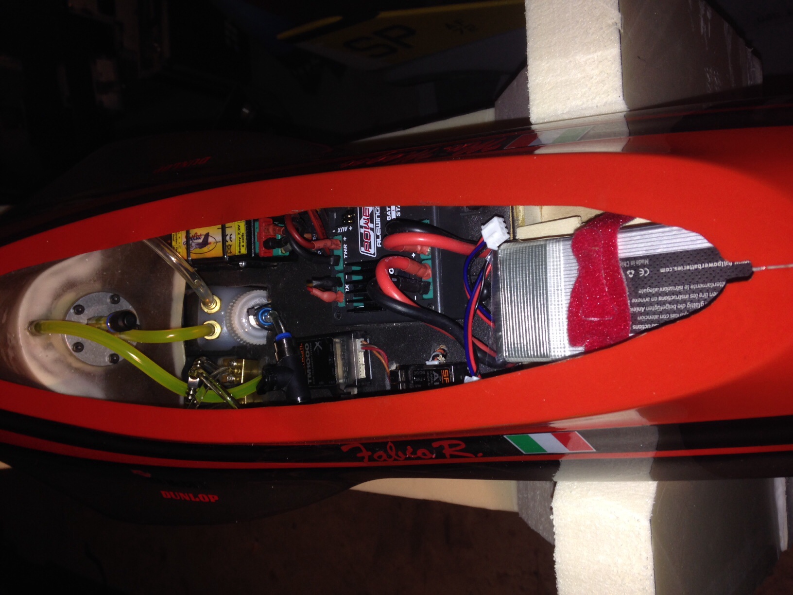

Finally the work is finished. Total weight with batteries but without fuel it's 5, 8 kg. Now I just need a weekend without rain for maiden flight
