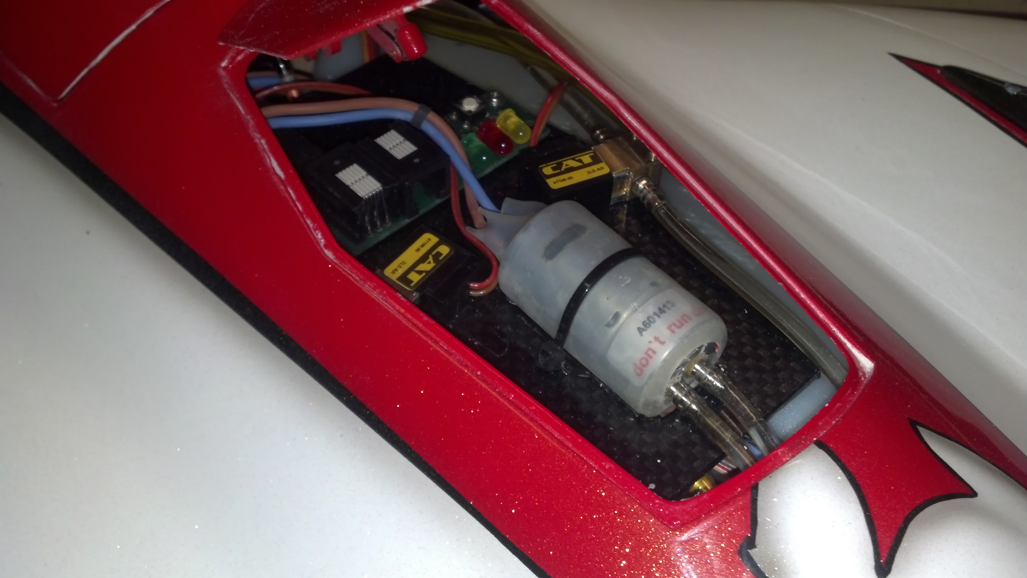

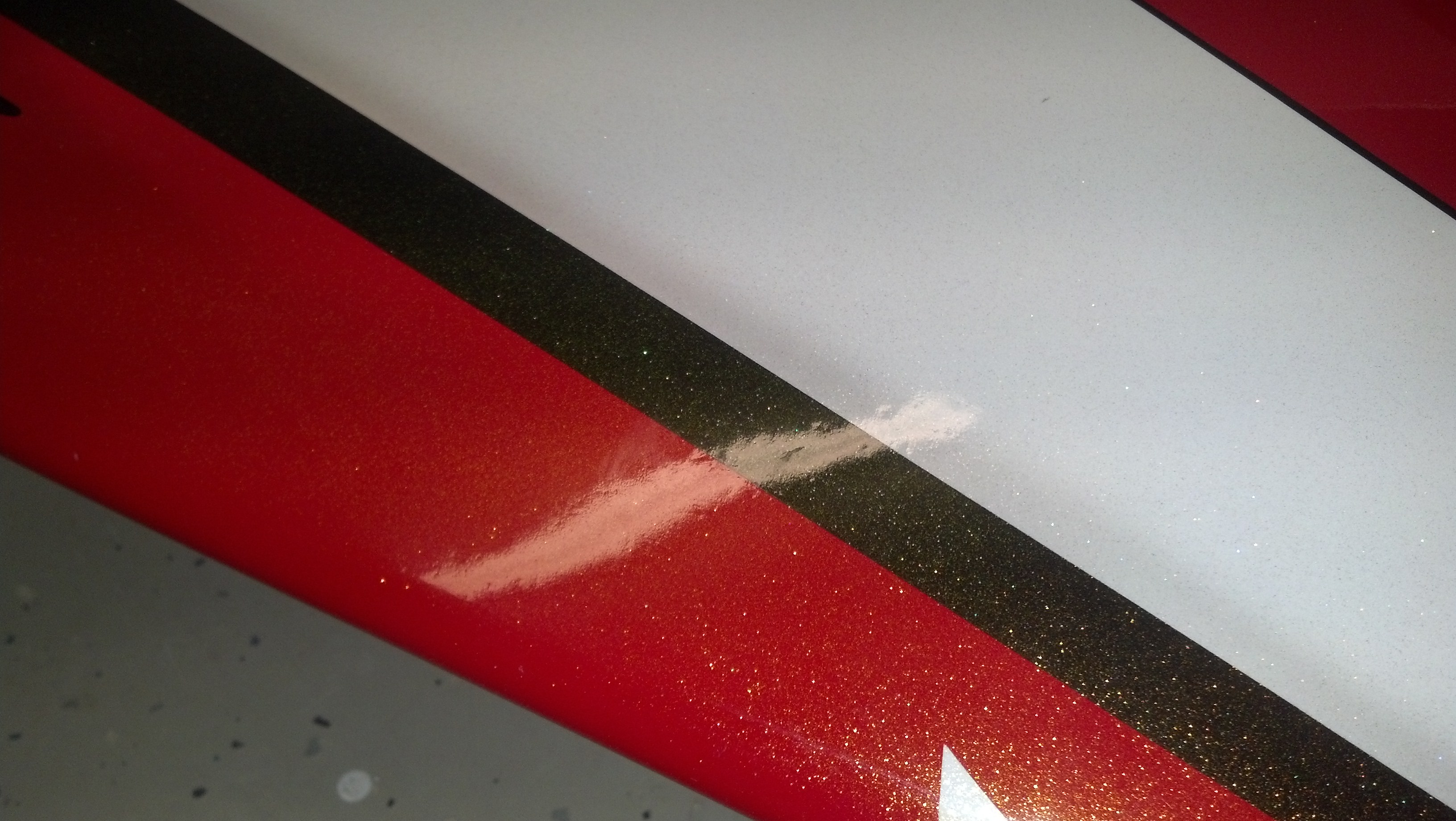

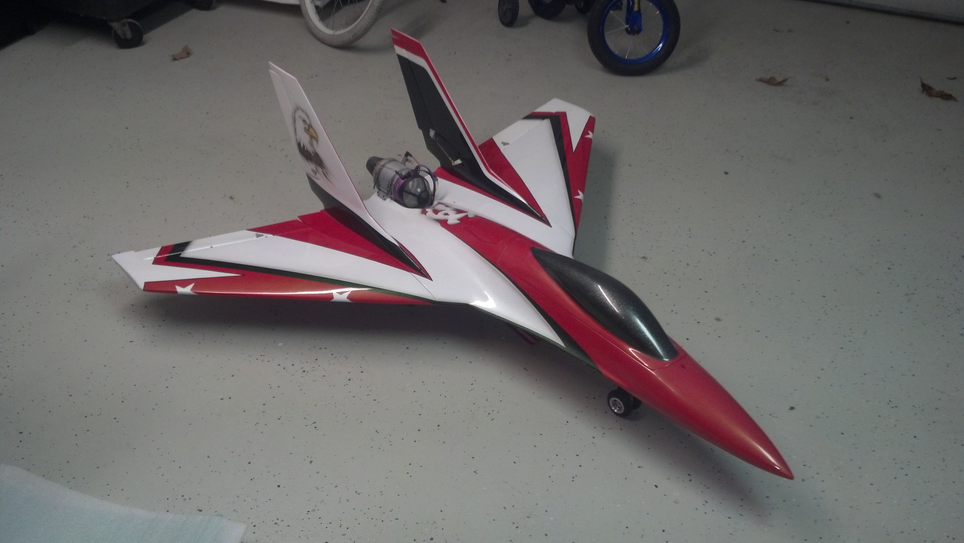

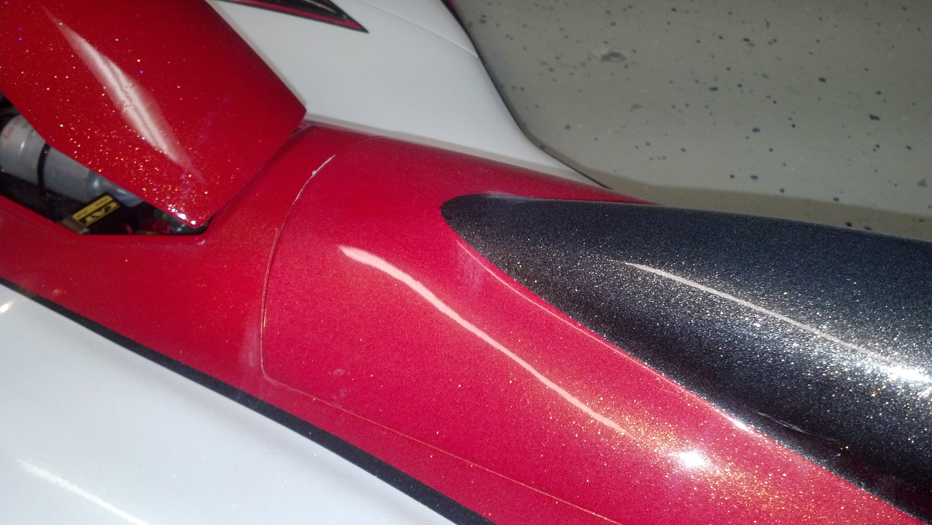

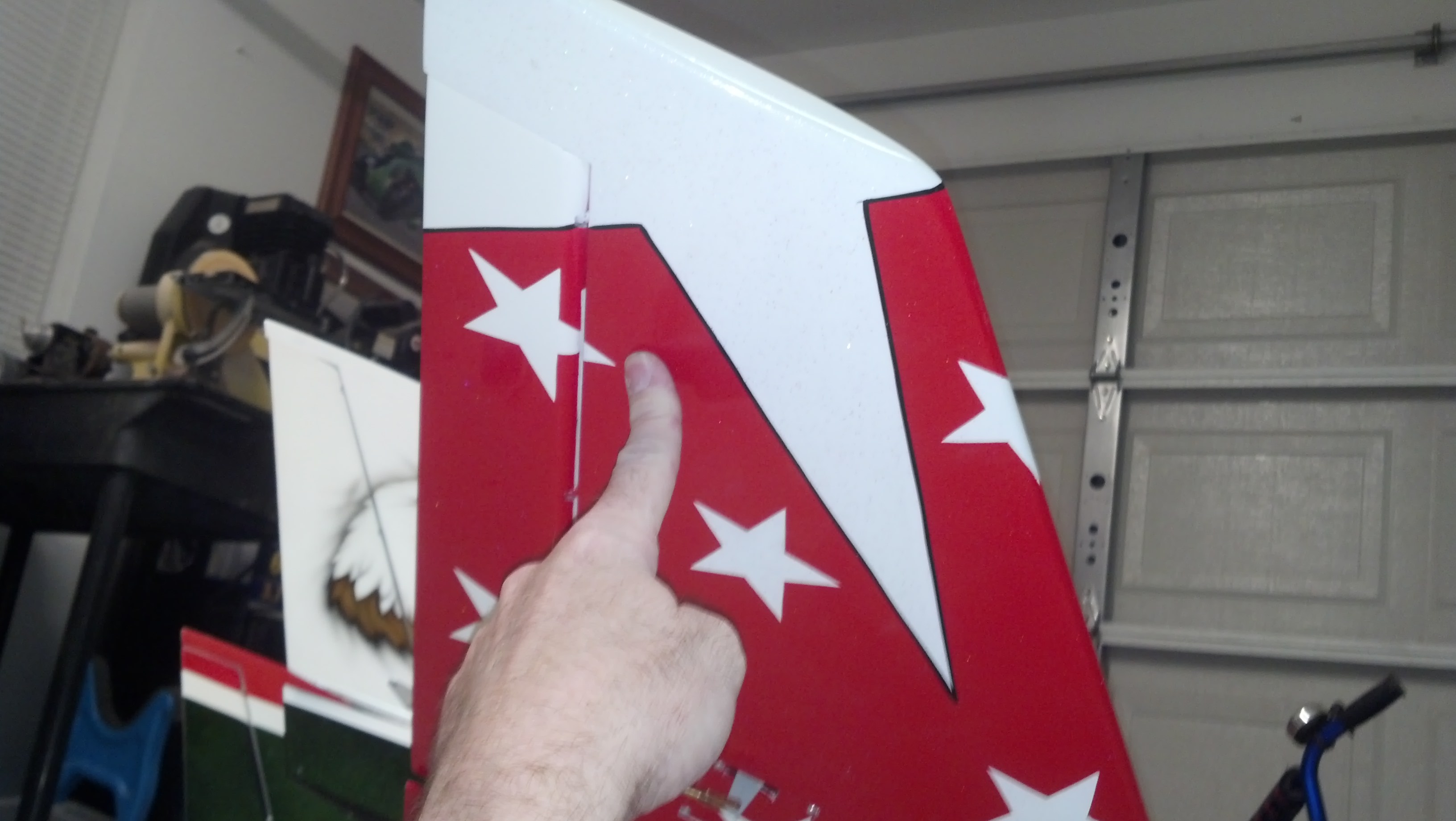

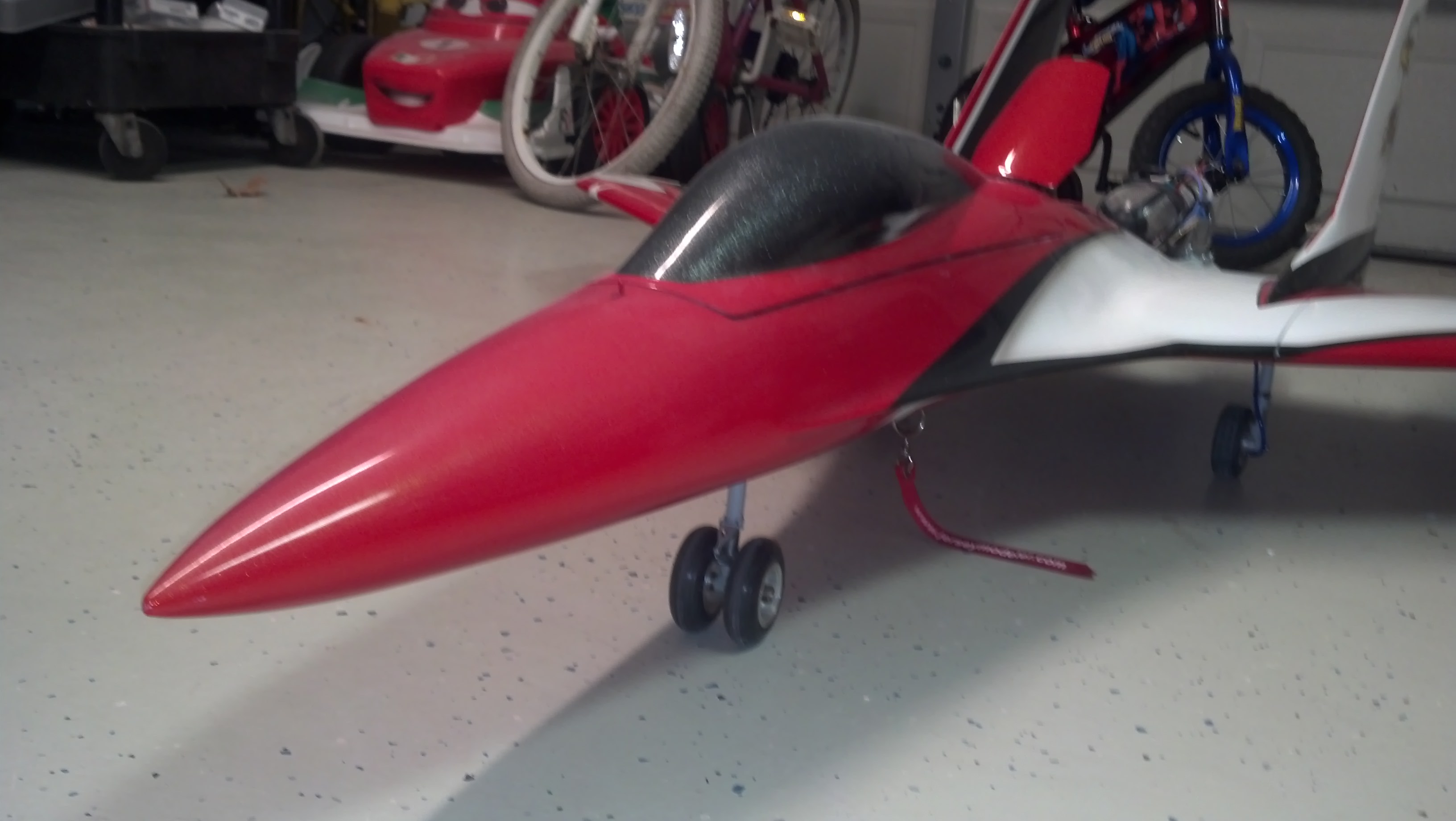

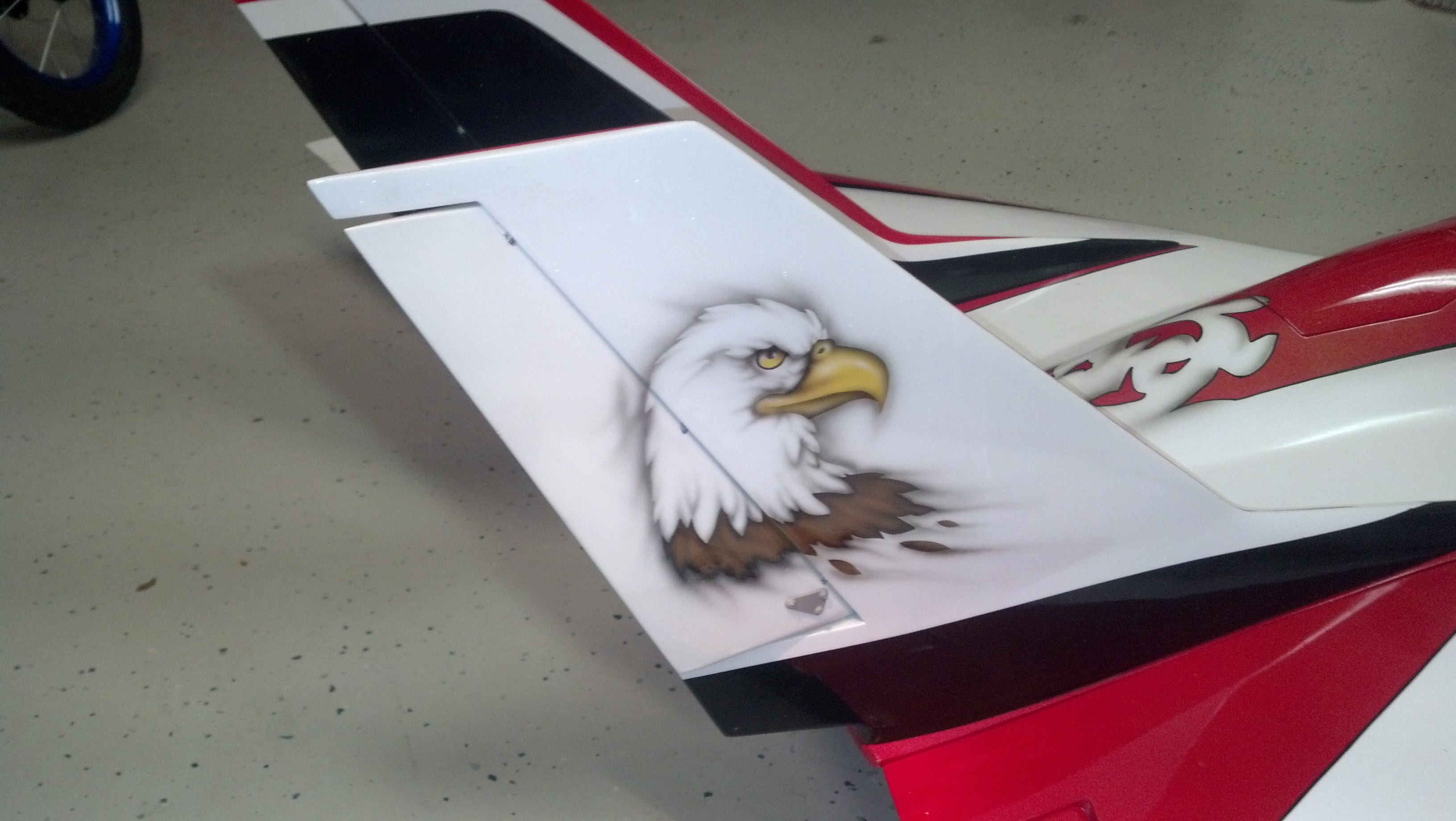

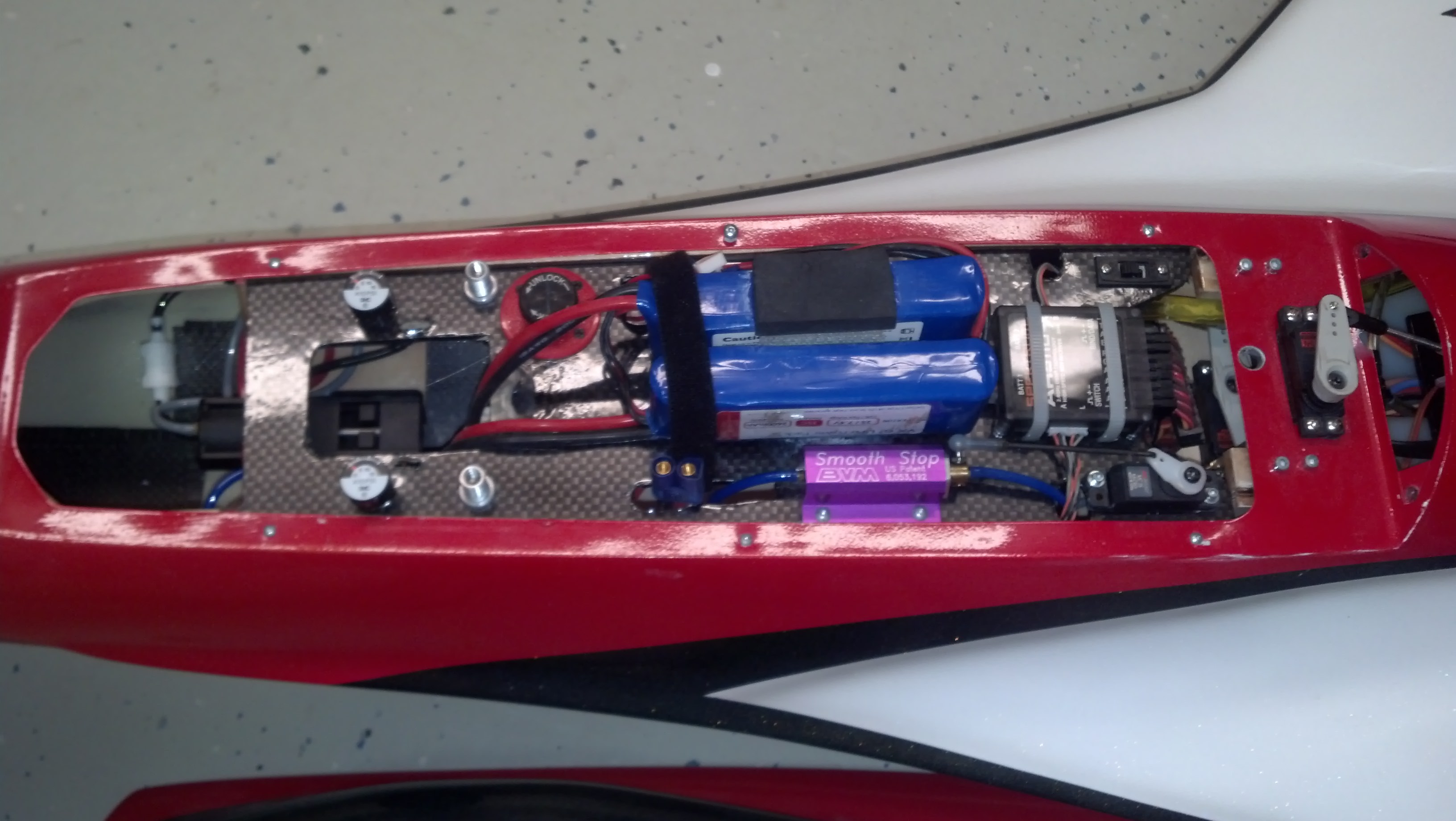

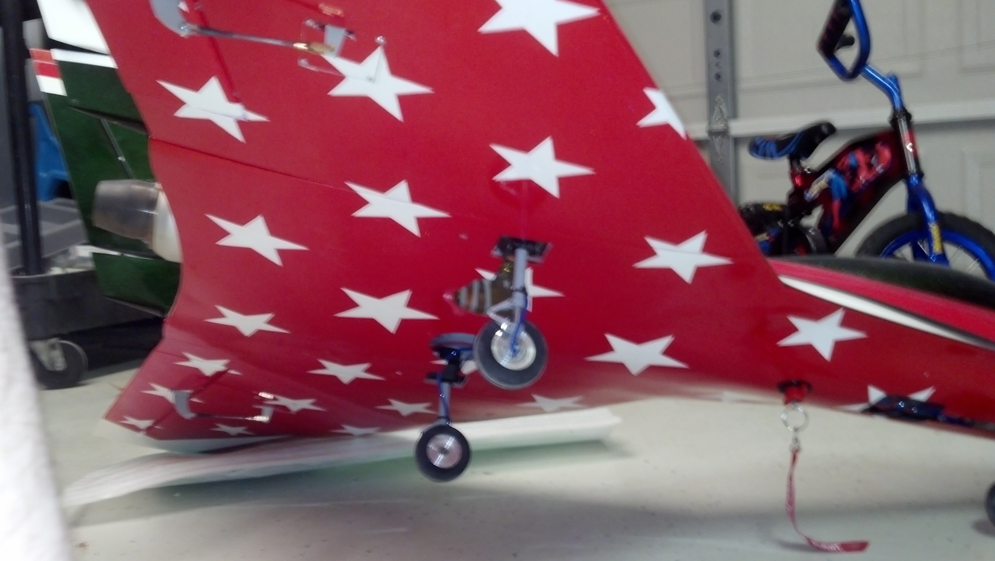

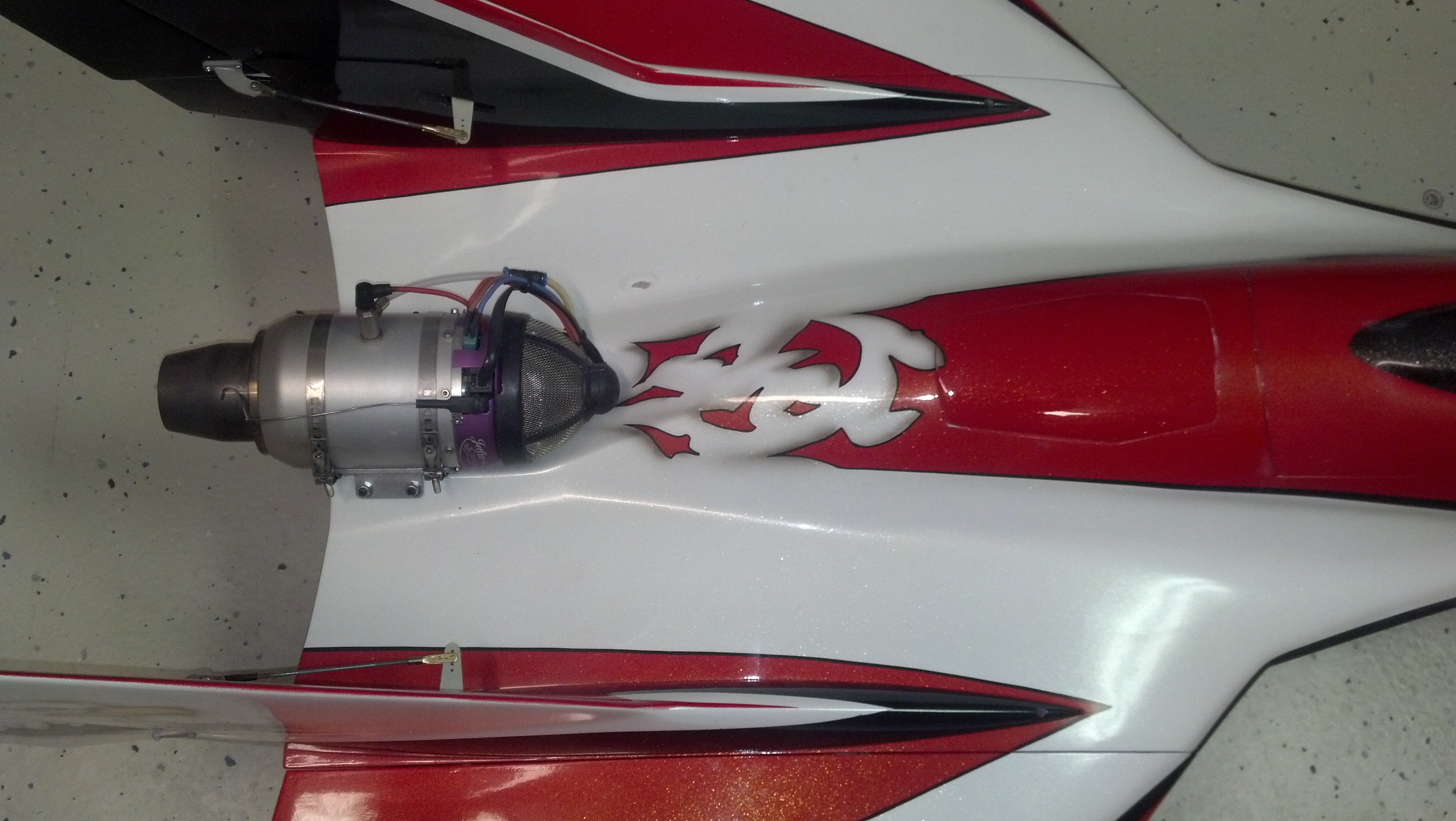

I drug my feet on this project long enough, so I finally decided to put the finishing touches on her. Built this one for a friend. He let me design the scheme, and trusted me when I said "I want LOTS of flake". The eagle heads were requested by the owner after seeing what Kenny did with my Starfire. I have enjoyed taking a break from painting for a while, so I let him do the last 2 planes. This thing is beautiful in the sun. All colors have color change properties. I like stuff that's different hence the paint being sucked into the turbine and the duel front wheels. Top and bottom are pretty drastically different and red and white are one of the best color combo's in my opinion. Power is the good old P60. Just figured I'd post something a little different for ya'll.

Nice to see these still being built, nice paint job and im sure it will be a pocket rocket with the P60.
One thing i noticed is one of your rudder control rods locates to the end of the servo horn and the other is closer in. if i was you id bring them both closer to the servo to get more torque as i don't think you'll need much movement on the rudders, anyway. Good luck.

The painter hooked the pushrods back up after doing some repair work to the rudders ( had some yellowing only on rudders). Will set everything back up when I have his radio in hand.

Yeah, I used much bigger horns on the rudders. So little throw is necessary and for its speed, the rudders are big (plus the geometry isn't ideal). The thing I like most about this jet is on a P-60, you can see the ridiculous acceleration when you go hammer down. Goes from MCAS to 199mph in three seconds!

DS3711HV's on 2S lipo. Not a problem for these servos. These are the recommended horns also.
