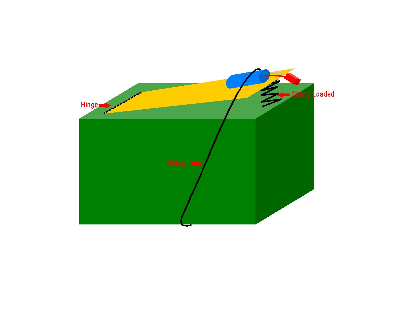

I think what is needed is one of these aimed at an open window:
