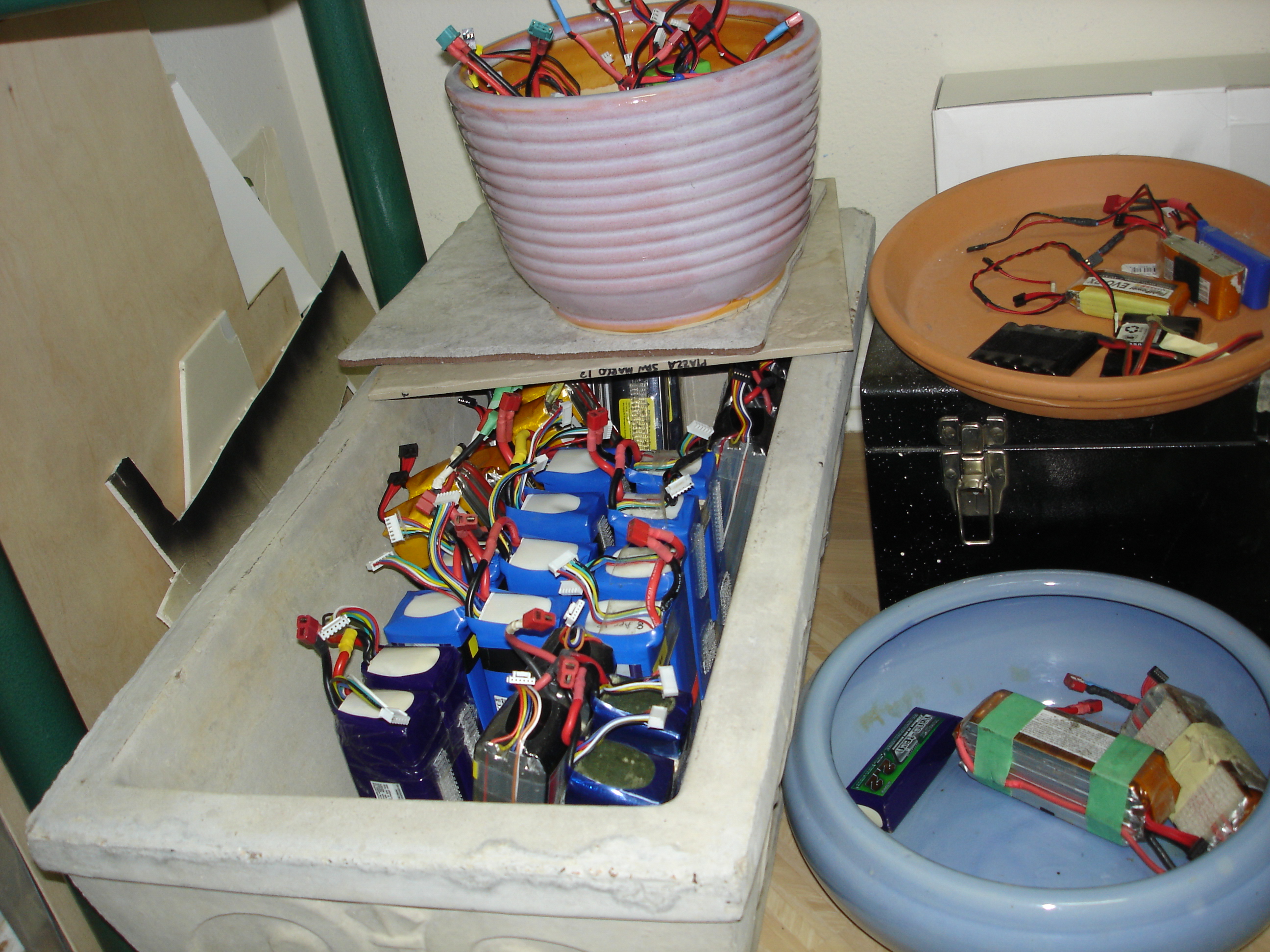

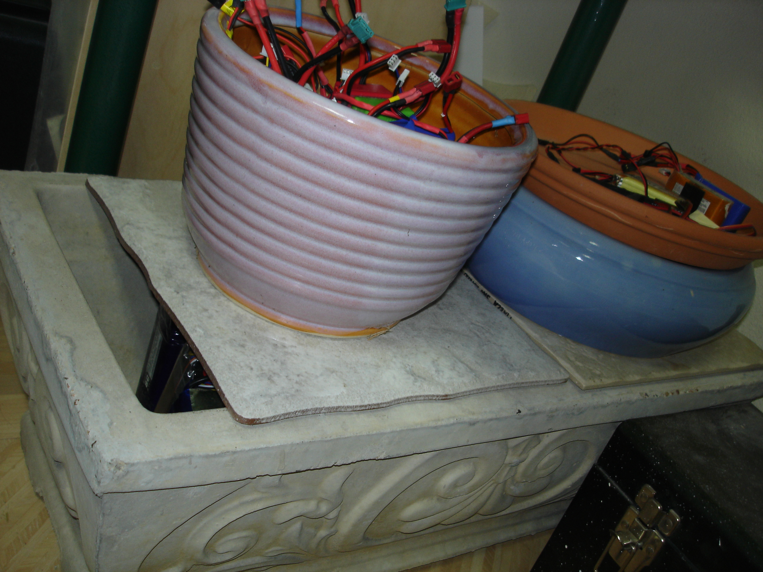

In case anybody is wondering, CO2 does nothing for a lipo fire. Been there. Probably the best is to drop it in water of enough volume to cool it down.
Heavy ceramic pots are the best for storage. We had a local guy who made fireplaces out of ceramic that made a special pot for this.
After he burned his garage down...
Using LiPos in an electric plane is one thing but using a lipo next to JetA is a bad idea. Had one in a fully fueled Rookie go off by itself in my factory. Fortunately someone was there at the time and ran outside with it, cut the fuze open to remove the battery before it got to the plastic fuel tanks... The Lipos were from fongkong...
A123's for me.

The part that stays very hot for quite a while after the lithium burns off are the many layers of copper sheets used to build a cell. You can use water to cool this off after the chemical fire has finished, just as the FAA document suggests. What they dont say is how bad the fumes and smoke are. You cannot approach a lithium fire without breathing equipment safely. Even after the event the smell will take your breath away its very intense. If your standing upwind of a pack on fire your ok and you can respond to the fire no problem in an out door situation.
If a pack is having a total failure and all cells are puffed the pack will expand significantly. A 3-4mm thick cell can become 10mm or more in seconds. Multiply that by 3/4/5 cells and the pack will take up a lot of space in a container very quickly. The volume of the container should be ample enough to account for the packs potential physical size and its potential energy. A box measuring 9x6x4 inches can handle a single 3S 3000mah pack failure or any combination of capacity and voltage not to exceed 60 Watt Hours. Above this rating the container must be larger or the pressure inside will cause the container to explode. The container cannot be air tight or it will explode due to expanding gases. This is tried and tested by myself and I have destroyed many packs of all sizes in the pursuit of this info.
Storing a couple, three, packs in one container capable of withstanding the failure of all the packs it is storing is OK. Exceeding the capacity of the container will potentially result in an explosion.
