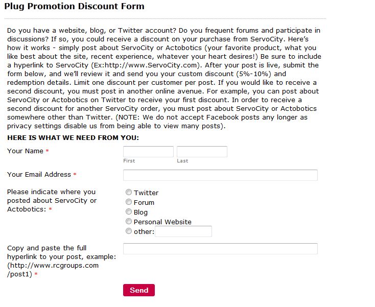

Here is a tip for your guys in case you didn't know....
By posting my post above with the link to servo city, they gave me 10% off my order of servos I just placed...
So the great price of $93.99 for the HS-7955TG just got better at $84.59 Ea, I don't know where you can find a better deal!
All you need to do is post something in a form or other social media and provide the link, a bit later they will e-mail you a discount code.
Here is the servo city link to sign up for the discount
http://www.servocity.com/html/promotions.html
