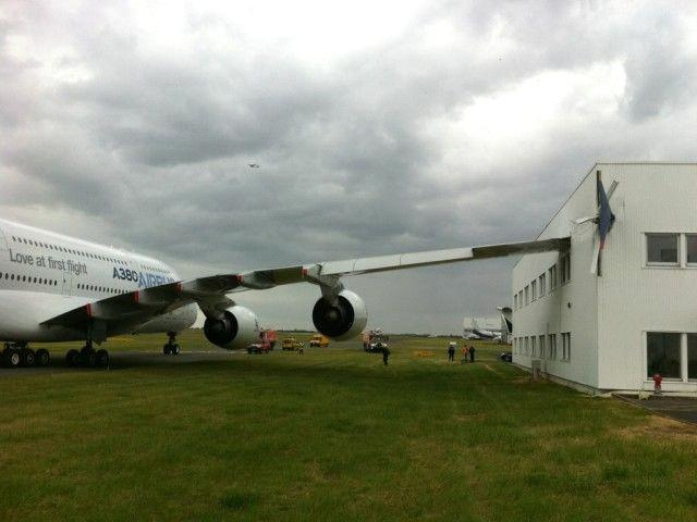

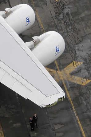

Re: yaw compenastion.
Seems like we are taught differently then, I am a qualified B1 LAME on the A330 and CF6-80E engines. and have been building and maintaining A330's for at least 6 years now.
I can probe deeper for roll and pitch, but when in normal law, the FCPC's and FMGEC's with inputs from the ADIRU's command rudder movements to dampen out unwanted yawing of the aircraft, in this case dutch roll, and turbulence dampening, so there is compensation of some kind, and the notes below show. as to when that begins to work i don't recall/know. I do remember something like 80-100kts the aircraft sytems recognize that as the start of a new flight, and inhibit some maintenance systems .
In the roll axis, there is no trim that the pilot can input. The FCPC's send commands to the aileron servo actuators after reciving data from the ADIRU's to ensure that the aircraft flies level. for that matter, when we change an aileron servo actuator, we rig it to the other servo actuator on the same surface, but we do not "null" or "0" rig the aileron to any position in relation to the wing. the ADIRU data will allow the FCPC's to compensate for the flight control's position so the aircraft flies level. a rig check of the flight controls does happen, but the intervals are quite significant, something in the order of approx every 5-7 years.
It is this automatic compensation that allowed the A380 that lost it's wingtip and just over 2m of its outboard wing at the paris airshow to be flown back home to Toulouse for repairs with nothing more than the damage cleared of the outboard aileron, the structure filled with foam blocks and the whole lot high speed taped over. I saw an Airbus slide pack that was prepared of the incident and the pilots reported that they noted no difference at all to the way the aircraft flew. The FCPC's again with data from the ADIRU's compensated to make sure the aircraft flew straight and level.
dave

Hi Dave,
I agree with everything you have posted above, except we are talking about 2 different things here.
The previous comment you made was in relation to automatic rudder input, in the event of an engine failure on takeoff. We DON'T have that feature on the A330.
We, as you mention above do have rudder dampening, but that is to cater for Atmosphere turbulence.
It's only active under the following conditions:
1. Aircraft is in flight
2. Aircraft speed is greater than 200kts
3. AP Engaged and normal law is active
4. A/C is within the normal flight envelope.
I'm sure that beast of a machine (A380) has it though. I love those photo's you posted above of the wingtip in the building. I do however, feel sorry for the pilots.
I'm sure they had tea and biccies with the boss the following day!!!!
Have a great evening
Mort

but i was also responding to your comments that there were no compensations at all. I was sure we were told that the aircraft would compensate for an engine out senario. try it out next time your in the sim?
Re: rudder dampening in normal flight modes, my understanding was that the load alleviation system (damn it, cant remember the acronym, I'm delving way to far into your neck of the woods) and the yaw/turbulence dampening was always working regardless of the AP being engaged or not because they are one of the normal law envelope protections?. in the text there it states if you have a ADIRU failure there is a backup dutch roll dampening system so that there is still some rudder compensation and the aircraft would have to be in alternate or direct law without ADIRU's. Turn coordination would also have to cover AP disengaged modes of flt as well? either way, I only remember these things because I found them interesting, not because we need to know it to do our jobs.
Hyd pressures and T/R actuation, different story
I really feel for those A380 pilots.... for sure their flight suits would have felt pretty warm after that incident. but then again, maybe it the tower was at fault for sending them down that taxiway?? don't know. I can't imagine it being super detrimental to them though being test pilots and all.
One of the last KC-30A tankers we converted had Airbus military test pilots fly it back to Europe for the final paintwork to be completed. When I got talking to one of the pilots. he had punched out of a Eurofighter twice! the last one was the one were a Saudi officer was killed in the crash and a whole heap of please explains started happening. He still had a job.
dave
