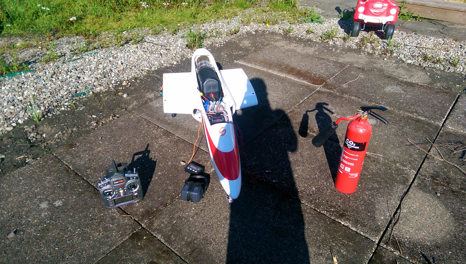

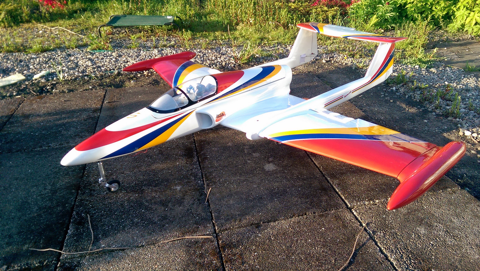

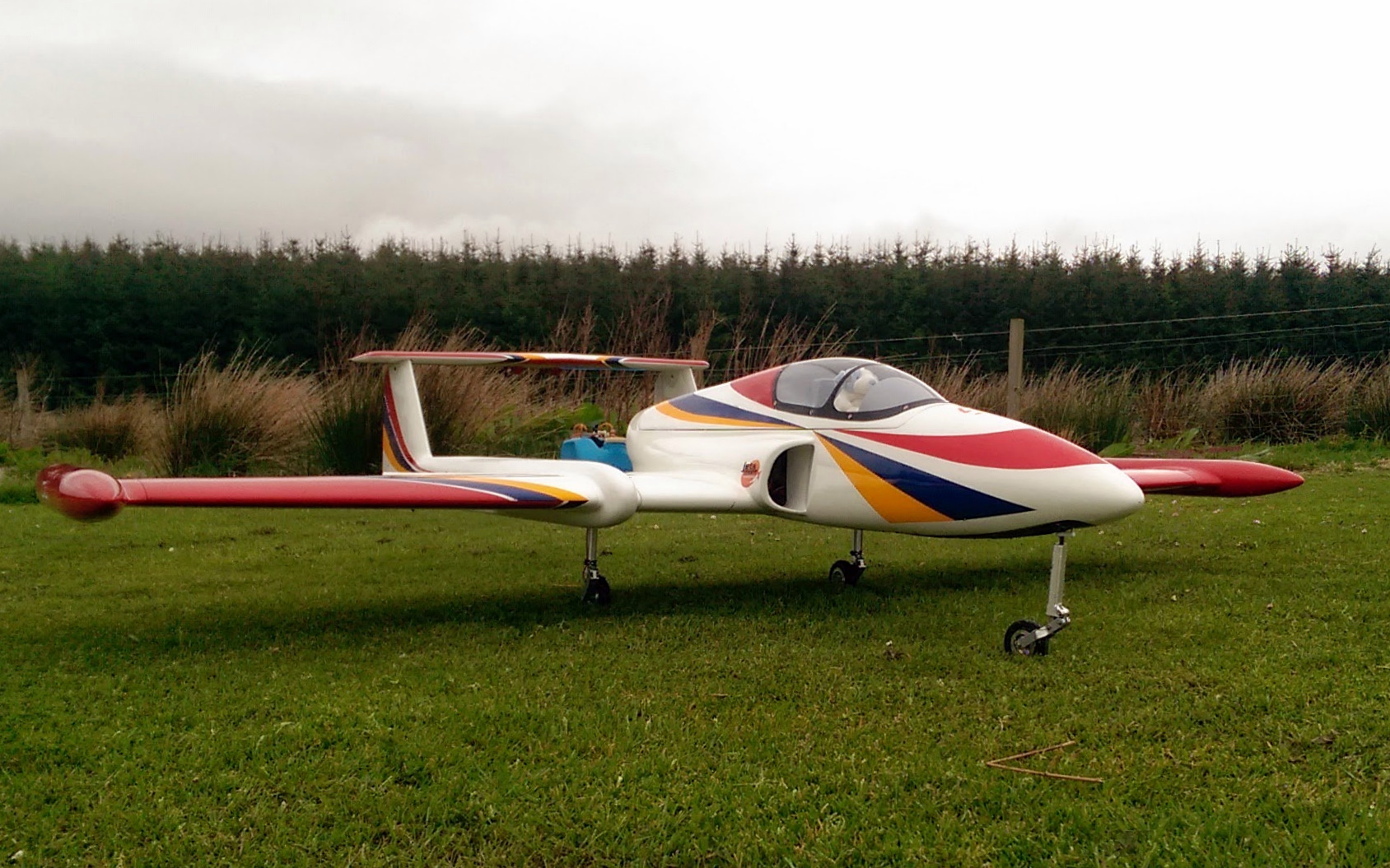

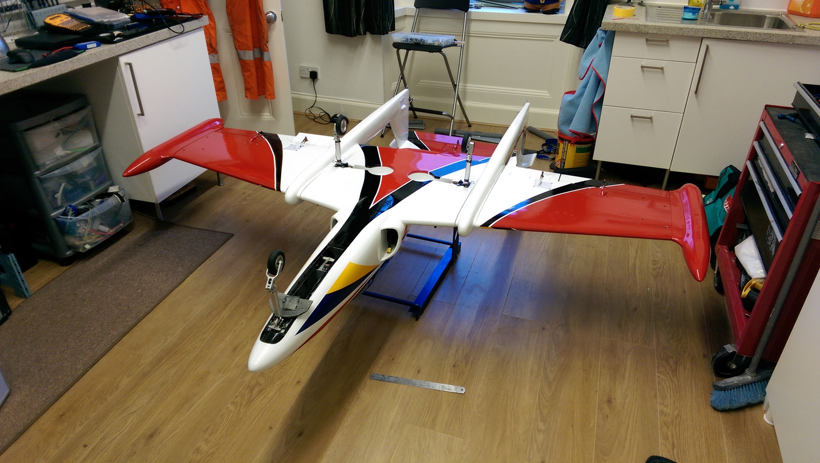

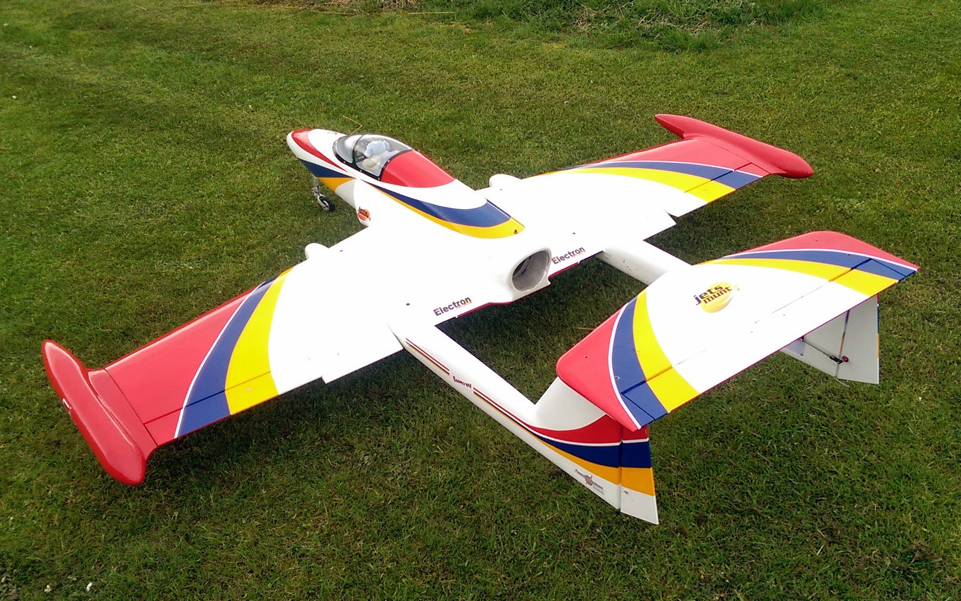

Done, just a few cables to tidy up a CAT to install when I receive it and the airframe to balance properly.
Turbine started first time but then again I'd be worried if it didn't
I'm guessing it'll be need 200-300 grams of lead needed sticking some of my daughters play dough on the nose
Not sure if I have enough?

You may find you need more than that, I had to add 670 grams (1.48 lbs) of lead shot to the nose in mine; however, that being said I did glass & paint the horizontal stab and the wings which could have been a contributing factor to making it a bit tail heavy .
http://www.rcuniverse.com/forum/rc-j...thread-11.html
Attached is a layout for the balance fixture I made for mine, they slip in between the fuselage and the booms.

Are you balancing with the hatch and wings on, 1/4 inch behind front spar?
Old 05-13-2014 | 06:13 PM
  #31
RCISFUN's Avatar
My Feedback: (44)
Posts: 6,929
Received 34 Likes on 30 Posts
From: Erie, PA
Yes it was all fitted up with booms, horz stab, wings, canopy and a full UAT.
Balance was on the center of spar, see post 268

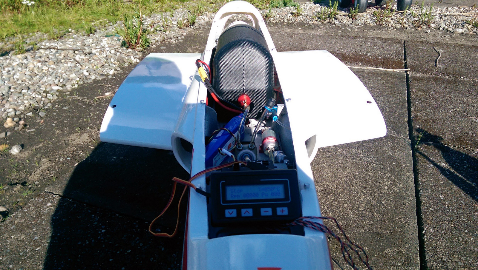

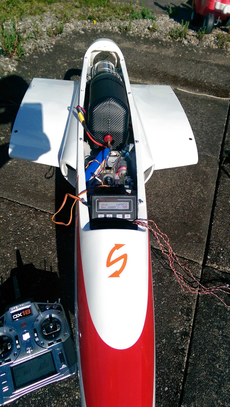

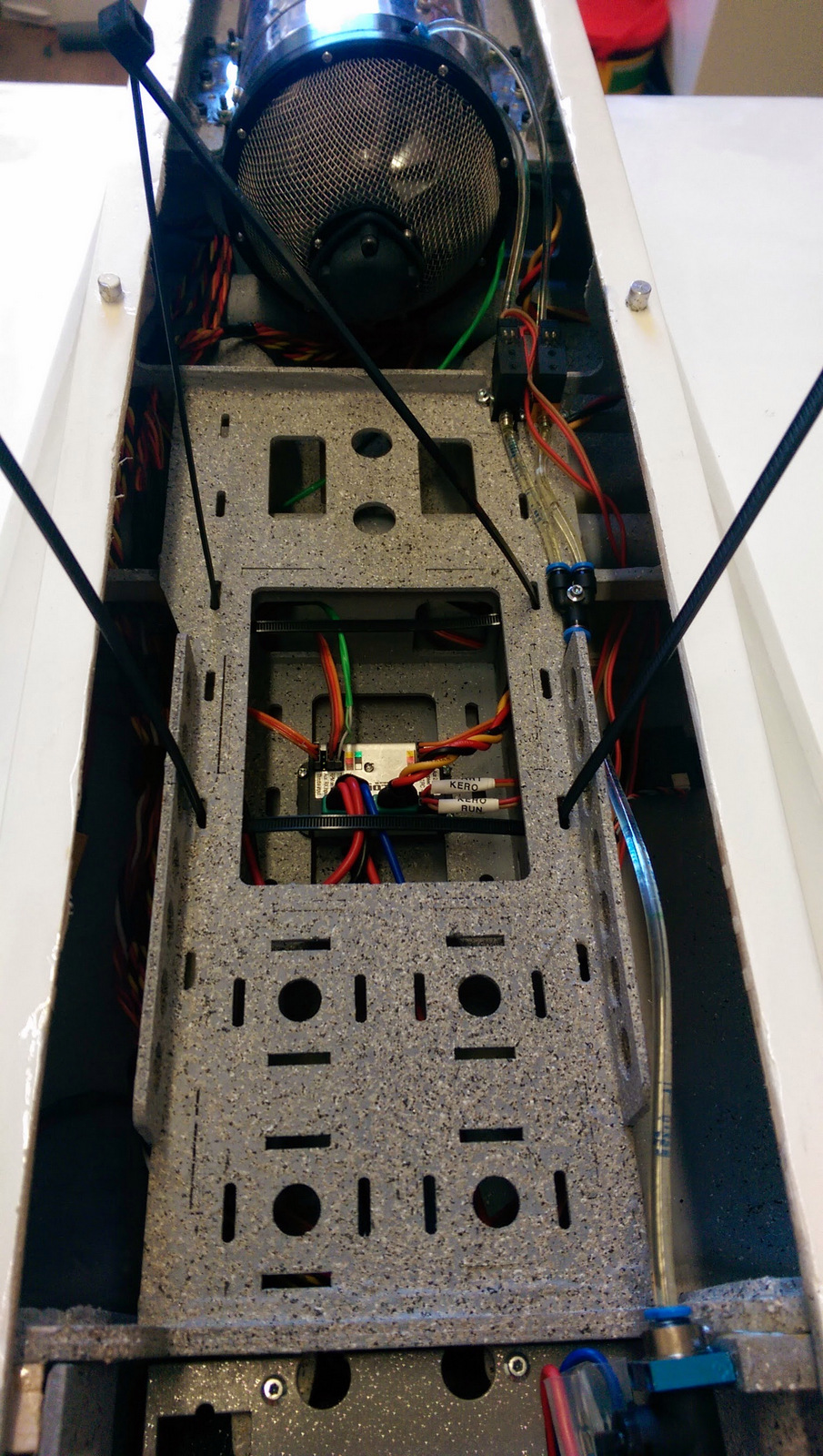

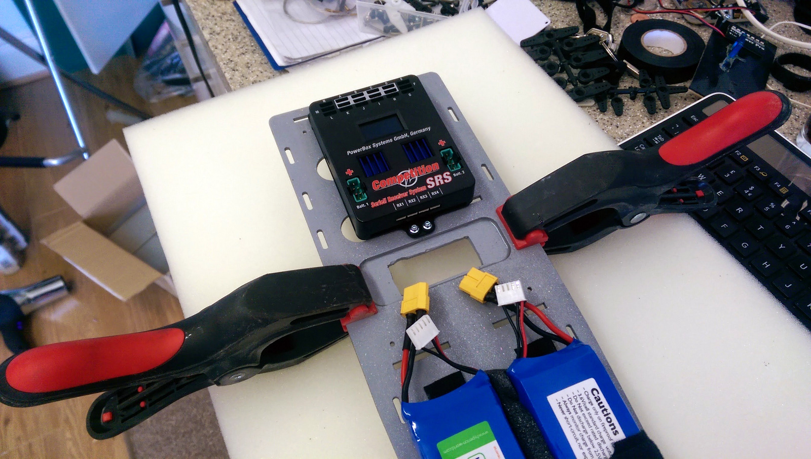

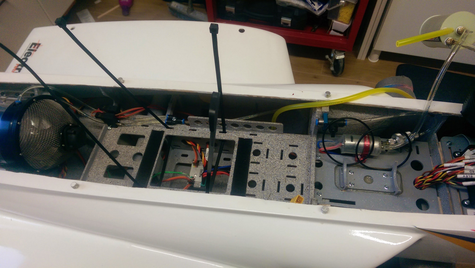

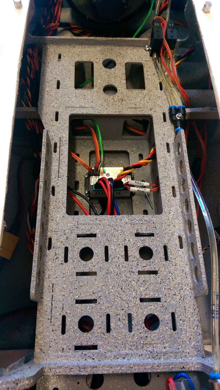

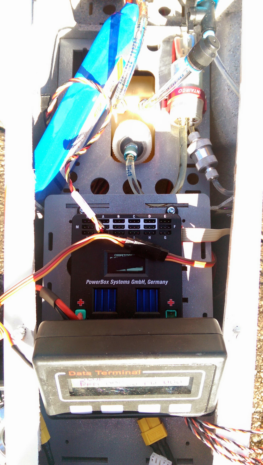

Final equipment install pics - still to balance.
The UAT is going to be replaced with a CAT and a maglock vent from gbrjets installed when i receive them.
To balance i've had to add 400grams or 14ozs. I'll probably be removing some as its a bit conservative at the moment.

Cool.... I see you have lead sitting behind your nose wheel, you could lessen it a bit if you stand it on its nose and pour lead shoot directly into the nose and secure with epoxy
Old 05-16-2014 | 01:09 PM
  #37
Colin_Mc's Avatar
Joined: Feb 2006
Posts: 203
From: Scotland
Originally Posted by Si_B
What balancer are you using there?
EZ Balancer
http://www.ezbalancer.com/
Bought and imported via:
http://www.dreamworksrc.com/catalog/Ez-Balancer-Ii
My one is a few years old and is anodized - much better now that they are powder coated.

There is a hatch directly under the retract which is where it is now, once i have an idea the final CG I'll do your method, sounds much cooler.

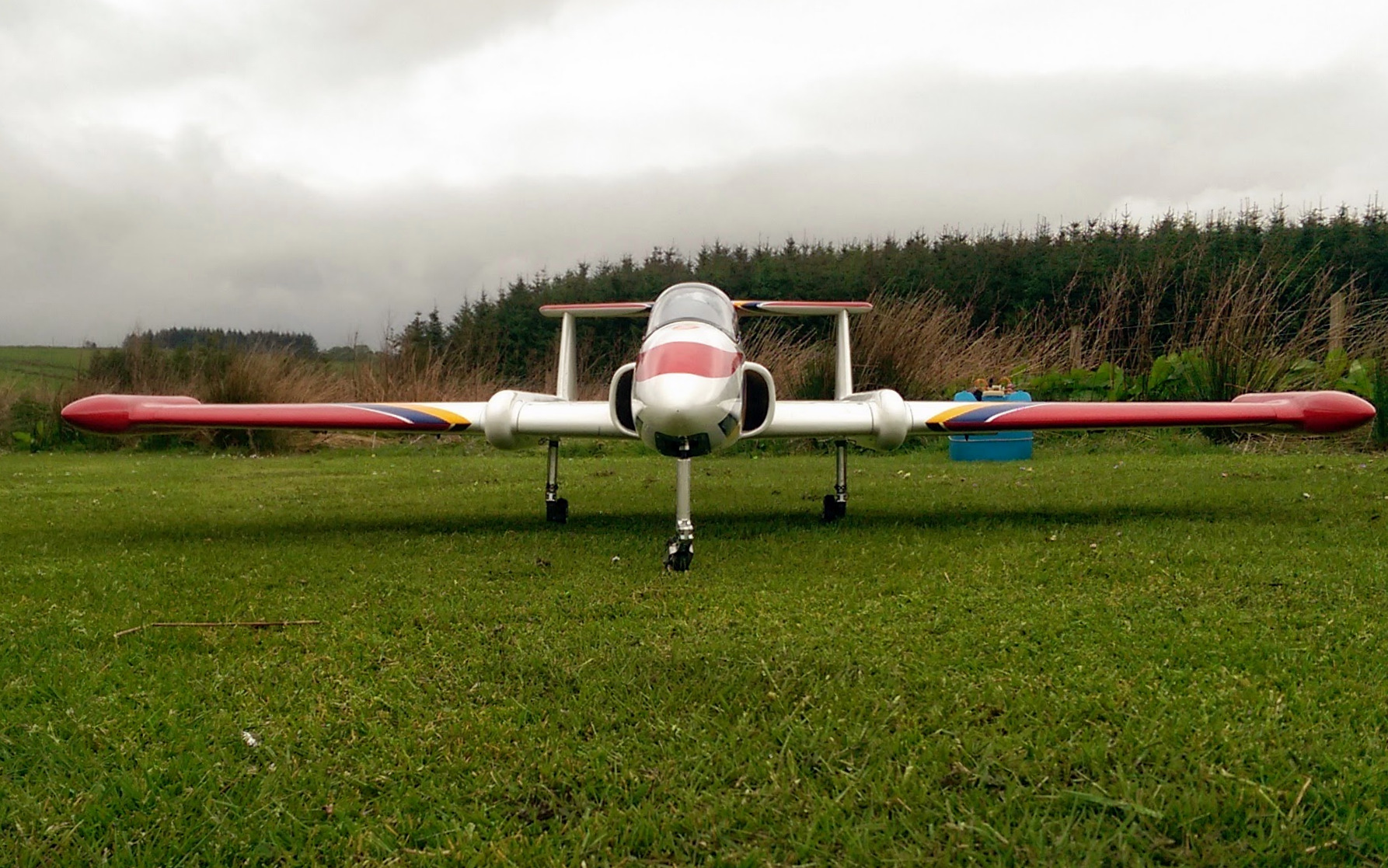

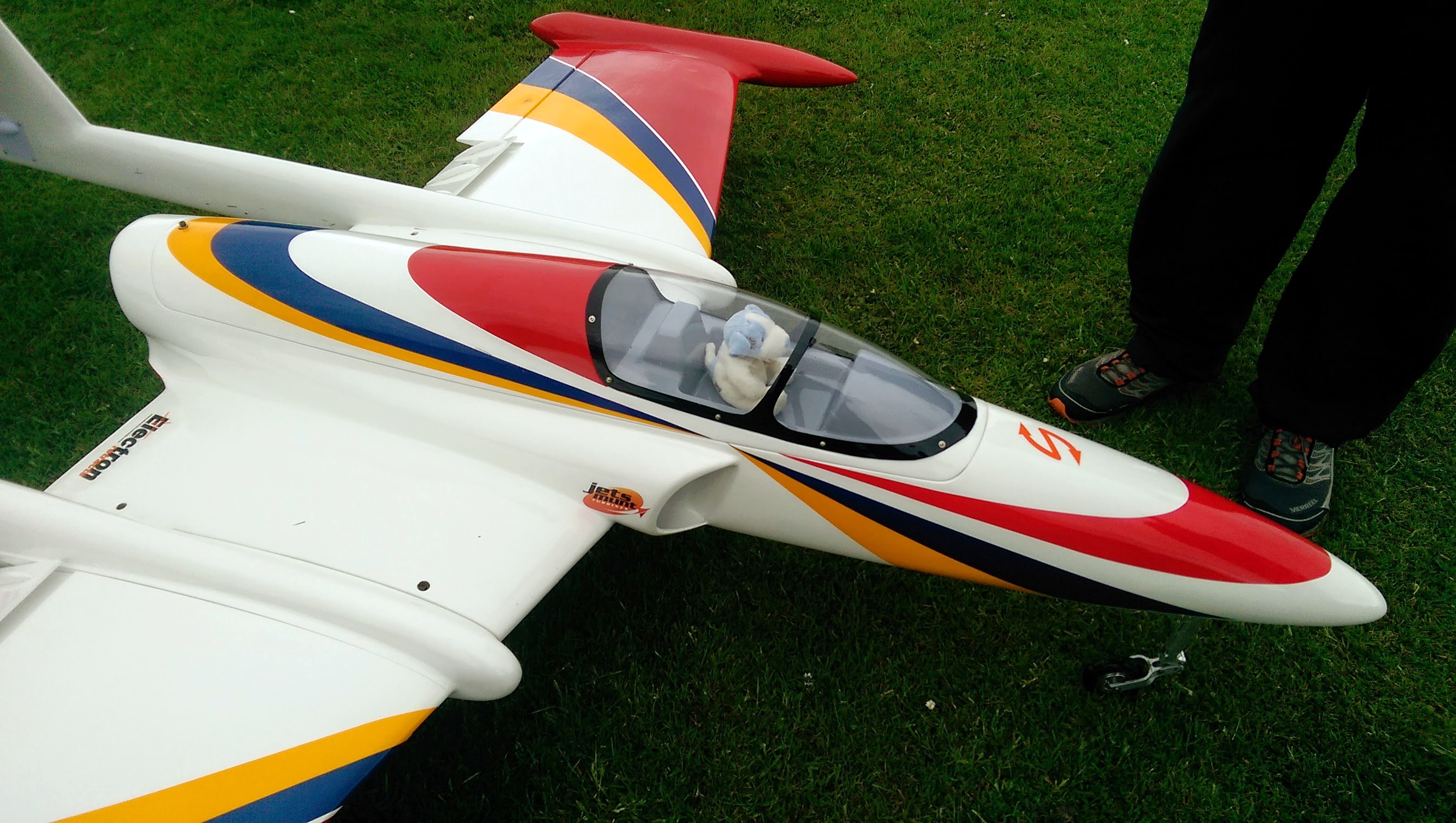

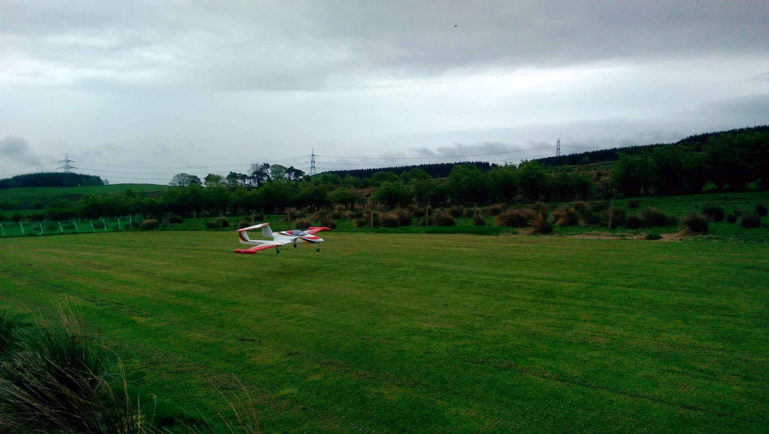

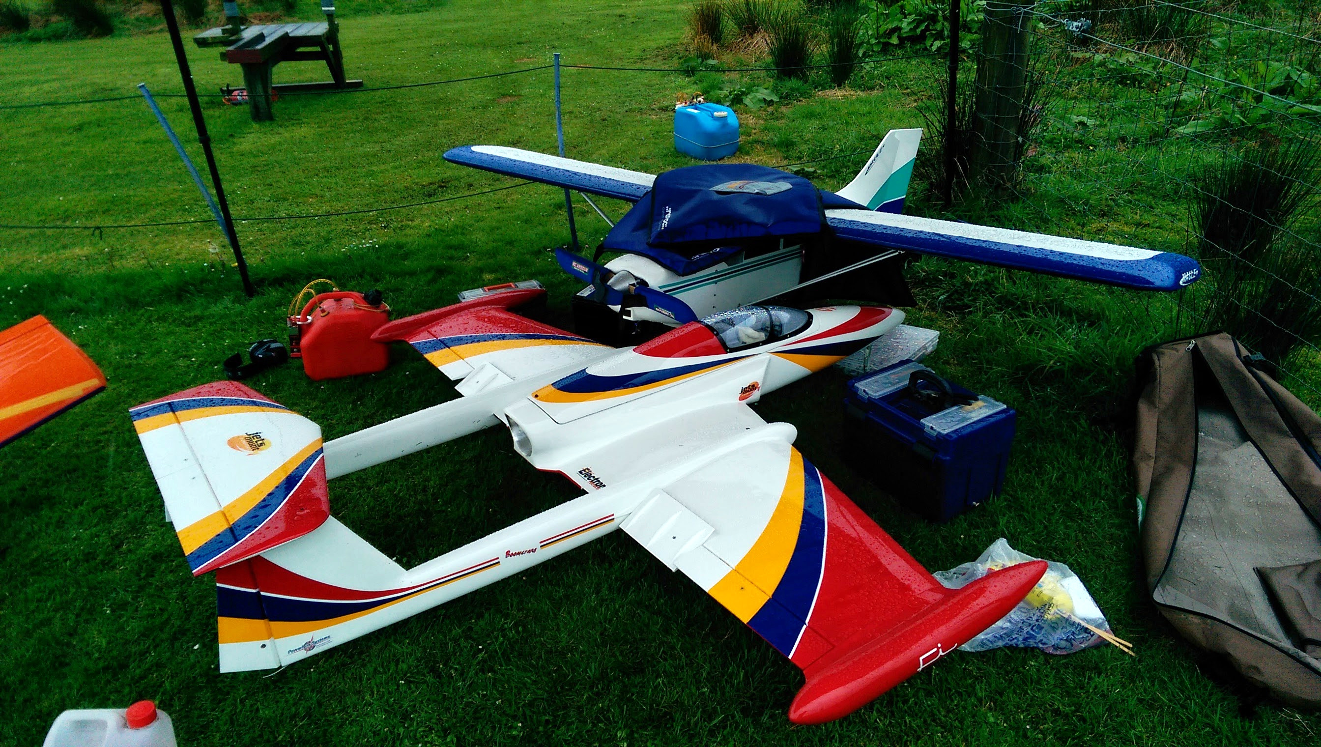

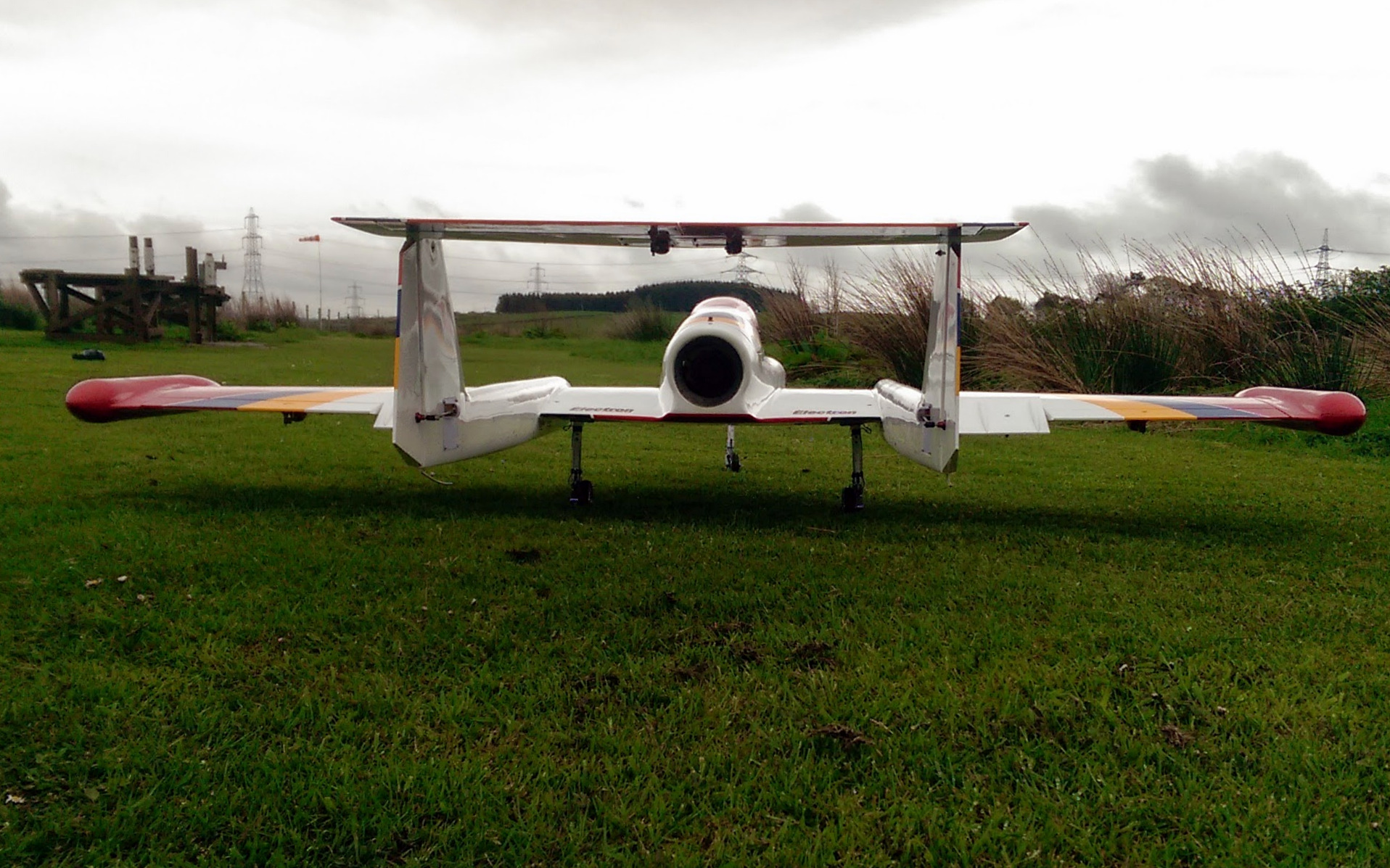

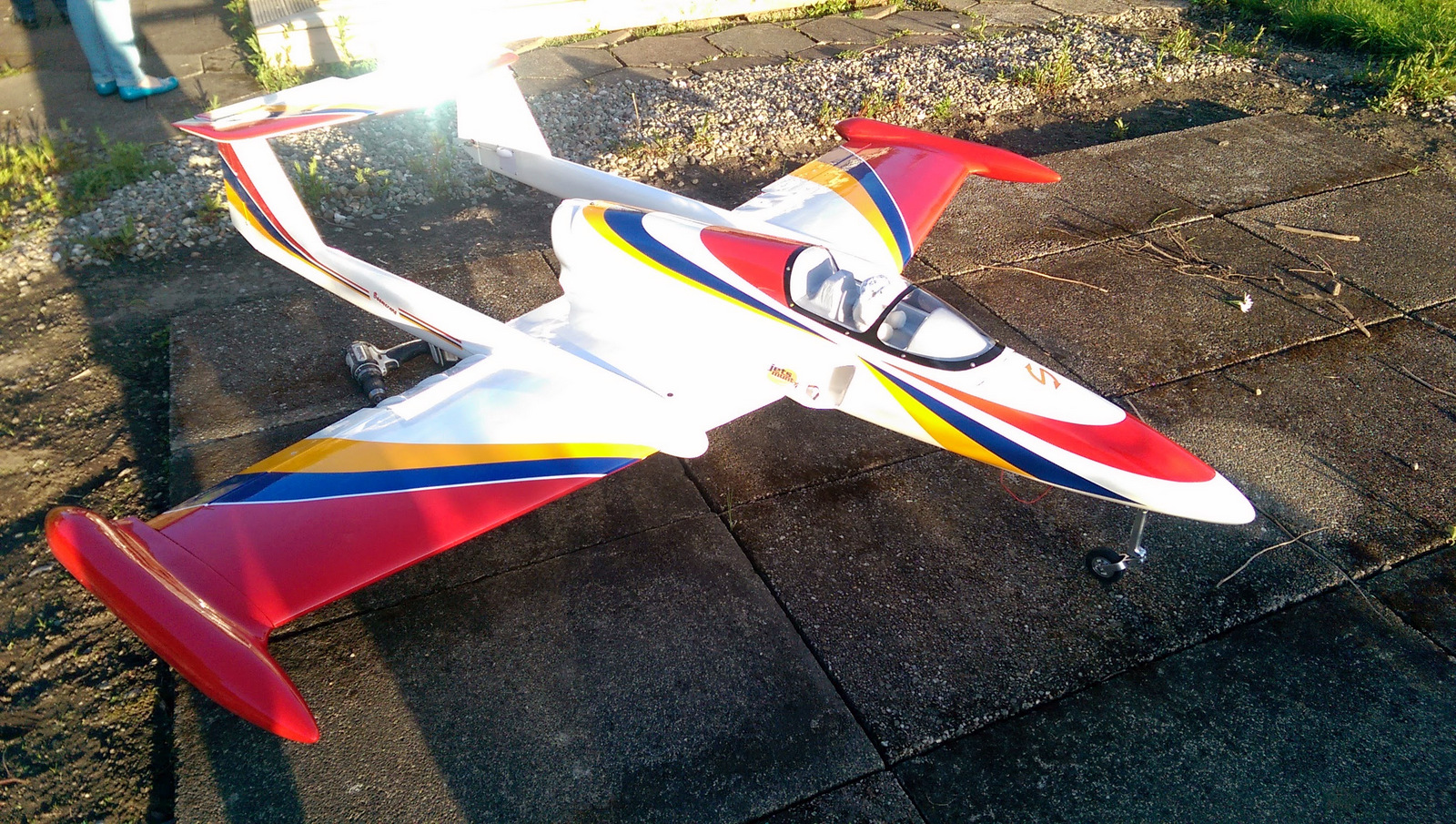

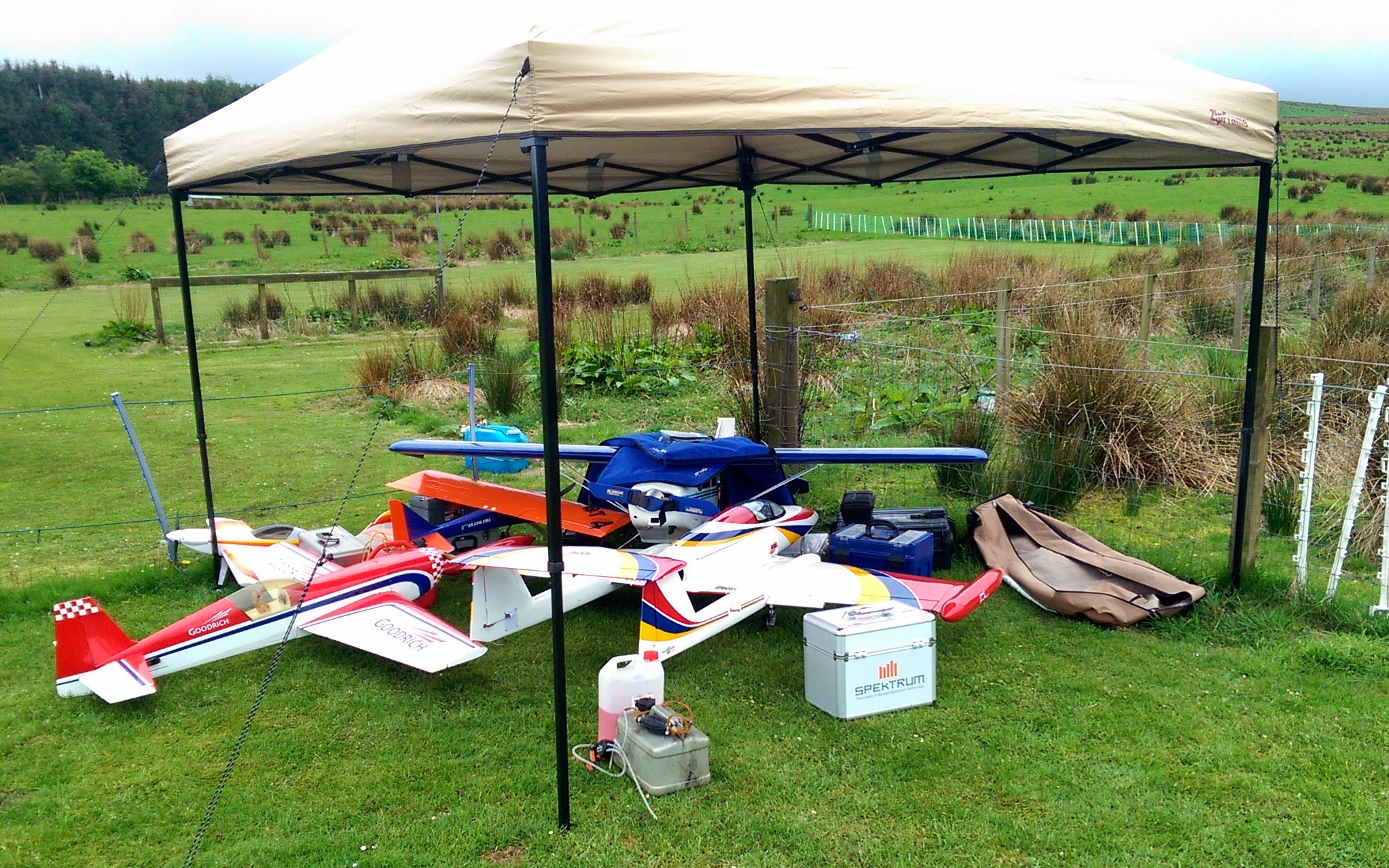

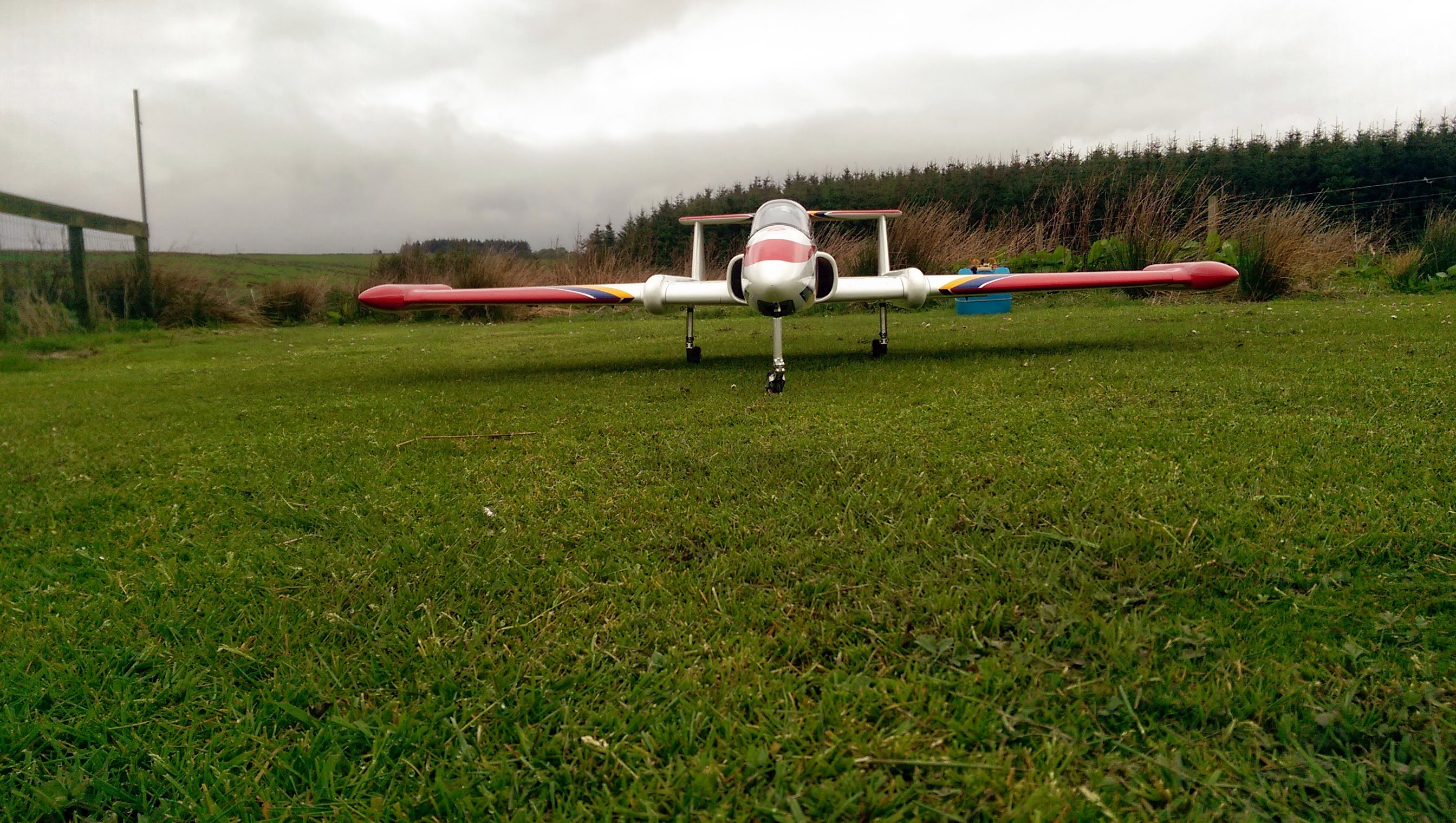

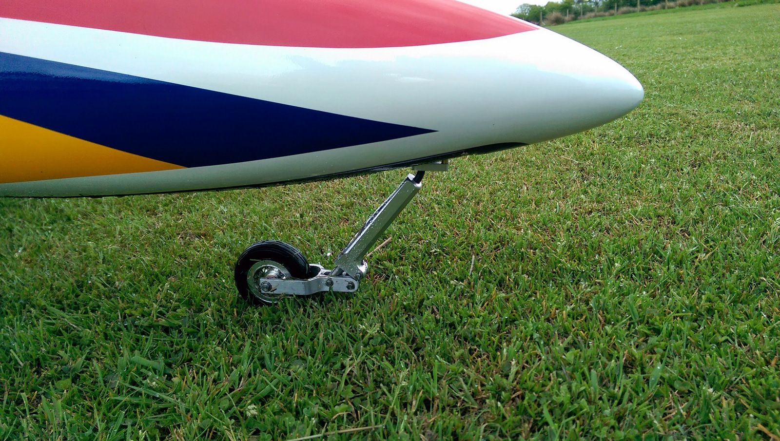

Happy day today, maidened the plane and only one minor problem with a soft nosewheel pin which bent under the initial landing.
Video to follow....
Fun with quadcopter too when it started chucking it down....

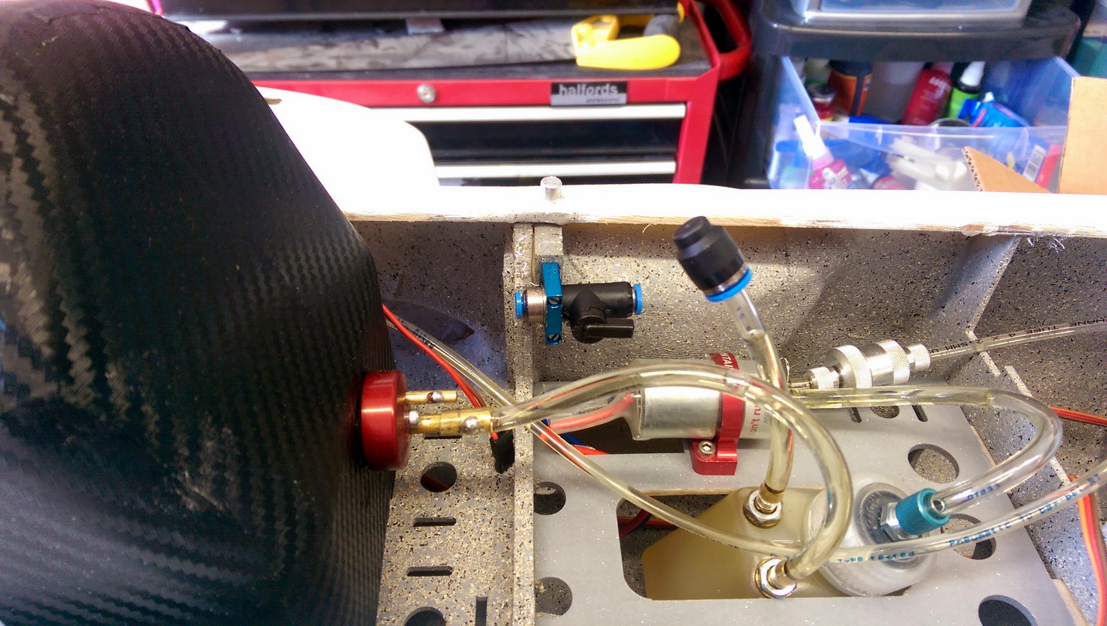

GBRJet CAT & Maglok vent installed - both very,very well made.
