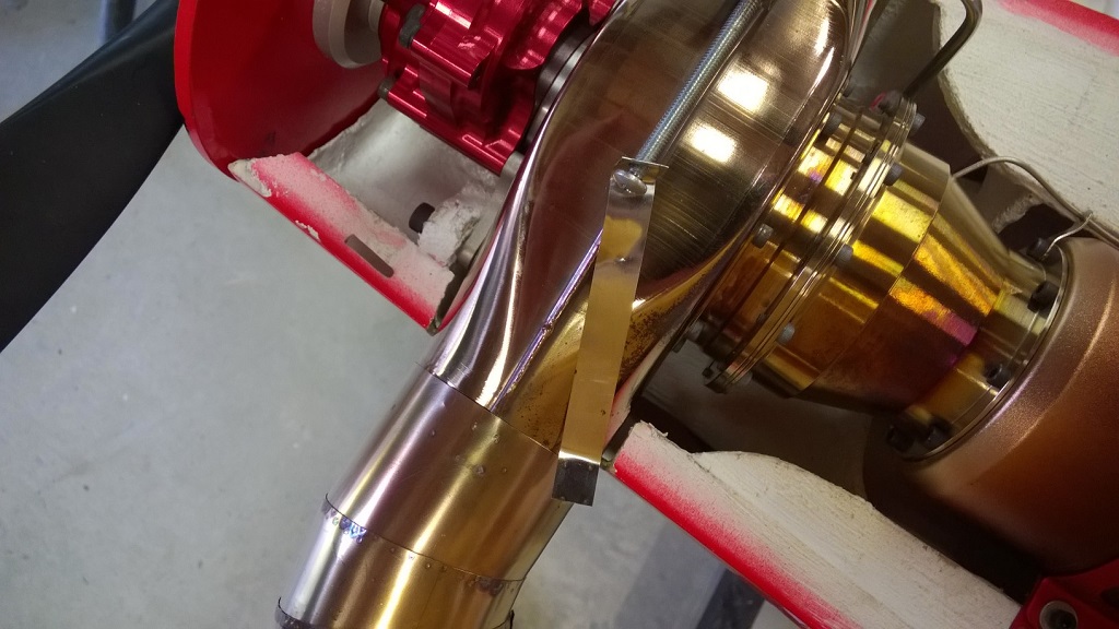

Yesterday I took the PC-21 to the field to run the turboprop, range test, taxi test, and maiden if everything went well. Unfortunately, the tack welds on one of the exhaust hold down straps broke during the range test so I didn't want to take a chance and maiden it like that.
I sent a message to Danny from Chief Aircraft (place where I purchased the PC-21) to see about getting the exhaust replaced under warranty but haven't heard back yet.

Just talked to Danny and he's going to work with Anton to replace the exhaust stacks.

Hi Kirk
Just drill and run a 2mm screw and bold on both sides.
B

I don't think that would work. The exhaust stacks slide over the turboprop's exhaust openings and it is a very tight fit.

Hi Kirk
It was cuased by viberation during the test.Please send your address details to our mail [email protected]
Anton will send the exhuaust part to you by airmail.
John
