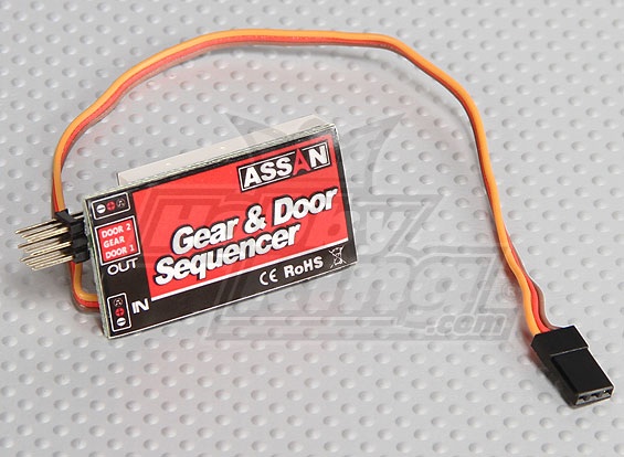

I'm using one from hobbyking for $12 works perfect with digital servos and have multiple settings and servo throws ,made by assan.

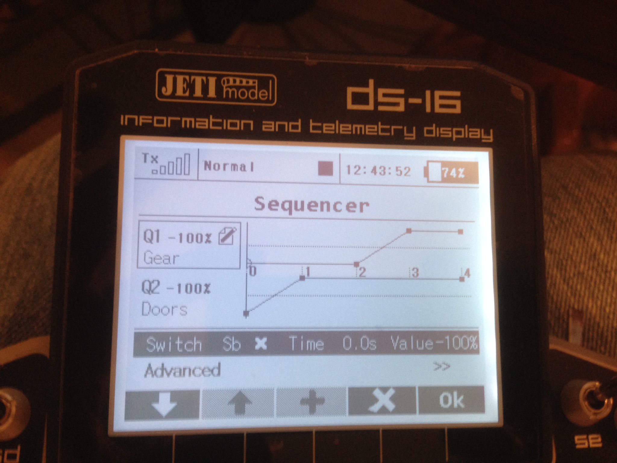

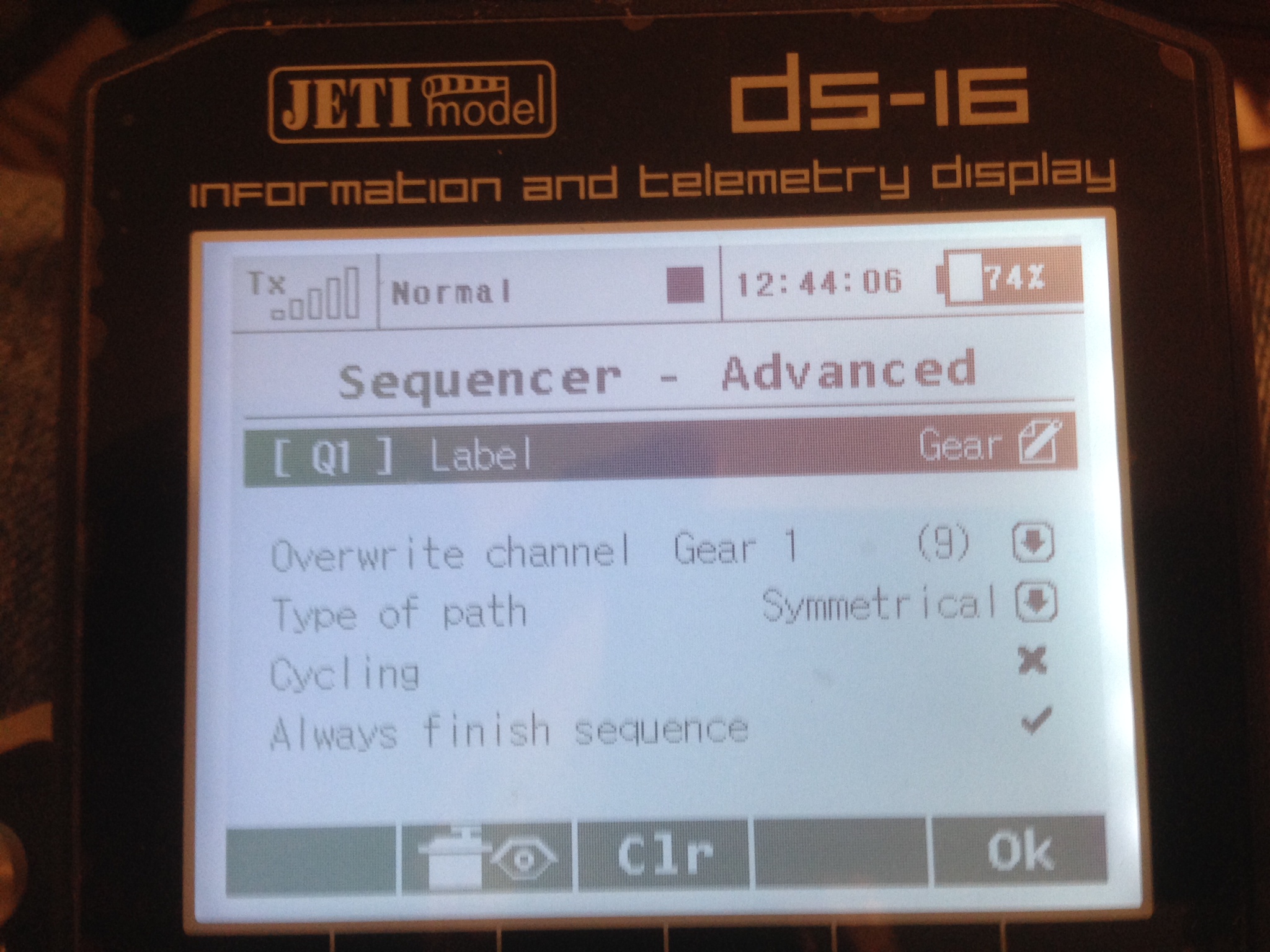

I haven't seen a video on using the sequencer but I'm sure there must be one out there somewhere. I simply started looking over the controls, etc andwas able to get it working pretty quickly. Some of this stuff doesn't seem too user friendly at first but once you get it working correctly it usually makes perfect sense.
I've attached a couple of photos of the sequencer I use on my Skymaster/Xtreme-Jets Dragon. It's a very basic setup, open doors, extend gear / raise gear, close doors operation..
Hopefully this will make things more clear.
