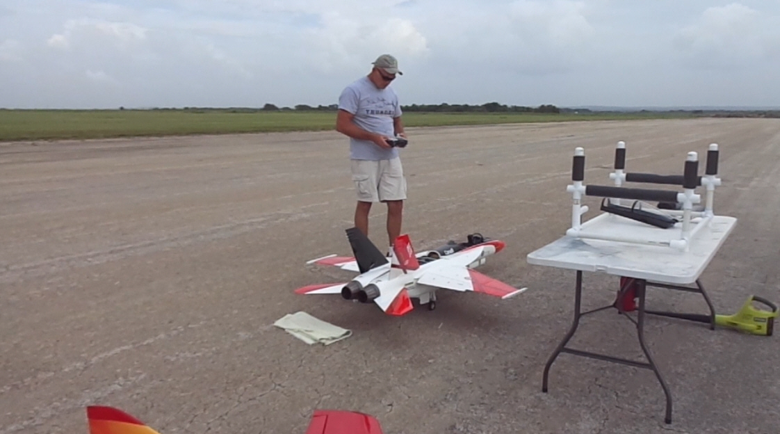

Got 2 more flight on the F-18F this afternoon. I'm really loving this thing, I feel very comfortable already! I increased the flaps to 75mm with more up trim mixed in and I hit the sweet spot! Works great, I love the slow flight now, just what it needed, I'm also using spoilers for landing. On the second flight I did a nose high landing approach and was at full up elevator at touchdown! I used brakes and was at a stop in about 50ft! lol! Short field, no problem! The slow flight it awesome, even did a tail hook pass. Some was caught on video, I will see what I have and make a short clip.
What I like most right now is at half throttle you can turn and bank and not touch the throttle, very nice.
Anyway here are some pictures of the day with my friend Bob and his own design speed demon!

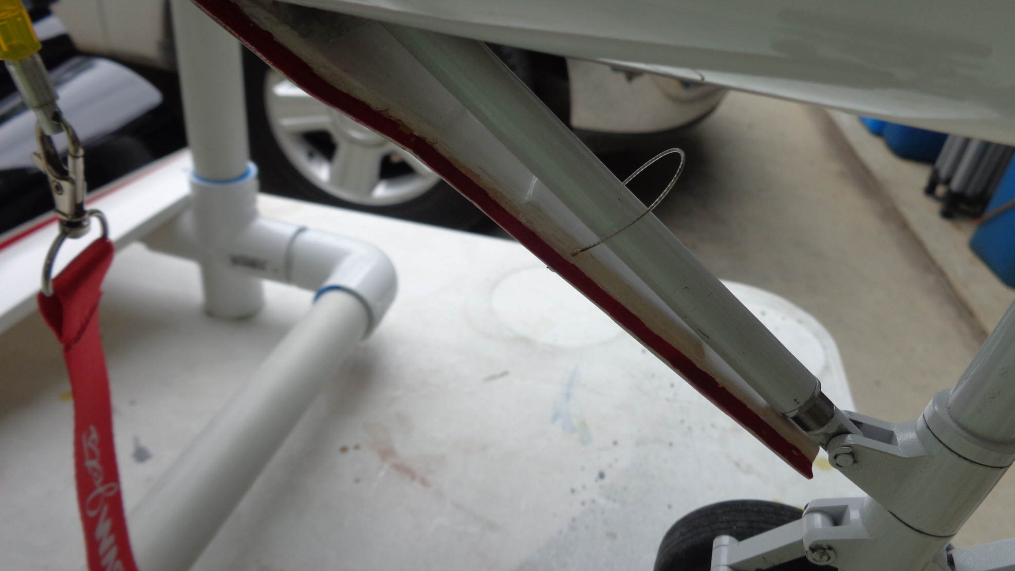

One little item that needs attention is the rear nose gear door. I see lots of solutions to this door staying open in flight, some are overdone, or could look better lets say.
I used a small piece of plastic coated cable, tied a knot in one end and drilled two small holes through the door. Just loop it around the strut and out the other hole, then retract the gear.
I then pulled it tight and marked the wire where it was in the retracted position. Then when you extend the gear you have plenty of slack to tie another knot. Then just heat the plastic and it will melt and hold
the knot, I added a little CA also. No one even notices it and from 5ft away you can't see it.
