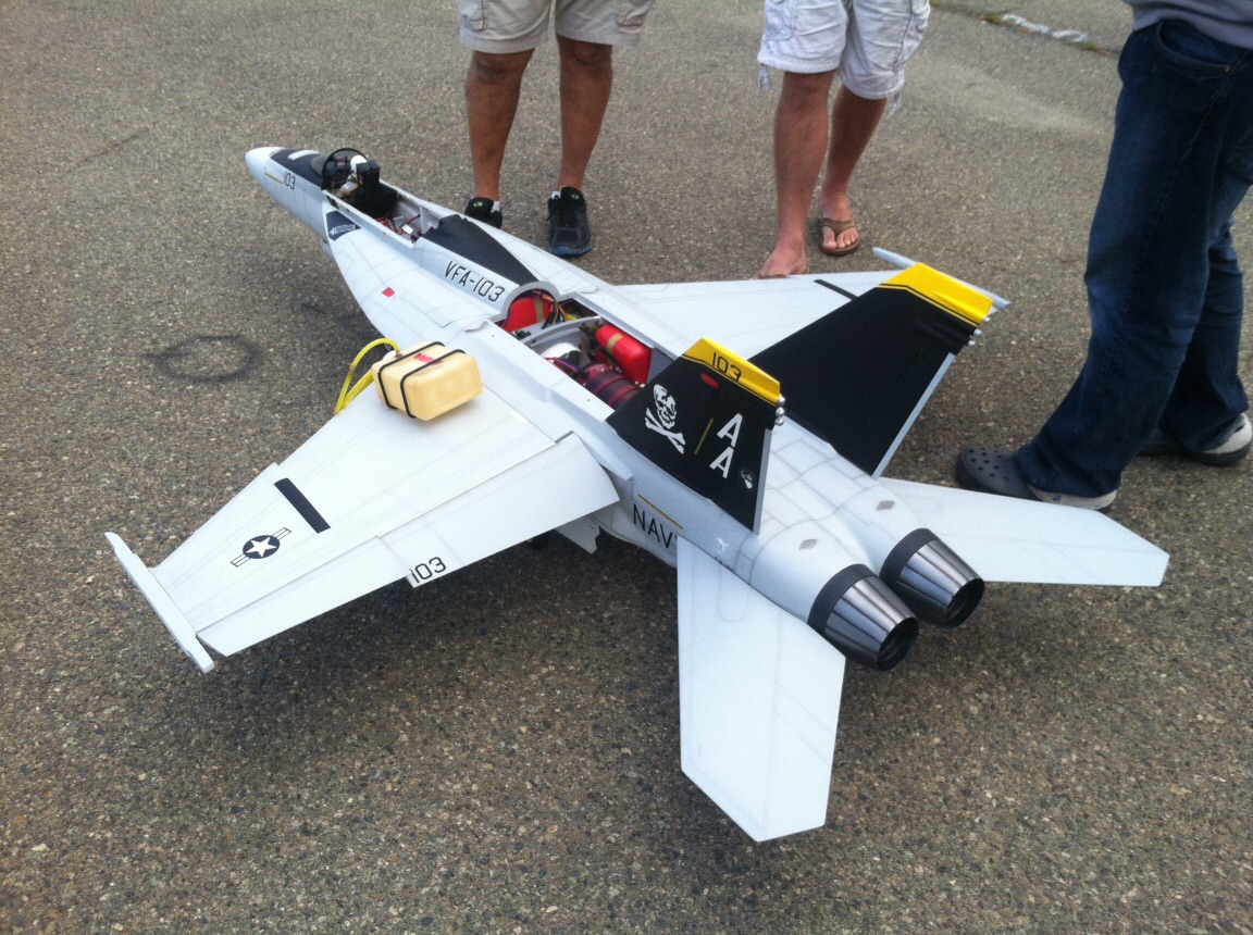

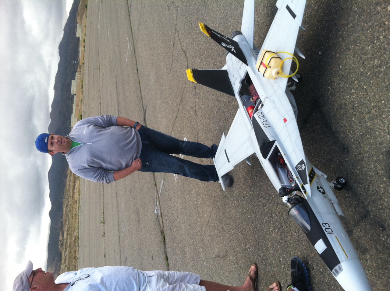

Well it was a no go today... Dark sky's and a pretty decent crosswind... Probably the like have been fine but I wasn't feeling it... I did get to run the turbine up a couple times and do some range check work. The 210 is a freaking monster, thought it was going to push me over!!! Her is a couple pics hope to get it in the air soon but of course the one weekend I'm ready it's storming in San Diego...........

Know the feeling, it has been raining everyday here in Texas, I don't think we will have a summer this year.
Looking good though man, you got a little closer! Is that the Camp Pendleton flying site? On your Kingtech are you running diesel and Kingtech oil?
Here is some inspiration! Looks like he used very little flap for takeoff.

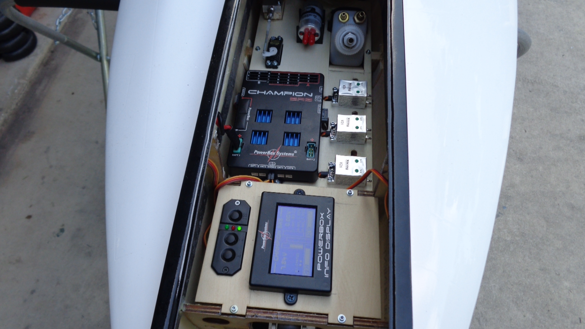

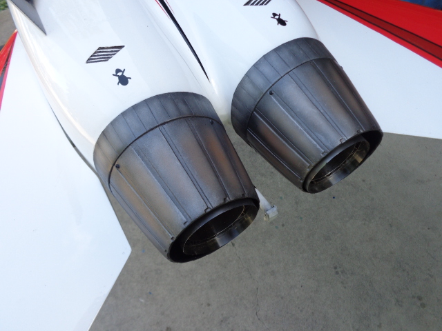

Bri, I'm going to be running diesel and Kingtech oil also, but I see they changed the mixing ratio to one quart to 5 gallons of diesel, same as kero. But diesel is still way cheaper and it has more power.
I have been tinkering with my F-18, not much flying weather this year, winter was bad and now it won't stop raining and the wind is 15 to 20 most of the time. It's almost June and I have not even been in my pool yet this year!
I wonder if Damo260 got his tailhook installed? Here is where I installed the servo, just a mini servo with a control rod from a micro flyer, works good. You can get at the servo from the wheel well.
I also finished my exhaust cones, you can see that I added an extra panel line to the first ring:
I'm almost done with the rest of the equipment install in the nose section, so won't be long!
Luke

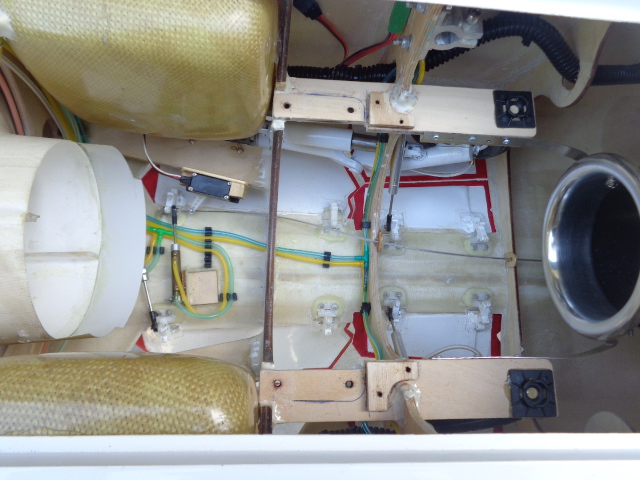

Got all the plumbing basically done for the gear, brakes and speed brake. I did a test install of all my components under the cockpit prior to painting and finishing the mounting boards. Fuel filter, shutoff valve and air fill valves with associated gauges will all be under the engine hatch.
