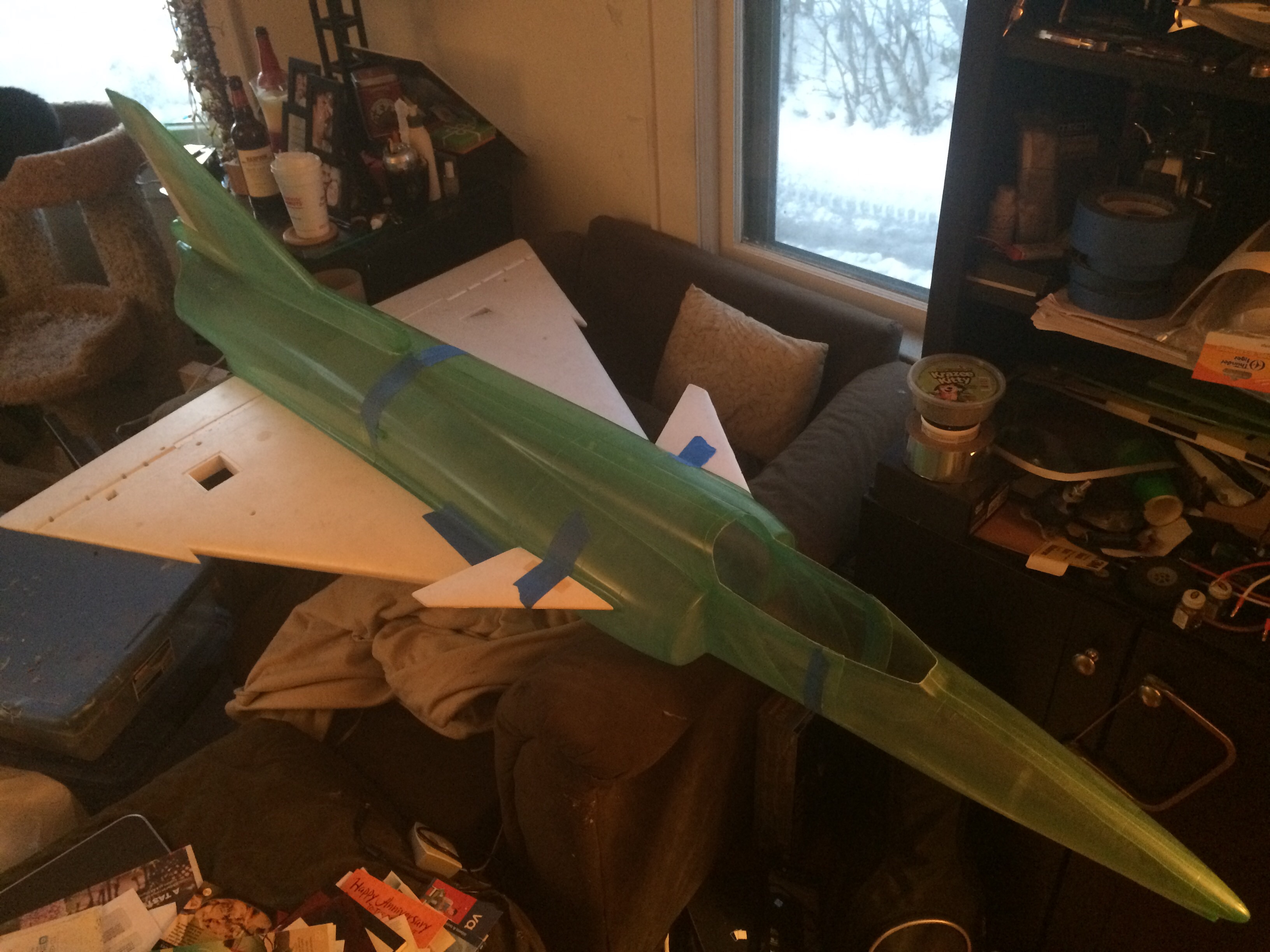

Anyone here fly one of these before? From my experience deltas fly great. Looks like the Byron has a pretty fat wing on it. I unboxed mine to get a feel for the size.

Byron's were really designed to fly on the old power systems of the 80s. Explains the thicker airfoil. So it will have pretty good low speed performance but all deltas can be prone to hi speed stalls if you are into yanking and banking. Wouldnt mind one myself to go along with the F18, F15 and my T33
